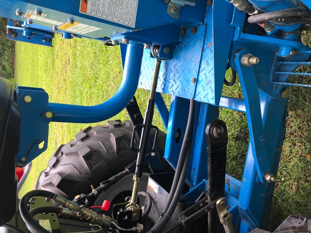

Well now, YET another up date on our XG3025H..............it's home.
Derrick from Trenton Farm Equipment in greater down town Trenton, Florida, arrived this AM w/ his Chief Tech Guy, Sebastian.
Went over the new additions.
Must say the additions are most impressive. All the attachments were put back in place.
Yes, it runs great.
There was a call from Terry the LS Service Rep guy in the Carolinas, he suggested we use it & be sure we are pleased w/ everything.
Something interesting was brought to our attention. There was a part missing. Seems our selling dealer left off the top mounted turn buckle.
It anchors the back of the tractor to the anchor point under the seat on the back hoe. We never knew this.
We were given this part as something for the box blade & the other rear mounted implements. Not even suggested to use it on the back hoe.
It was suggested this addition should better stabilize the back hoe attachment.
Is everyone else using this top turn buckle ?

Yes, you need to install the top link when using the subframe backhoe.

I assume you are talking about the XJ2025 with the lb1104 hoe... but there are more options for buckets then 9"... I got a 12" with mine.
The top link most likely keeps the hoe from loosening up at the lower 8 bolts that hold it to the sub-frame. This happens to the XJ when after heavily using the hoe for a several hours and a link like that would limit any type of movement to start.

Thanks for addition & correction.
You're most right about those bolts coming loose. It's an on going issue w/ our tractor as well.
We're looking forward to having this upper link do its designed task.
We have had a lot of rain following our tractors return. Today was our first real test of the new rigging.

Big Blue Florida thanks for posting that photo of how the top link is attached to your tractor/backhoe. After looking at the photo I went through my LB1100 Backhoe Operators Manual again and there is no mention of the top link & the illustrations do not show it at all. Hopefully my tractor will be back tomorrow or Saturday and I can see if it has the top link attached. You have mentioned that you have photos of "stump removal" any chance you can post some pictures? Thanks
