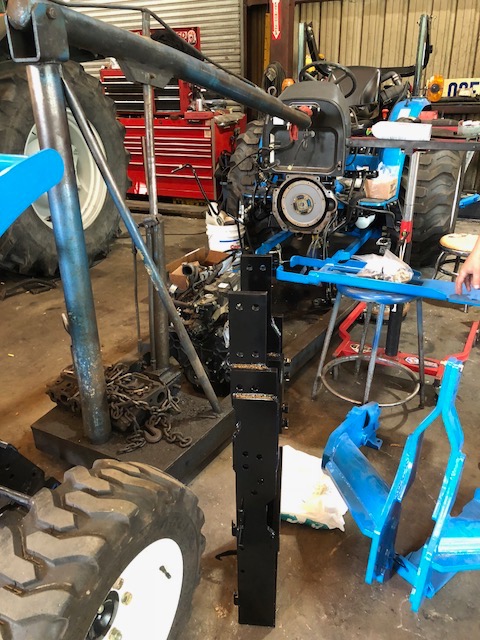

An update on our now in the shop, in two major parts, XG3025H, 2016.
We drove over to Trenton, FL, our now LS dealer. This was to put eyes on the progress.
This first pix is of the back half of the LS & the front part is marked by its left front wheel.
Standing tall & shiny black is the new replacement frame & next to that is the new blue FEL mounts bolted together fresh out of the shipping crate.
Behind all that is the rear half of the tractor. Motor is just sitting on the deck. Will show a better angle of the black frame in another pix. IMG_0097.jpg
Hope this better shows the new frame.
This third & fourth pix should show the addition of the highly reenforced frame section
/ XG3025 Recall #72
This is a new addition to the tractor.
It's called the Motor Subframe. It is very thick plate & could be nearly called a protection skid plate, for two locations down under.
Another pix of the triple flat bar used & the cross member. This is the super beefed up area.
Old frame, note cross member area.

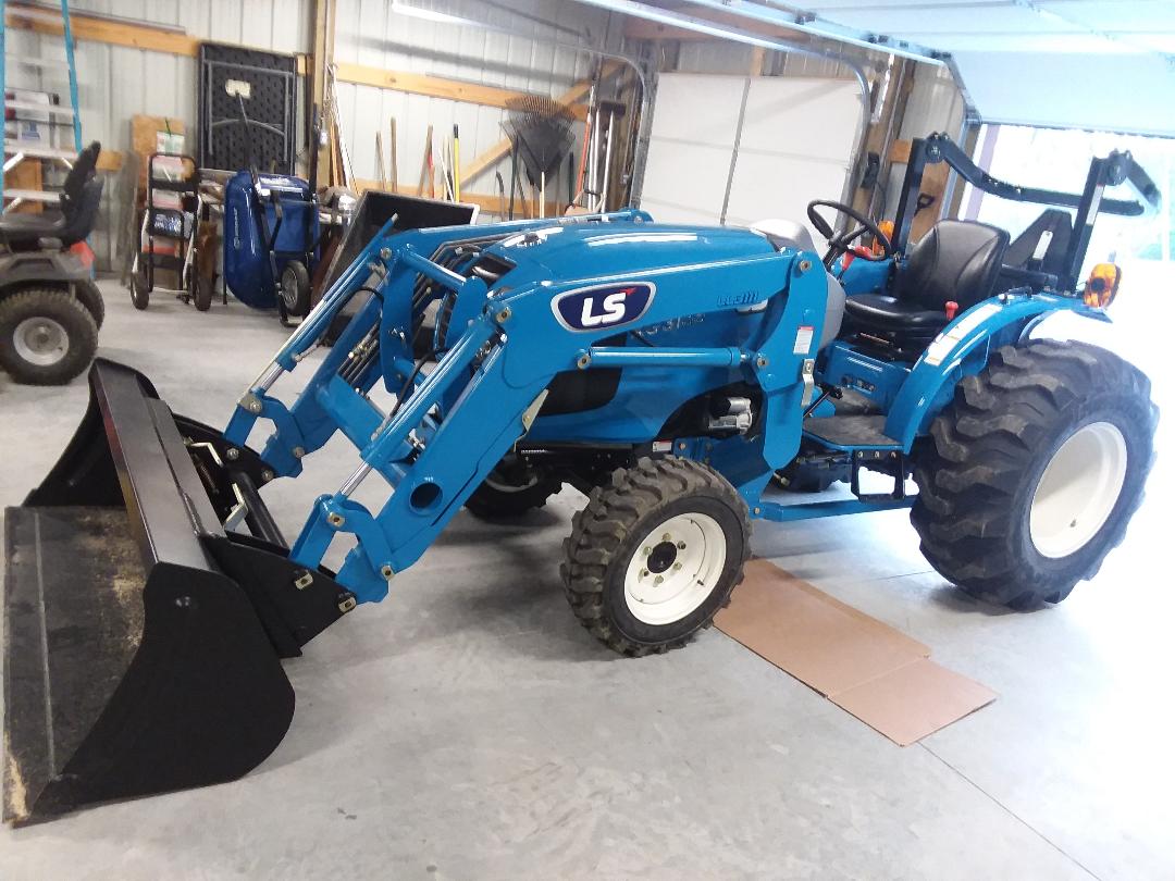

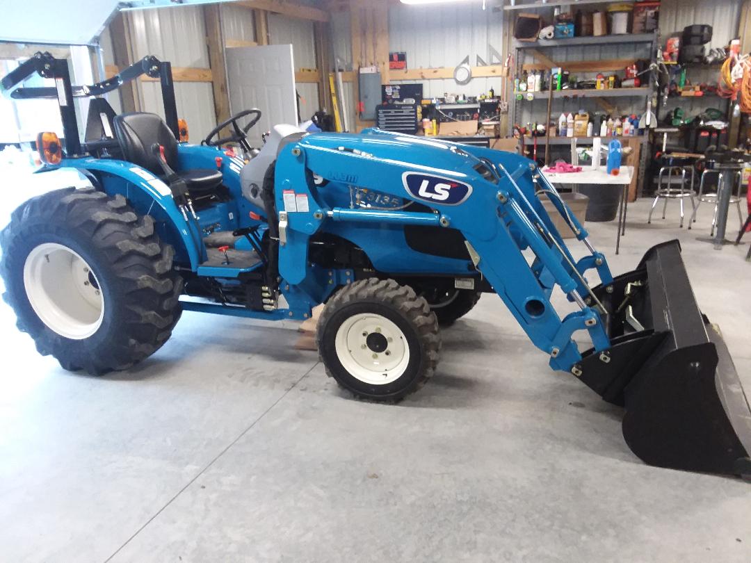

Here is my new XG3135.
/ XG3025 Recall #77
That doesn't appear to be much larger.
Are those front tires a bit shorter than the 3025 or it it that the back tires are much taller ?
/ XG3025 Recall #78
No I think it's an optical illusion. I believe they all have the same size tires until you get into the 40 horsepower tractors. If it were me and if if they were replacing my engine and beefing up the frame the way they're beefing yours up I would just stick with the 3025 if your happy with it.
