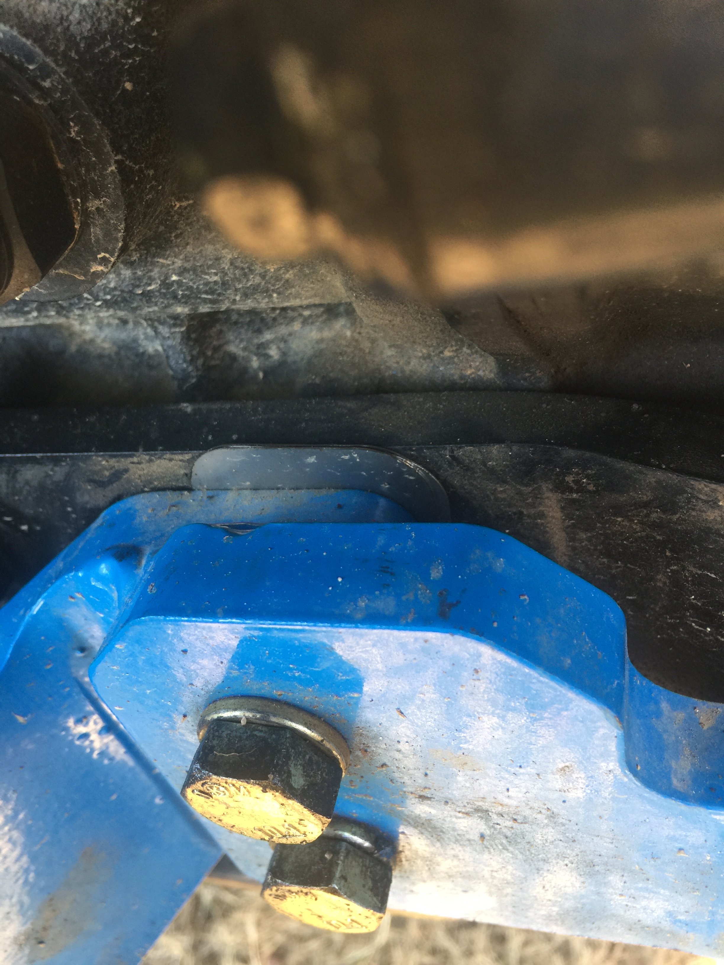

Ehinson (or anyone with the shim installed) could you take a picture of the underside of the shim and tell me if it goes all the way down. I just bought a brand new xg3025 h on Thursday and I noticed after reading this thread that I did not have the shim. I have a large gap at the top and it is tight to the frame at the bottom of the bracket. I can put a feeler gauge all the way to the bolt on top. It measures .056"+. So the geometries off if the bottom is tight to the frame and the top is loose. I'm also noticing a bit of seepage around the oil pan. I've only put an hour on the tractor. please let me know as soon as you can if you can see the shim on the bottom also. I'm going to talk to my dealer tomorrow( Monday)

As I recall it does go all the way down but I will look again tomorrow.
My pan still leaks and I'm going to pull it off.

Got the tractor back, I can see the shim they put in on the right side between the loader and frame.
Odd thing is I noticed my steering is allot stiffer.
It's been raining for days so I haven't had a chance to really check out what else they did.

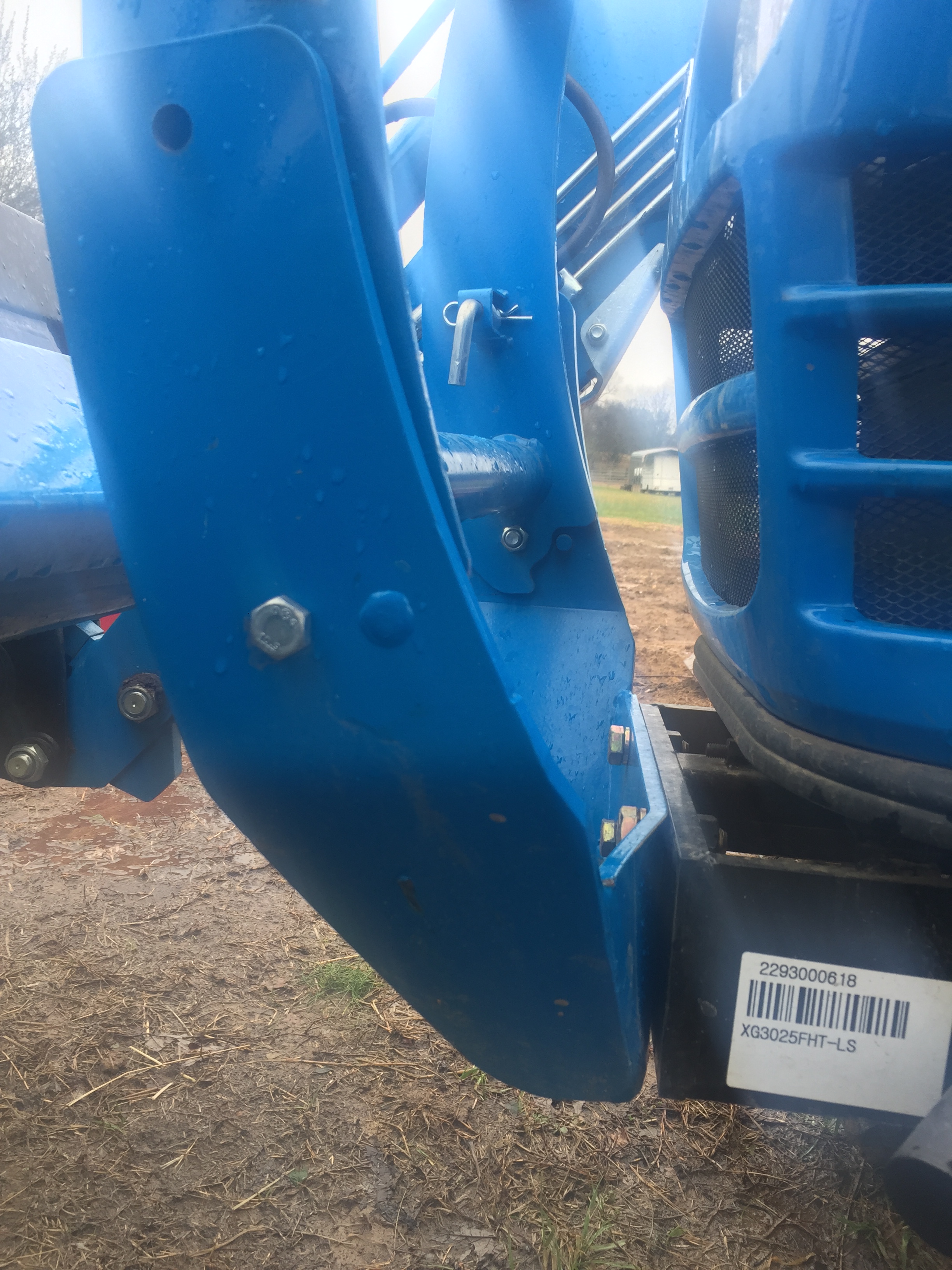

Also the guy who picked up my tractor hooked his winch cable to the front bumper and bent the **** out of it.
I called the dealer and he ordered me a new one.
Actually, I did that to my G3038H by forgetting to put the brushguard back up after doing a service and having lunch. I brought the loader up and drove to do a job and the loader wouldn't go all the way down - What the ***! - Slap of forehead and, yup. Looked just like yours does.
Funny thing is, it wasn't really a defect, it was a feature because I could open the hood without having to drop the brushguard. Well, I had also run a big limb through my grill and broke it up pretty badly, and broke the right headlight. So, off came the brushguard, and off came the hood. I plastic welded the ABS back into a pretty decent shape and then beat the **** out of the brushguard, repainted it and reassembled everything except I put a shim between the guard and the frame and you know what, I can open the hood and never have to drop the brush guard again. Think about it before you make it all "right" again.
