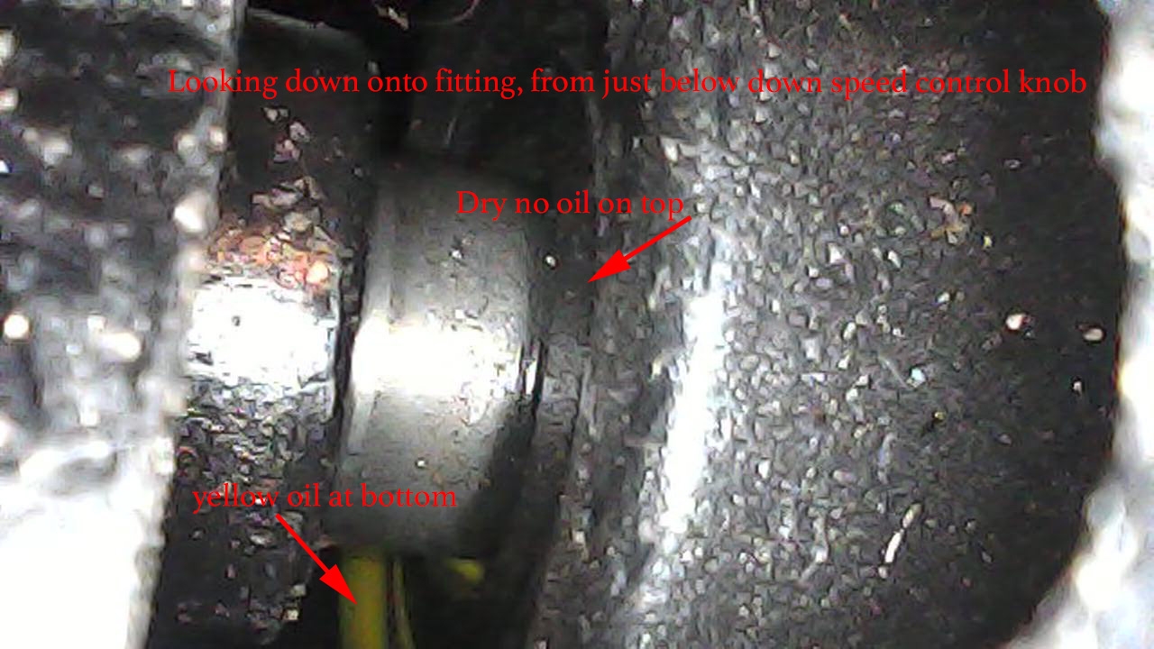

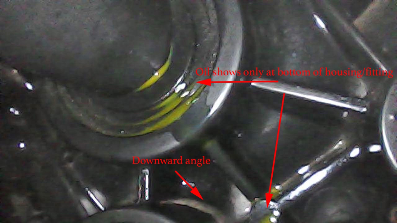

New issue, directly below the down speed control knob (below the front edge of the seat) there is a pipe that is connected to
a cast housing beneath the seat. the connection between the pipe and housing appears to be seeping hydraulic oil only when equipment is operated. This connection is close to the drive train that powers the front end when in four wheel drive (no oil on those parts). Any thoughts would be appreciated. Note Hydraulic oil appears yellow because dye was added to help diagnose a previous issue.
