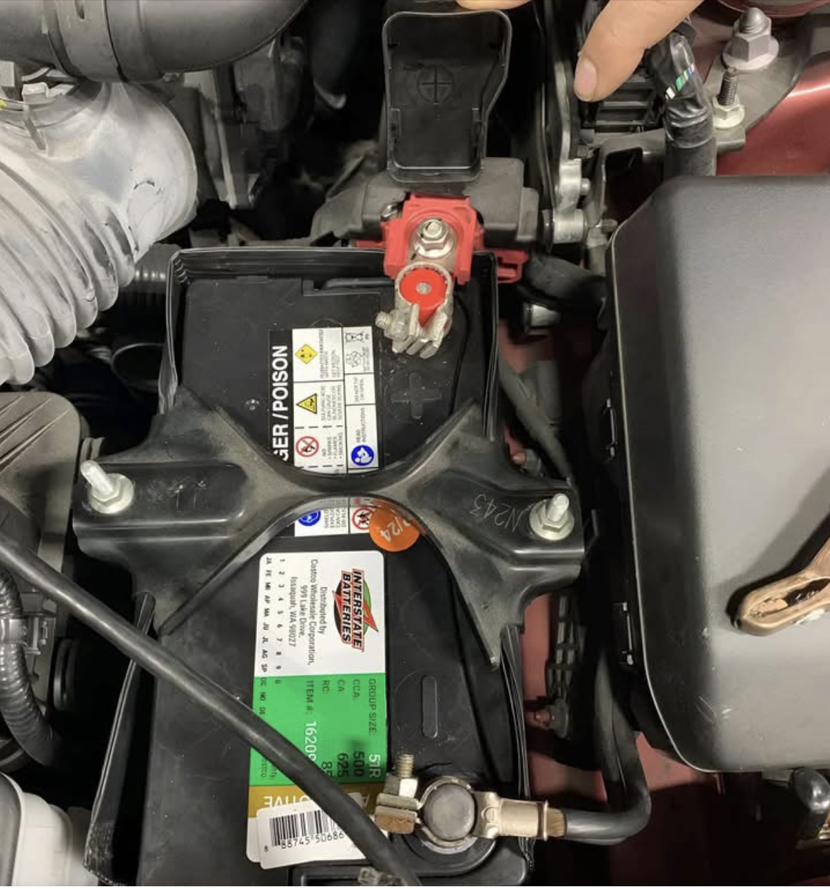

Uhhh I think you forgot to skinner back there fella.^^^^ :ROFLMAO::ROFLMAO:
