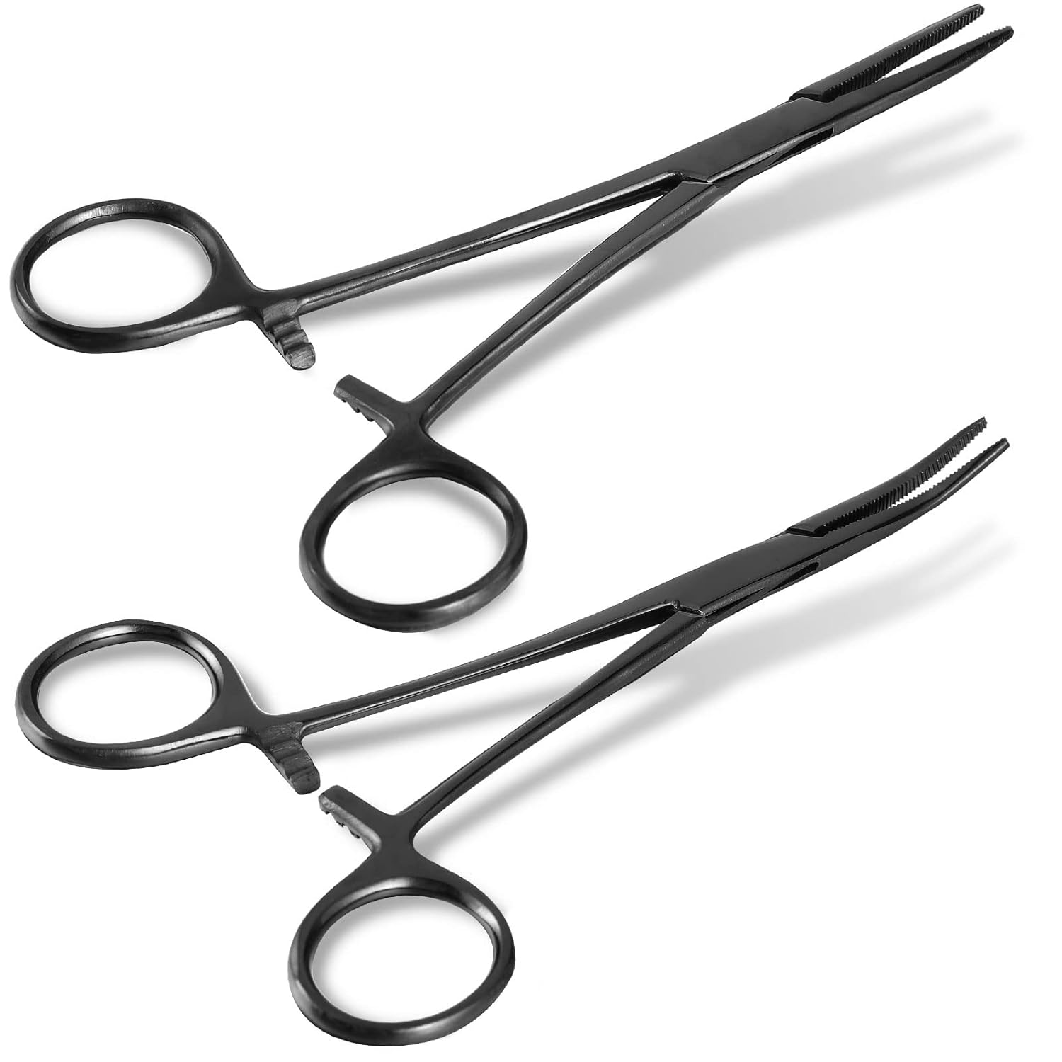

I have checked the fuses, they are mini's and difficult to remove and check, all appear good.
Hemostats are super handy for checking all blade fuses. Easy to grab and lock on and reinstall. I have several that I've accumulated over the years and use them quite a lot. Very handy for handling small parts, etc. (Not just for doctors anymore . . . )
