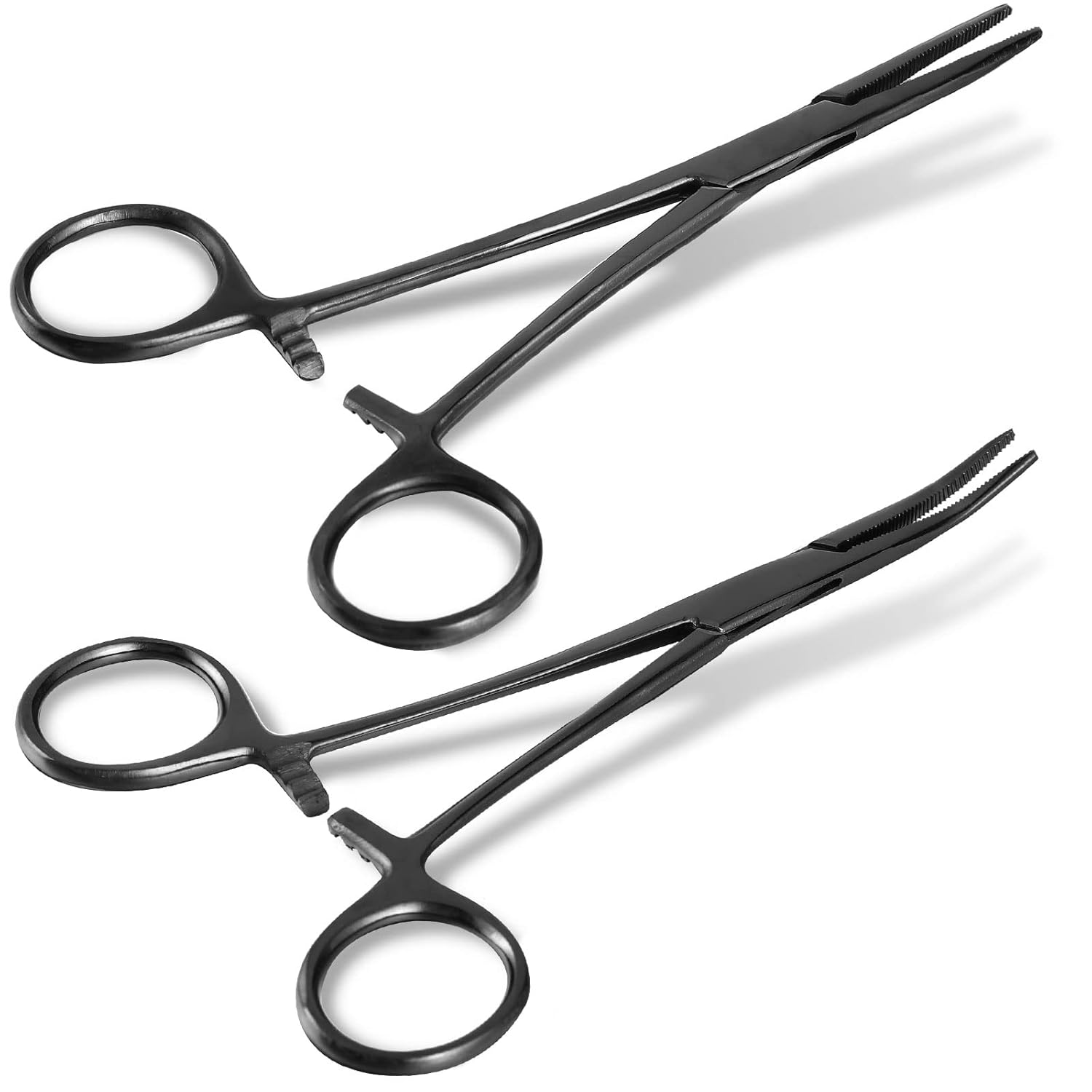

Hemostats are super handy for checking all blade fuses. Easy to grab and lock on and reinstall. I have several that I've accumulated over the years and use them quite a lot. Very handy for handling small parts, etc. (Not just for doctors anymore . . . )
I had some of those back in my college daze… mid ‘70’s… kept me from burning my fingers when the… uh… um… “cigarette” … yeah, that’s it… it was a cigarette … when it burned almost to the end… 🙄
