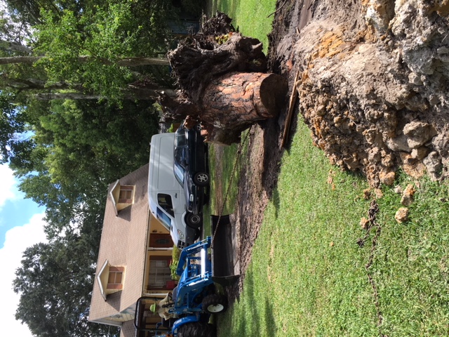

The following are part of our stump removal program w/ the XG3025H as requested.
The hole was dug out & then the many tap roots were under cut after the sand & mud was washed out from the roots.

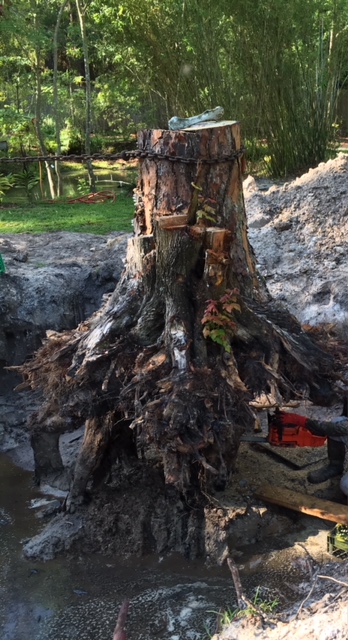

This stump was too tippy for the tractor to safely carry it to the woods.
We dragged it backwards for 1/4 mile.

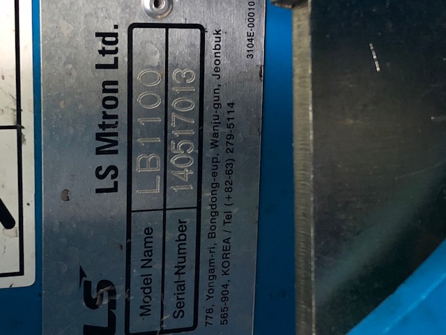

My tractor XG3025 with the LB1100 backhoe was delivered this afternoon. I immediately checked for the top link hook up and find that my backhoe has no way to attach the top link. Please see attached photos. Big Blue Florida is that attachment point for the top link on your backhoe welded or bolted on, couldn't tell from the photo. I plan to contact my dealer next week to see if he can explain the different models. Happy fathers day to all the DadsIMG_1200[1].JPGIMG_1204[1].JPGIMG_1210[1].JPG

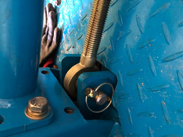

fgsiii, not trying to stir the pot..........I took another look & this pix of our actual connection, at the point under the BH operator's seat.
/ XG3025 Recall #134
I should add that the fit is about as good as it gets, meaning there is not slop between the two locating (blue) bars.
I tend to lean on the side of the tech guys from Trenton Farm Equipment. My recall LS dealer, in FL.
The link should be there to lessen stress on the nuts & bolts connections below.
I told a peek under the blue painted diamond plate floor & noticed on heck of a thick mounting plate in position for the connection point above the plate.
Your floor plate appears to be also cut out as mine is. Just your BH isn't offering our connection point.
Strange, to see this step NOT removed from the factory assembly (plate cut out).
I would have to look deeper in better day light but you may be able to weld in those two missing anchor bars for the link connection.
If it comes to this, we'll be glad to make measurements & forward them to you.

Thanks for the better photo of the connection point. I'm going to print it out and take it to my dealer next week & see what he says. Did you see the photo of the data plate on my backhoe that I posted yesterday? Is yours the same except for the serial number? I double checked my operators manual for the backhoe and it makes absolutely no mention of the top link connection and none of the illustrations show it. I'm thinking you must have a heaver backhoe than mine or maybe there was a difference in model years. Is your serial number higher or lower than mine (please see previous photo)? I hope you have a great Fathers Day & thanks for all the info you have provided.

Thanks Big Blue Florida, according to the data plate we have the same model BH and it's interesting to note that it appears that LS has sold almost 307 thousand of these since you bought yours & I bought mine. That's a lot of steel! Sometime this coming week I'll go visit my dealer and see what he knows about the differences & I'll report back. Tomorrow I plan to become familiar with my BH with a little trenching for a drainage pipe and a couple of small stumps in our side yard. Thanks again.

Hi guys. Yes, mystery indeed. The top link mounting point on backhoes (or lack of) is not based on size. The last rounds of backhoes we've received in both 1100 series and 3100 series do not have the top link mount on the backhoe. There's been no dealer communication that I'm aware of as to why this was changed.
