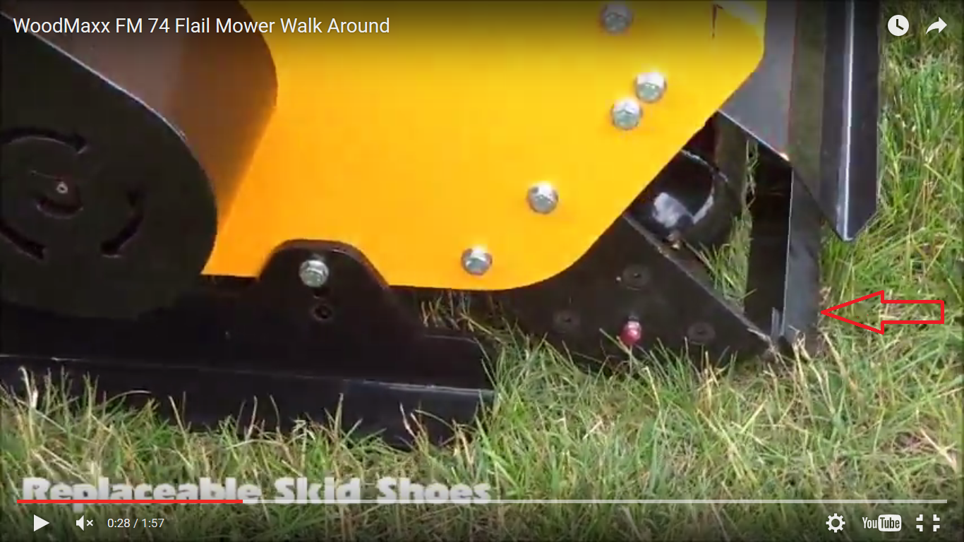

I would suggest making a bracket that raises that roller scraper angle iron. Its current design is awfully low.
Mine is a different design than the one shown in your post. Yes its not very well designed. I will be moving it as well as stiffening the angle iron as it is ineffective at the center of the roller due to it flexing out.

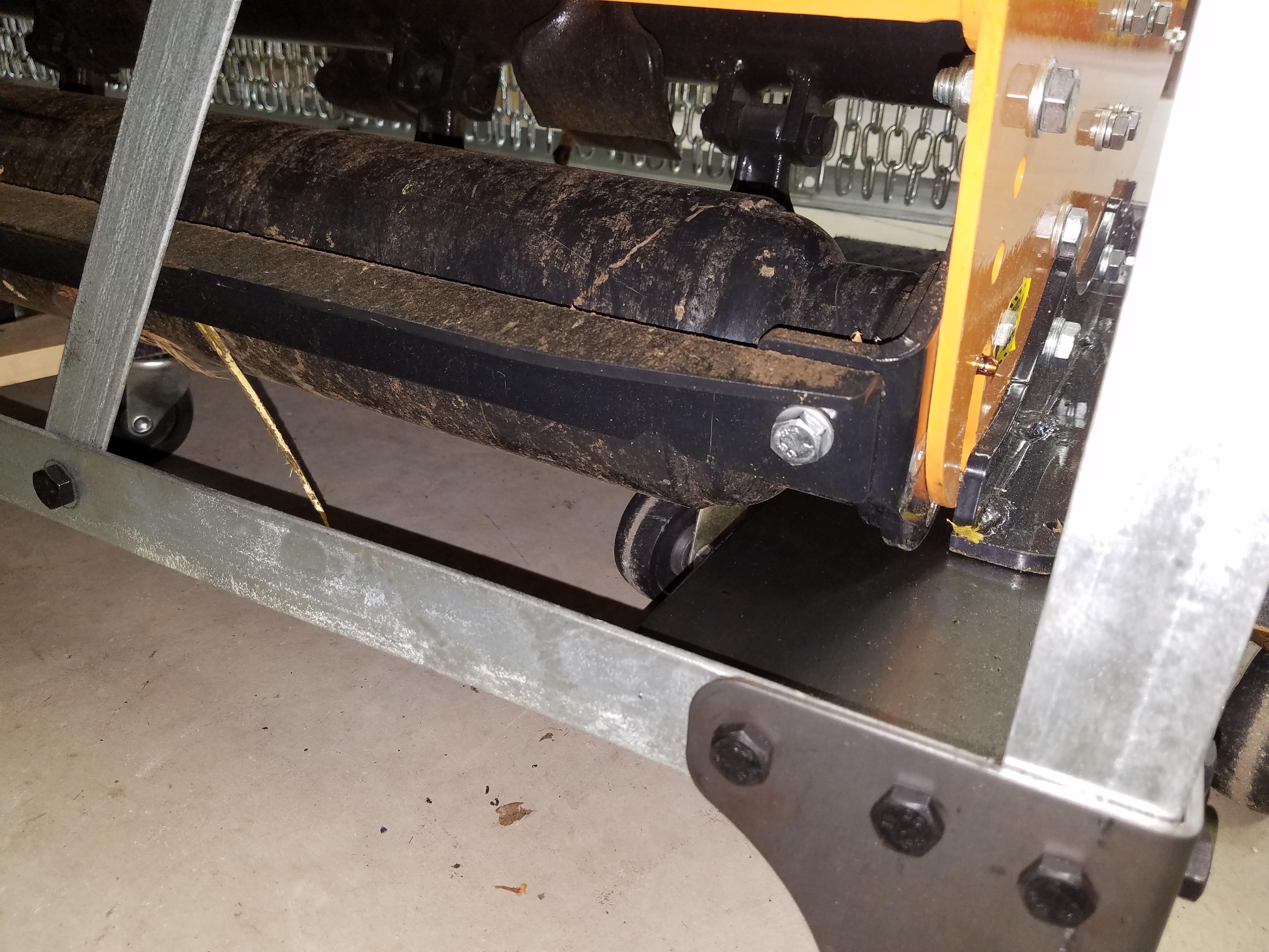

I think they may have changed the design on the newer models. Mine looks like the attached. One question I have is the 3 pt connection hole and slots on the hitch. The manual makes some reference to the the mover being able to move during operation, but does really provide any details. Is the mower intended to be attached by the elongated slots on both the top link and the lift arms or just the top link?

No clue on the Woodmaxx offhand, but all terrain following impliments needs to float. Rotary cutters have a flex link connected to the toplink. My old Ford 917 flail has lift hooks that have about 4-5" of vertical movement. Others use a slot for the toplink.
If the hitch doesn't have some flex mechanism the roller could end up carrying all the weight of the back of the tractor & the rear wheels would come off the ground when going through a small dip or ditch.

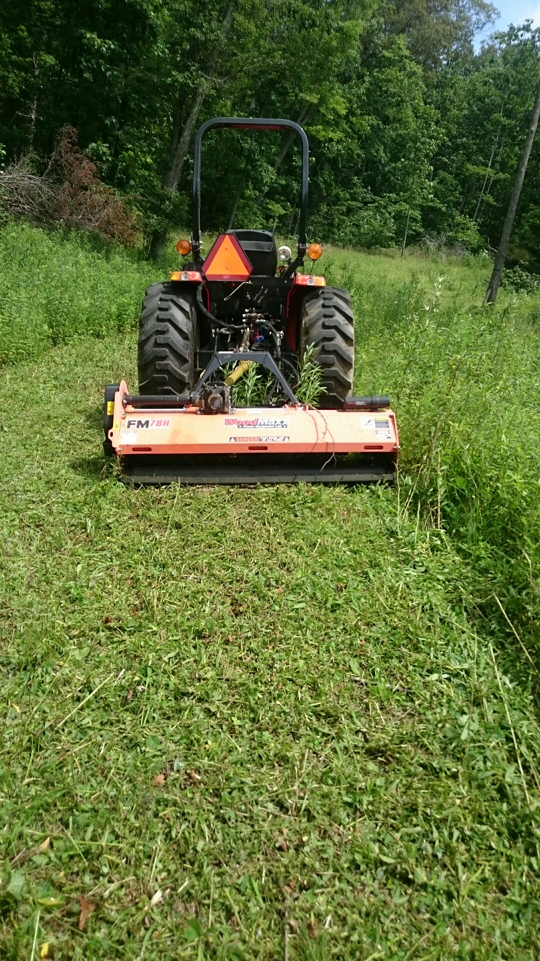

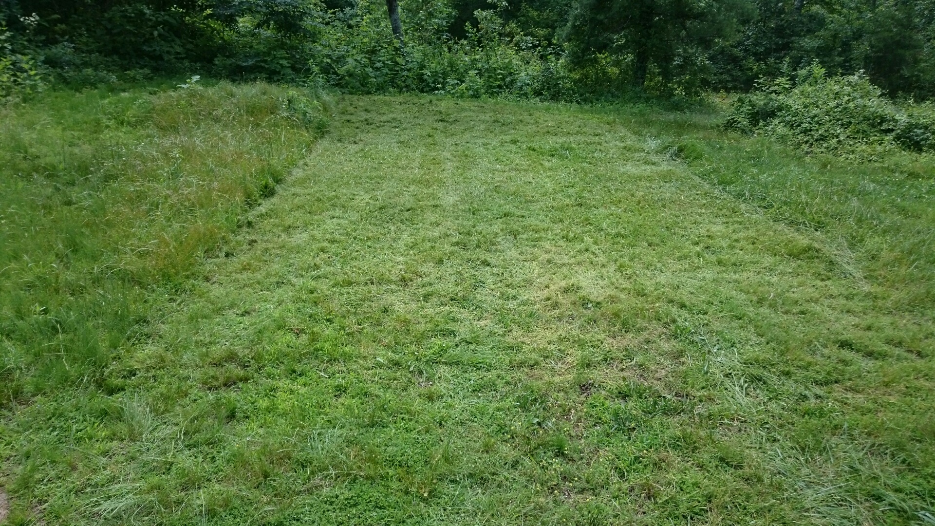

I mowed another 2-3 acres of 4-5ft tall brush/weeds. All went very well mowing at about 4in height. Side shift was very useful around trees and boulders as well as along the road side. I stalled the unit and the pto clutch did it's job when the unit picked a partly buried 6" log out of the ground. All is well with the unit after prying it off the roter
After this I mowed 2 acres of wild flower meadow. Mine has the hammer knives and I couldn't be happier with the cut and reprocessing of the clippings. It's a fine carpet of clippings that will dry fast.
Over all so far my only issue with the mower is the roller scraper which has been redesigned. I'll have mine modified this weekend and solve this small issue.
