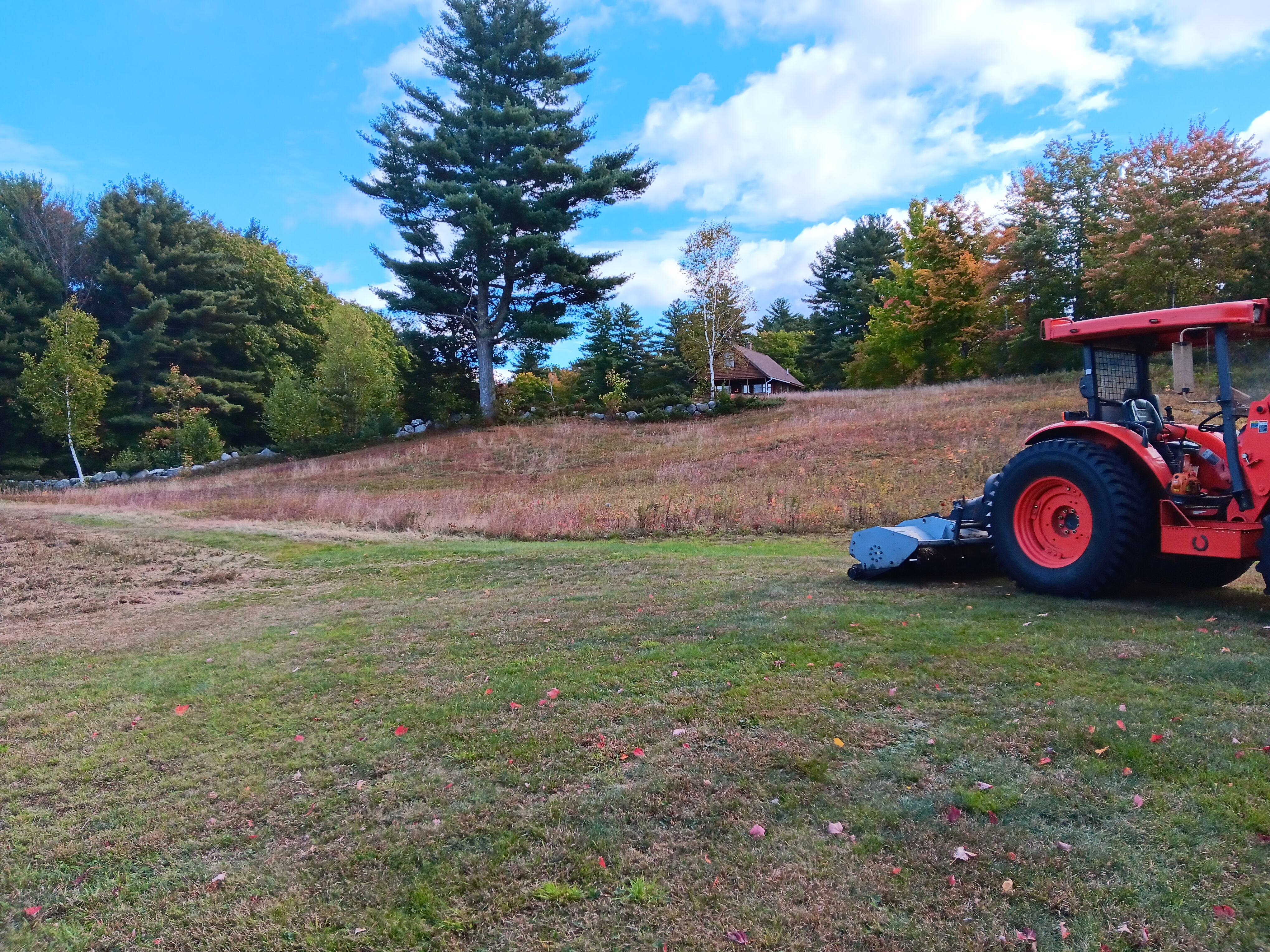

I think mowing in general is very much like snow plowing... A whole lot of variables that affect the outcome.
I find that the higher my flail is set, the worse the cut gets. 3" results in a finish mower cut in normal to slightly high turf grass. If I'm running the flail elevated over my stream bank with tall vegetation, the cut quality is much less consistent.
