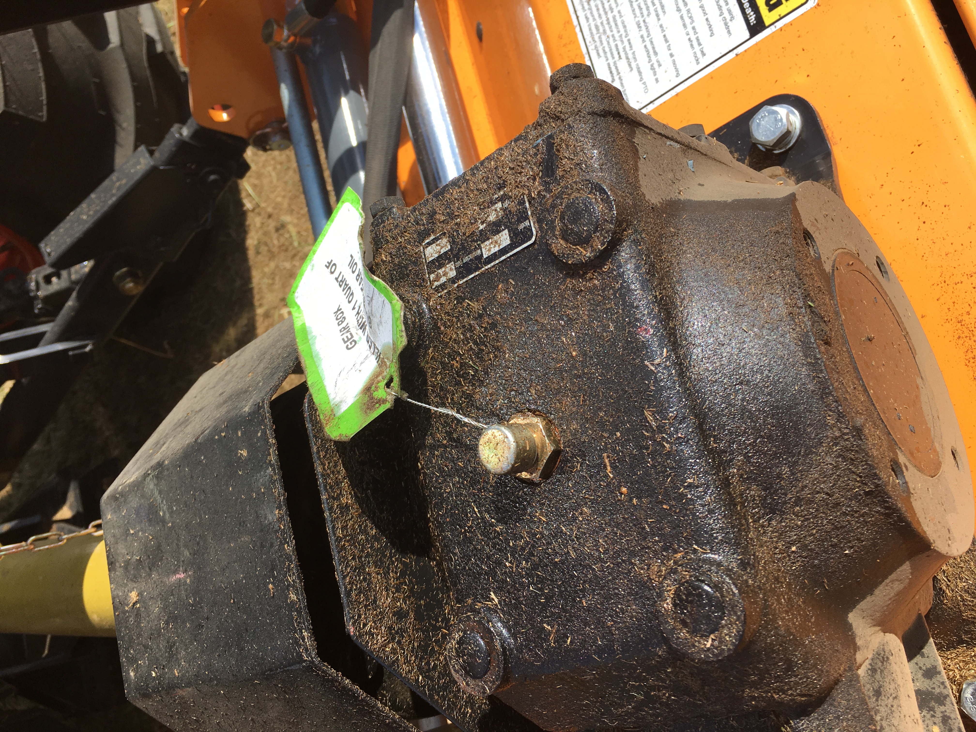

Also ran into an issue with the side to side cylinder as when moving the mower, the gear housing safety metal enclosure hit both hose fittings where they are screwed into the cylinder so movement is about 2 inches either way for now. Tomorrow, I plan to remove this cover cutting down the corners enough to clear ok, a minor thing really but one would think Woodmaxx would have fixed this on other mowers knowing of the issue.Ricn
I think you are referring to the stamped metal shield around the PTO shaft coupling and clutch at the gearbox end. That caused me some problems too and I think the design could be improved, which I will detail in my (eventual) review. In the short term, it would be a huge plus if it were attached with quick-release fasteners instead of nylon locknuts, which are very slow and tedious to remove and reinstall.
The flail mower seems well built overall, similar to the Caroni I previously owned in construction quality, which is (IMHO) a step above the typical inexpensive consumer implements in the US and similar to a brand like Woods.
Mine came with chain shields in the front, instead of the metal plate shields I see on the Woodmaxx website and had on the Caroni. Chain shields seem as good or possibly better, but it was unexpected.

Got the clutch cover fixed ok; took off those hard to get too nuts and bolts then cut the bottom of the cover up about 1/2 inch for hose fitting clearance. Also loosened the cylinder rotating just a tad followed by retightening everything. There is a small grease fitting on the yoke that needs greasing at 25 hours but looks to be tough to get too with cover in place so will change that to 90 degree fitting. Also lowered the roller and side plates to the lowest setting preferring that to the middle holes. Also got the top link cylinder adjusted out some, reflecting what the mower directions say about the mower front being slightly higher than the rear. Made some passes thru the field and all looks good so far.

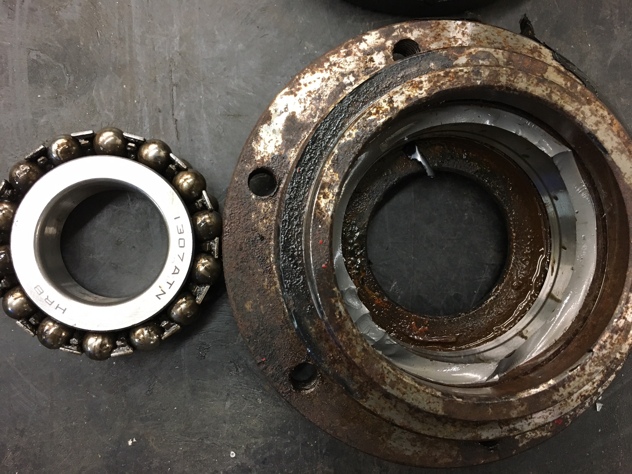

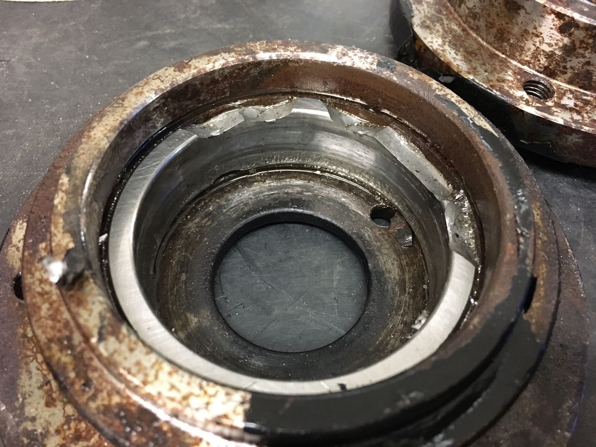

I don't have a schematic diagram handy but this youtube video shows how things are put together (and taken apart) WoodMaxx FLAIL MOWER - How to change the main bearing - YouTube
And yes the seized bearing is on TIGHT. My cheap 3 jaw puller and a bit of heat is not moving the inner race vs stub shaft. The outer race is secured with a snap ring to the bearing housing and that is moving but should not be. I can see having to cut the bearing and maybe even the housing off the shaft but am not to that point yet.

Hopefully the pictures work- Bearing housing with the bearing next to it is the drive side which was not seized yet, but didn't feel the greatest. Non-drive side is the other, should be able to see the nice groove in the race where the bearing failed. One thing you can't read on the bearing because of lighting is "CHINA"
Anyway, I've got two busted outer races to get out of the bearing housings, and one stuck inner race to get off the main rotor stub shaft - what fun ahead!
I am definitely sorry to see the trouble that those bearings have caused you. I would not install anything but a known bearing brand FAG, SKF, Sealmaster etc. to replace the pair and send the other bearing back to them with a no thanks I do not want them anywhere near my flail mower. Please purchase some dry ice to get the inner races out of the housings by shrinking them to save yourself a lot of work.
