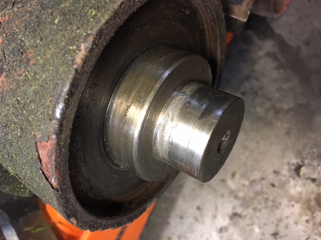

Any tricks for getting the inner race off the stubshaft? I am going to cut it best I can with a cut off wheel, then crack it with a chisel.
I would advise against a bead of weld around the outside :D
I would use an oxyacetylene torch if you have one. I did that this week on one of the rollers out of the round baler, warmed it up until it was just starting to change color as I ran the torch over it (the sheen would change from a matte to a gloss), then hit it twice with a cold chisel.
That cut most of the way through and expanded it so it just rattled around on the shaft.

I recently removed a pulley that was stuck on the shaft of my mower by welding a flange to it, which I then used with a puller.

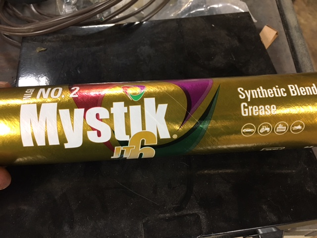

What type of grease had you been using? I am still wondering about the possibility of incompatibility between types of grease.
Grease I'm using: Mystik Store - Mystik(R) JT-6(R) Synthetic Blend Grease #2 - Product Details
Bearing races all out, wasn't too bad. Inner race even spun a bit on the stub shaft - will need to clean that up.

Thanks. Link says:
Mystik JT-6 Synthetic Blend Grease is a premium quality, multi-purpose, high-temperature, lithium-complex EP grease with excellent low- temperature properties
Should be A-OK. Lithium complex is the most common chemistry for tractor and other heavy equipment use.
