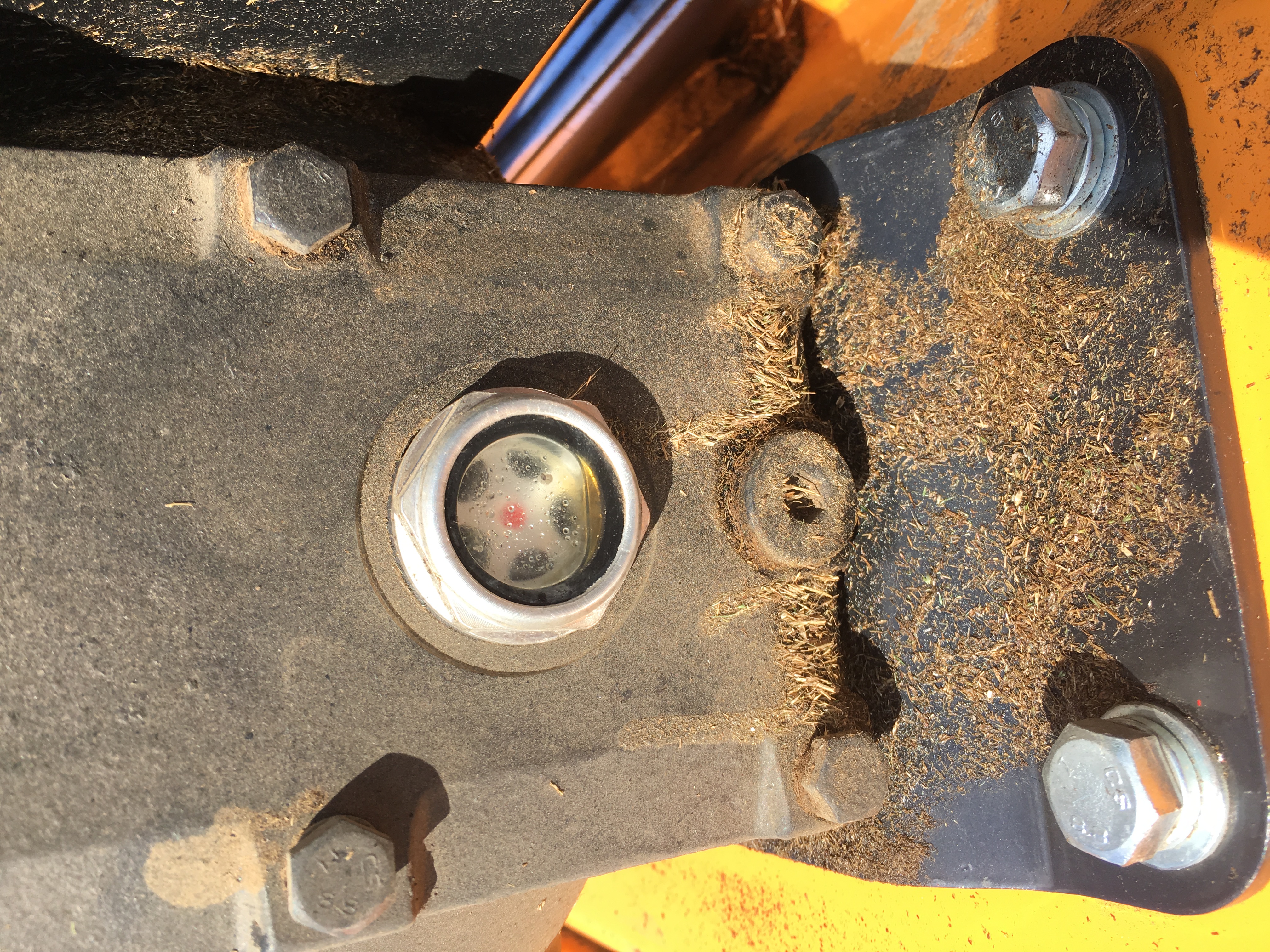

Well, I was able to put about 4.5 hours on the new flail. Did my before PMCS, everything was tight and oil level good. Started off slow and easy with nothing to report. Did some cutting in 6-10" grass with a few small patches of big stem grass. Took a break an hour 20 into it and cleaned of the deck and did some checks. The top of the gear box was saturated, checked the tightness of the vent bolt which was tight. Oil level was at the bottom of the view port, so looks like it lost some due to venting. Checked all the hardware and found the bolt that holds the chain guard rod just a bit loose. Tightened it up and and noticed the quick connects were wet. Messed around with them for a bit and can't tell where it's leaking from. Gonna pick up a new set of male 1/2" npt fittings and replace to see if that's the cause. Finished up the rest of the pasture with no problems at all. I will note that if someone needs to use the hydraulic shift quite a bit that if the clippings pile up on the deck it will cause them to be compressed against the frame while shifting I side to side.

I ran mine a bit more today mostly light brush & scrub 12i high +/-. I also had a bit of oil out the vent plug. I'm going to add a short nipple extension to help minimize this. I've used this as a solution on other equipment.
I've had no hydraulic leaks, or any loose bolts with about on 2 hours on the mower. I tried adusting the angle of the mower from the 15deg recommendation from the manual. it looks like 5-7deg is working best for me.
