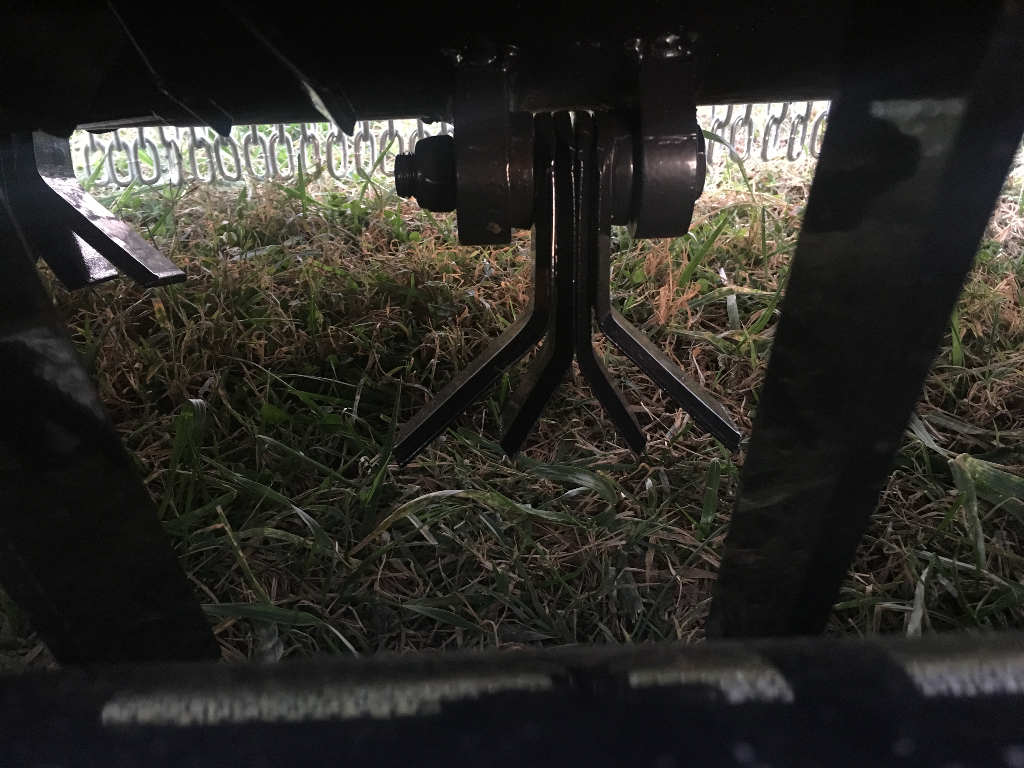

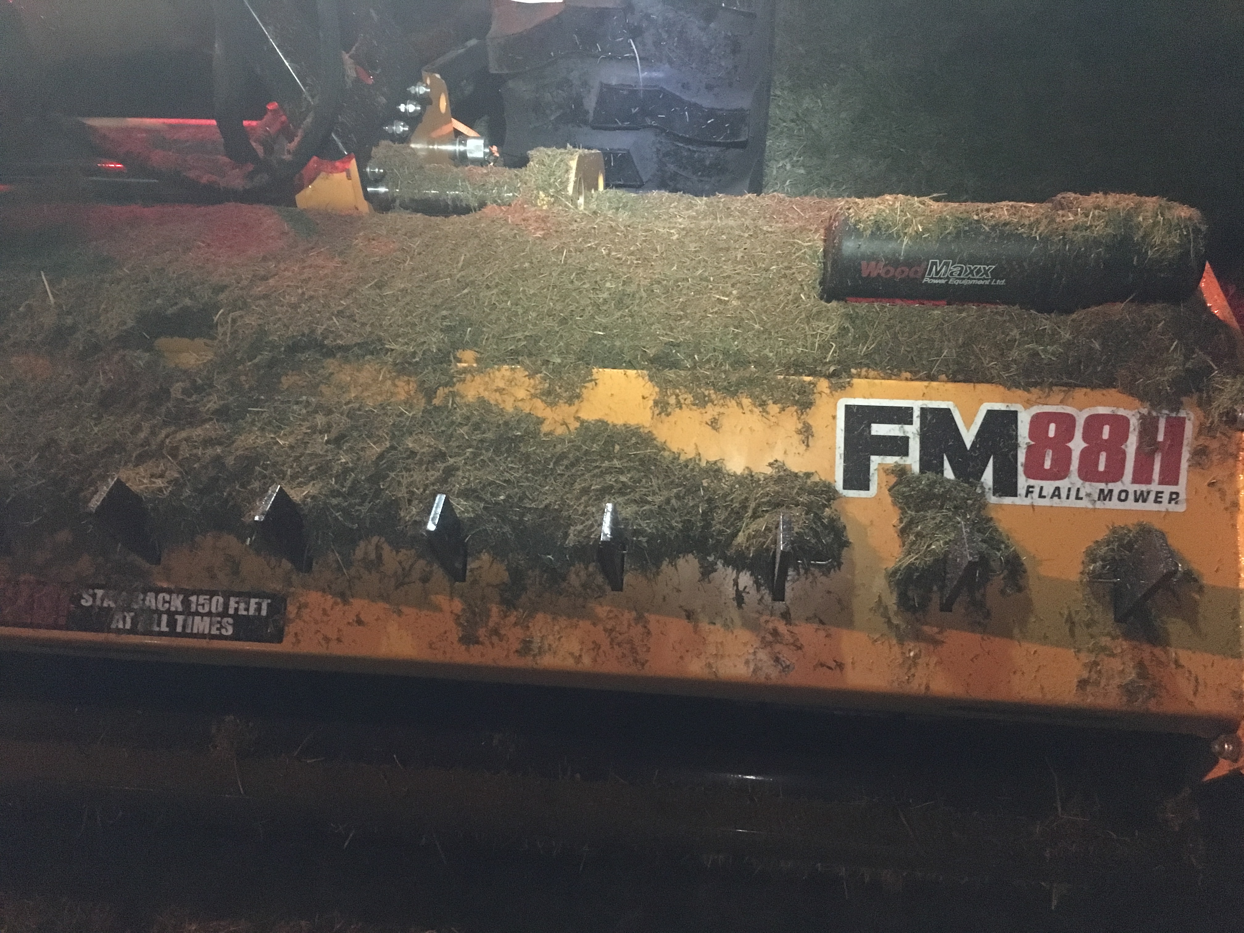

I picked it up and didn't get to touch it until almost dark.
First impressions...
Shipped in a very secure bolted together angle iron frame/pallet. I have quite a bit of 1-1/4" angle for projects now.
Paint could be better, it's glossy, but there are a few runs and drips, not a big deal to me but some may not like it.
Spares that I ordered were shipped with the mower in sturdy wood boxes. I got a full set of side slicers, and 8 spare hammers. (I ordered the mower with hammers) all appear reasonably sharp and consistent in the ground edges. New bolts and lock nuts were provided as well.
PTO shaft was 3" too long but that's better than too short. The u-jounts needed grease. It has a slip clutch. I backed off the tension and we will see what it takes to slip it, rather than the belts. This may be more of a pain and I may just tighten it up, we will see.
Gearbox was full and it was tagged as filled. The gearbox has an overrunning clutch. All bearing zerks had fresh grease on them, but I added 5-6 pumps just to be safe.
Belts are gates (I need to get a spare set) pulleys are in alignment and nicely machined.
The hydraulic lines for the offset are 1/2"npt, no fittings were supplied, I wish this had been called out so I could have had the correct fittings for my remotes on hand...
I set the roller and the skids as low as possible this looks to be about 4in height. Trash door is closed.
I ran it for just a minute, and mowed about 50ft of lawn with it, no vibration to speak of, and the grass got a nice haircut as near as I can tell in the dark...
Fittings and pics tomorrow as well as some light field mowing.
So far do good, it sure sounds cool, like a 40hp 7ft wide Hoover!

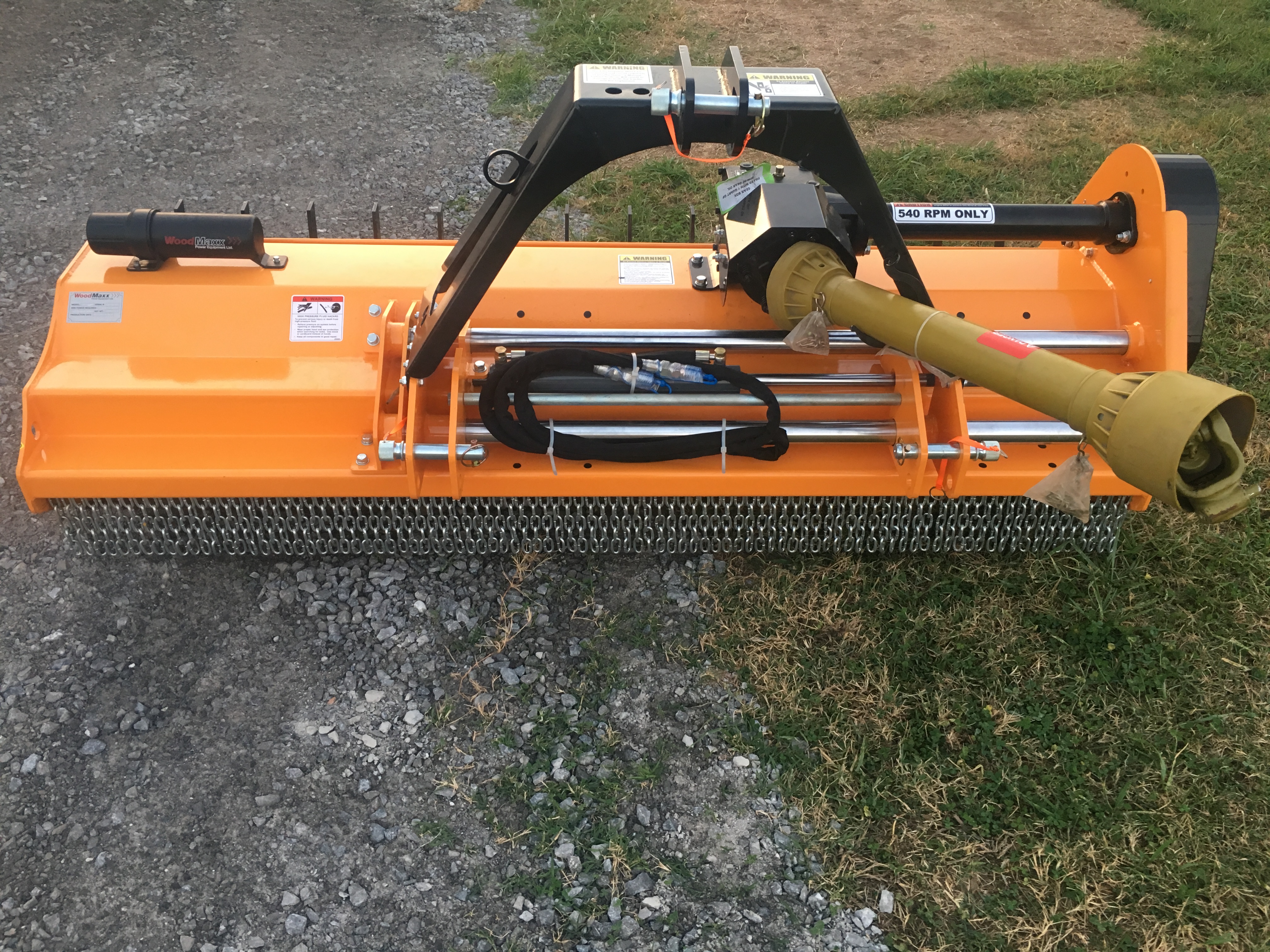

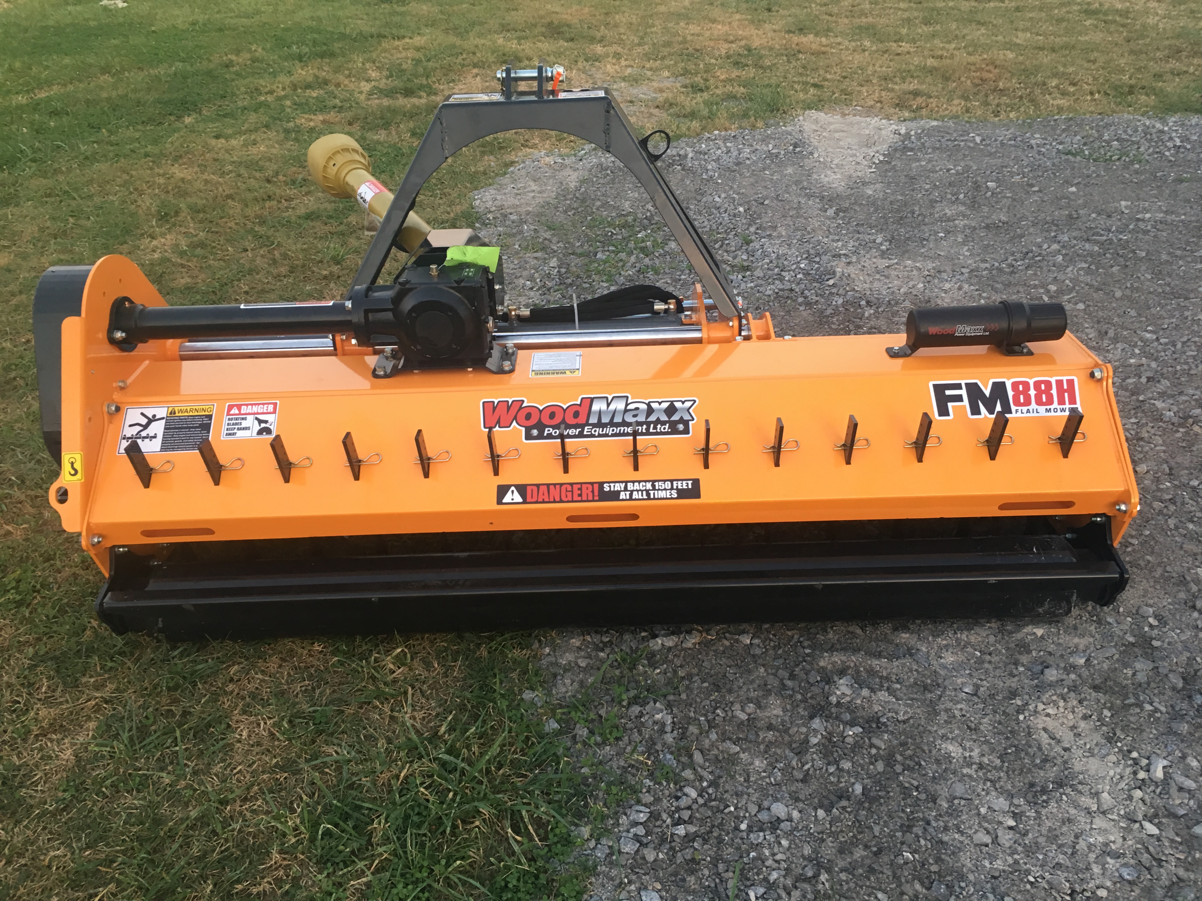

Mine got delivered and set up by the delivery man. Once I got home (after dark) I attempted to mount it, but had problems with the top link. The one I had was cat 1 for my SpeeCo QH. Quick trip to TSC for the right top link, just find out it was about 1/8" to wide to mate to the tractor. Little grind down and presto, it's hooked up. Did a function check to find out that fitting weren't tightened down, so corrected this hurdle and went for a spin. Ran it at 2200 rpm and stayed at a moderate slow pace. Turned 16-20" high grass into extra fine clippings. So far, I'm pleased.
/ woodmaxx flail mower? #58
View attachment 486190View attachment 486191View attachment 486192View attachment 486193
Interesting your is quite different than mine. You have the removable shredder bars, my 78" does not. I'll run to TSC to get my fittings at lunch and see how things go from there.
