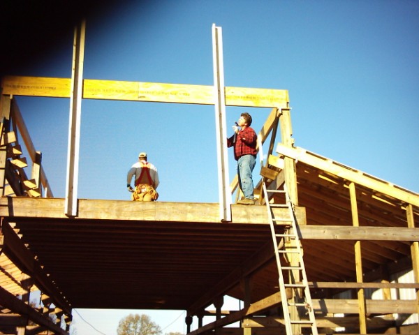

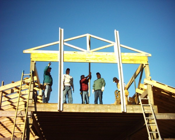

Setting last 2 trusses.

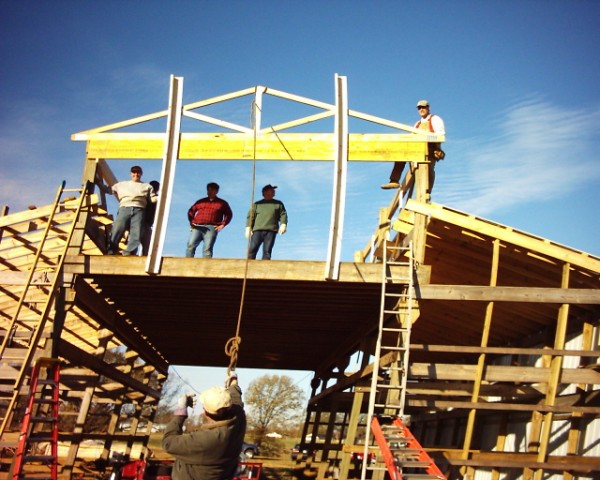

Rolling last truss into vertical.

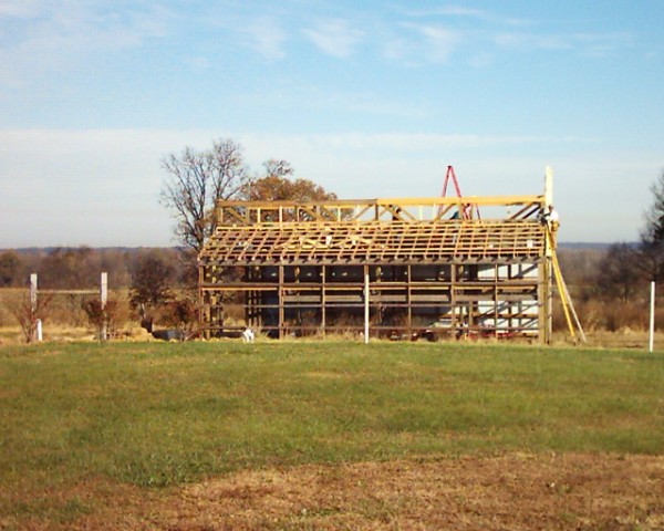

Starting lath.

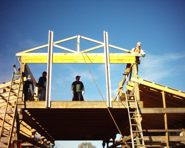

Using a hard spacer to make sure the trusses are on center. This idea worked well & actually caught a layout problem before it got too bad.

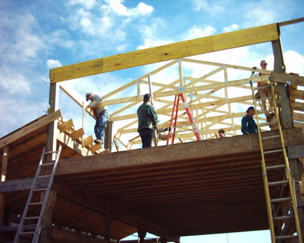

Finishing lath & fascia board.
