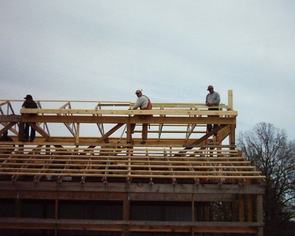

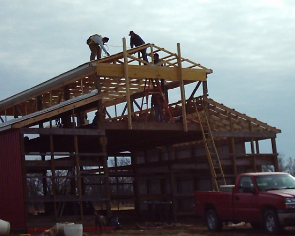

Here we are putting on the 2nd piece of ridge vent. It started to get windy right aftter this photo & we had to come down & work on lower "stuff". You'll see that we are tied off. If you look close you'll see my daughters cat has climbed up on the roof to inspect the works. Truly, she was not that much help!

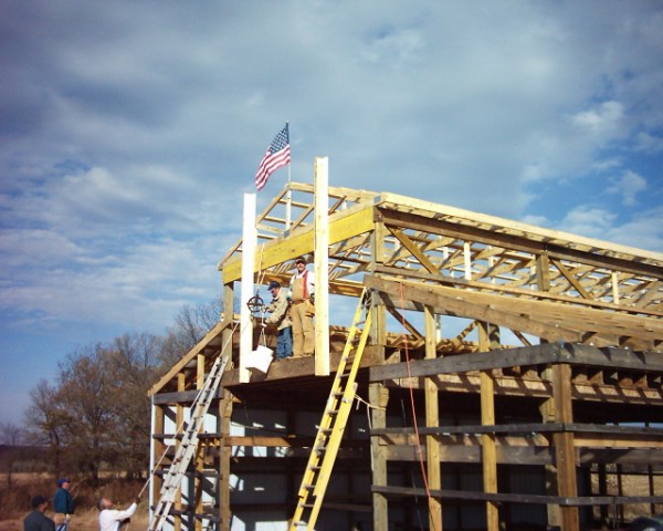

Finishing the 2nd piece of ridge cap, You'll see the top of the cat's tail to the left of us. She got bored & decided to wander around the roof for a while. She eventually came down w/us when we bugged out due to the wind.

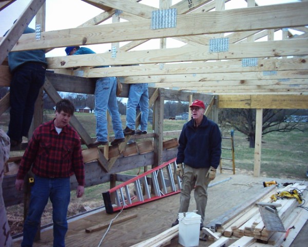

After we came down we finished the door jamb trim, J trim, insualtion & hung these 4 sheets on the east side.

The insulation makes installing the metal a little mor ecomplicated but I believe the payback will be worth it. Particularly in that it should stop the condensation rain during our hot humid summer months. We lapped all insulation edges a lapped a minimum of 3" and sealed w/a special aluminum foil type tape.

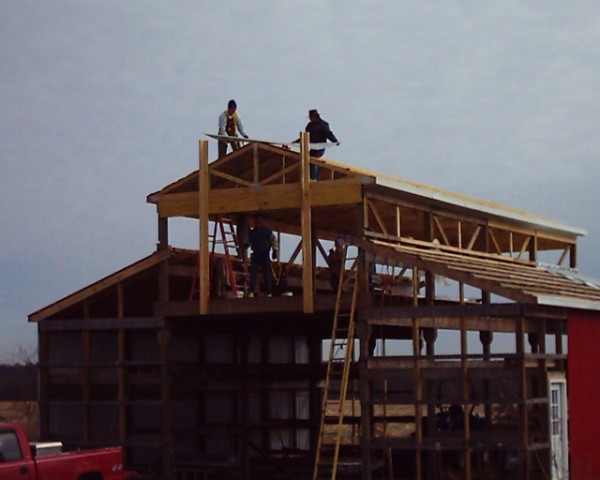

Here we are installing the door track cover on the east end of the barn.

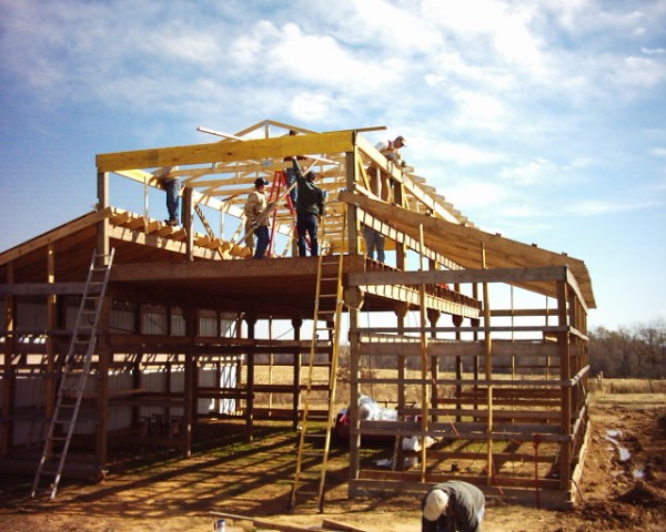

Cutting the roof rake angle on a long sheet. Using a previously cut piece as a guide to get the angle quick & right.

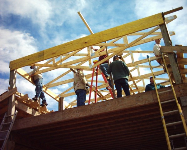

The East end getting a little further along.

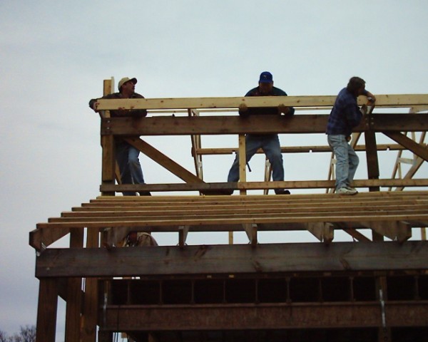

Close up showing the flashing & the return around the end of the door track.
