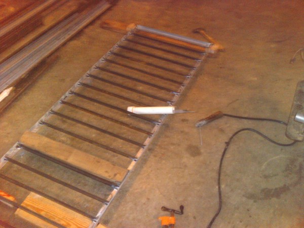

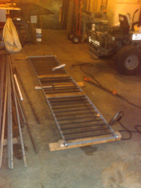

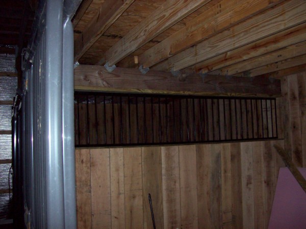

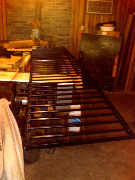

We wanted the barn to have good ventilation & light in the stalls so carrying the oak divider walls solid up to the ceiling was a no-go.
I ended up fabricating a custom grillage divider 24" high out of 3/4" galv angle with 3/8" tube steel pickets welded in on 3.5" centers. This sits ontop of the oak divider wall allowing plenty of light & ventilation in the stalls & we really like it.
I painted the whole thing black before installation & only had to touch up a few places after I installed it.

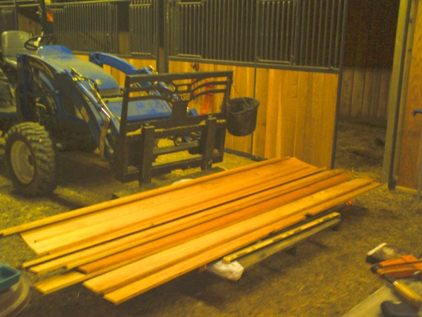

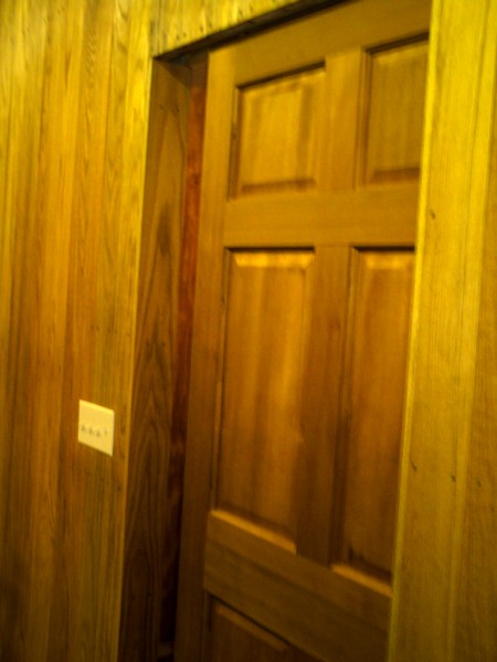

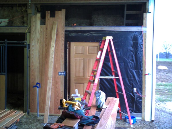

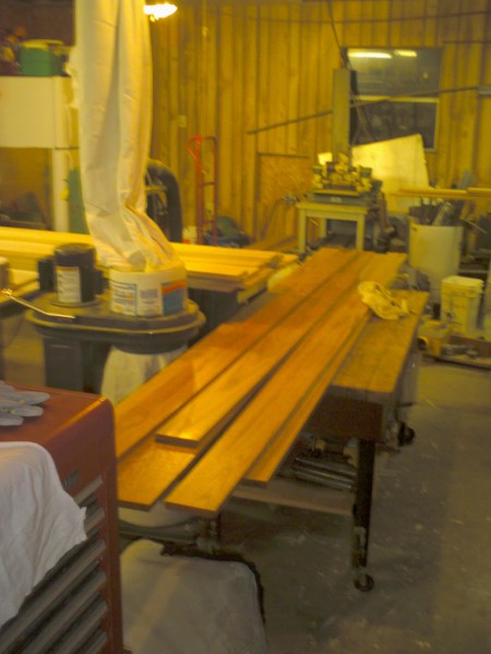

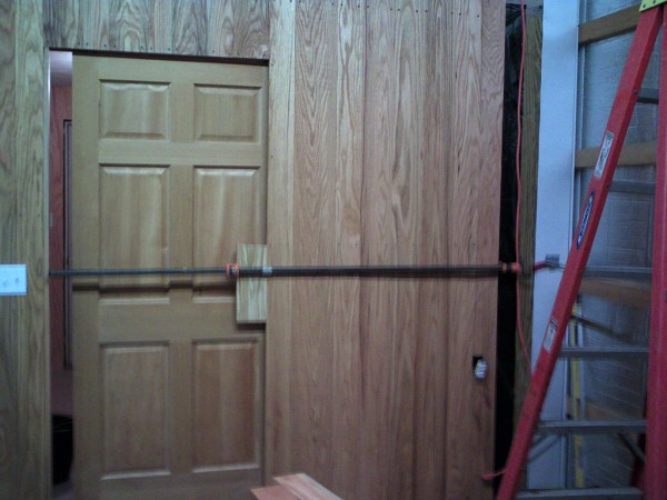

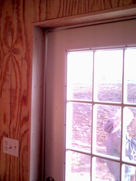

During the holidays we got a lot done on the tack room trimout.
A while ago we bought some 9 to 10 ft lengths of random width S2S 3/4" Red Oak (FAS grade) to use as siding on the hallway side of the tack room and for general door/room trimout of the tack room. I was able to get the mill to give me one straight edge which allowed me to run the stock thru my table saw & get the 2nd edge straight.
We used boiled linseed oil as the finish on the red oak for the stalls so we decided to use the same again. I cut boards to trim around the pocket and exterior doors to cover the rough framing & attached all w/trim screws.
Attached are some photos of the process
(sorry for the yellow cast on some of the photos - my camera does not do well on flash).

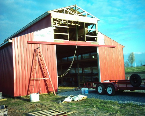

Megado Here's a step by step on how I built our big doors. I hope the detail is not too much but I'm going to presume you have never done doors like this - just skip the parts you already know about.
First a little about the door frame materials I bought everything from my metal building supplier. They sell the round door track & extruded alum door frame pieces along with the metal siding so that's what I used. The door frame pieces come in 3 different ways a bottom piece along with a male and female vertical side pieces. The web of the extrusion for the sides is 1.5 wide allowing them to fit over your siding girts and top board.
Door track first - The round door track hangers need to be installed on a 2x4 that's against your doorway header. The 2x4 thickness is needed to keep the door(s) off the metal siding when opened & worked with the metal door jamb trim I used. The track needs to be 2x the width of the opening and LEVEL (I used a surveyors level to make sure it was good along it's entire length). My supplier had track in different lengths that I pieced together w/factory splices to end up the needed total length.
Doors First tip: A friend who builds metal buildings told me the secret to building big doors is to do it hanging in place This because there is no real good way to build a big door panel flat & square on the ground & lift it into place. The siding metal is actualy what squares the door frame up. You may find otherwise but I did it that way & was very pleased w/his approach & the following is all based around that method.
The most important part of building a good flat door panel is to start by selecting a dead flat & straight top piece. If this isn't straight & flat the door panel will end up w/a twist & rack that will annoy you forever. I used pressure treated 2x6 SYP for my top piece even though others told me a 2x4 was ok I always overbuild. Cut this top piece 1/2 the width of the opening plus 2" The 2" is needed for the overlap on the outside edges to allow the door to pull-up tight against the metal door jam when you latch it shut. My track rollers used a metal threaded rod to support the door panel via holes thru the top 2x6. The second most important thing is to drill the holes for these hanger rods dead center straight thru the top piece I used a guide & a spotter to keep me on track drilling thru the 6" The third most important thing is to get these top pieces dead level when you put them on the hanger rods by adjusting the nuts on the hanger rods as needed..
Once the top peice is hung next is to cut the alum framework pieces to length.. Cut the bottom piece the exact length as the top board. Cut the sides (don't forget to keep the locations of the M & F pieces right) the length you want. Mine were cut so that I had about 1" below the round track so that I could have a little ventilation thru the gap. While they were on the ground & easy to work on I figured out where my siding girts were going & predrilled the screw holes on the inside flanges.
Now hang the sides on the top piece & screw them to it thru the inside flange. It only takes 1 screw in each corner as the screws thru the siding will go into the top piece & really carry the weight of the door. Slip the bottom piece up into place & screw each corner again using 1 screw thru the inside flange. I next cut my 2x4 girts to length & slid them into the channel & screwed them down.
Now we have to decide if the door will be insulated I used double bubble w/foil on both faces all the way around our barn & the doors were no exception. You may or may not be doing the same although I'd highly recommend it. If insulating w/DB tack it into place on the outside so it's between the siding & the wood of the girts.
Metal siding goes on last & is actually what squares up the door panel. Set the first sheet into place getting it good & tight into the corner against the bottom & side rail. Screw it down as needed & install any other sheets as needed to fully fill the frame. Install door handles on the outside & closure latches on the inside (one to pull the panels together in the middle & 1 @ each outer end to pull the door panel tight against the building). Install a door stop @ the bottom outside of each panel to keep it from coming off the track.
I ended up having to fiddle a bit with the nuts on the hanger bolts to get the doors to come together parallel - no big deal as that's what the adjustment nuts are there for.
I installed door guides along the building to keep the doors from blowing out w/the wind & a heavy duty center guide to keep them from blowing inwards.
I'll try & get some photos posted of the door panels to give you a better idea of what the finished install looks like.
Since they were significantly smaller, I built the upper 6x6 doors on sawhorses on the ground using the same process as described above & then hoisted them up onto the hanger rods.
All I can offer is that this process worked well for me on 6 door panels on our barn & I'd do it the same way again although probably a little quicker the next time.
