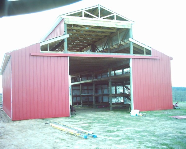

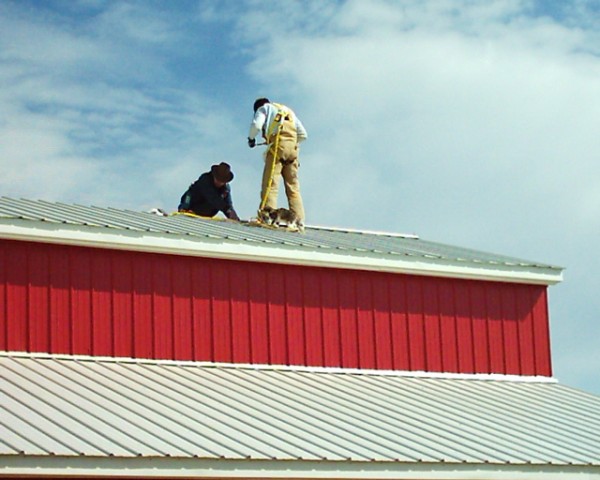

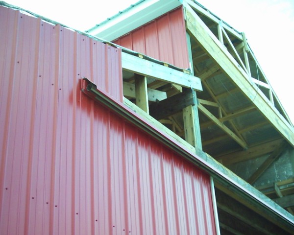

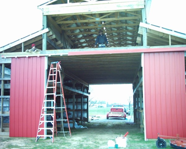

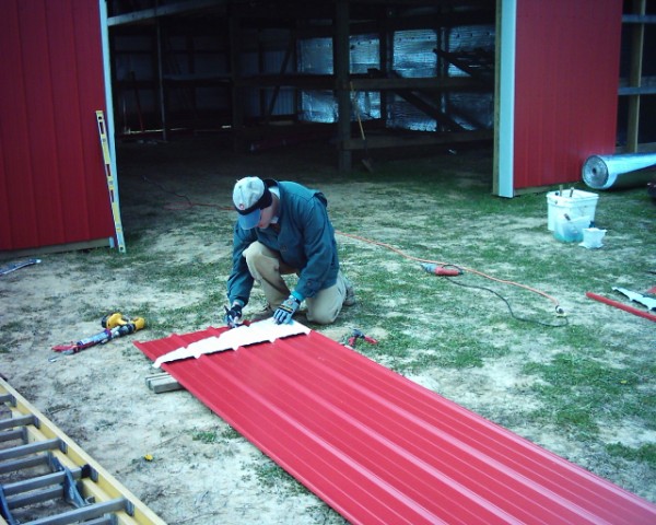

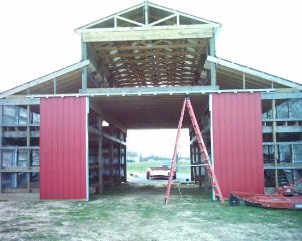

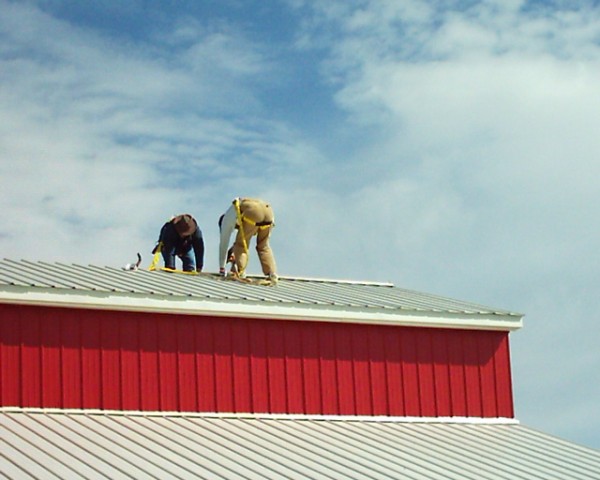

Here's a view from the side. Now to finish the ends above my large rolling doors & do the rake & corner trim to get it dried in.

What kind of insulation is that, what R-value?
Wonder if I should put some on my pole barn.
