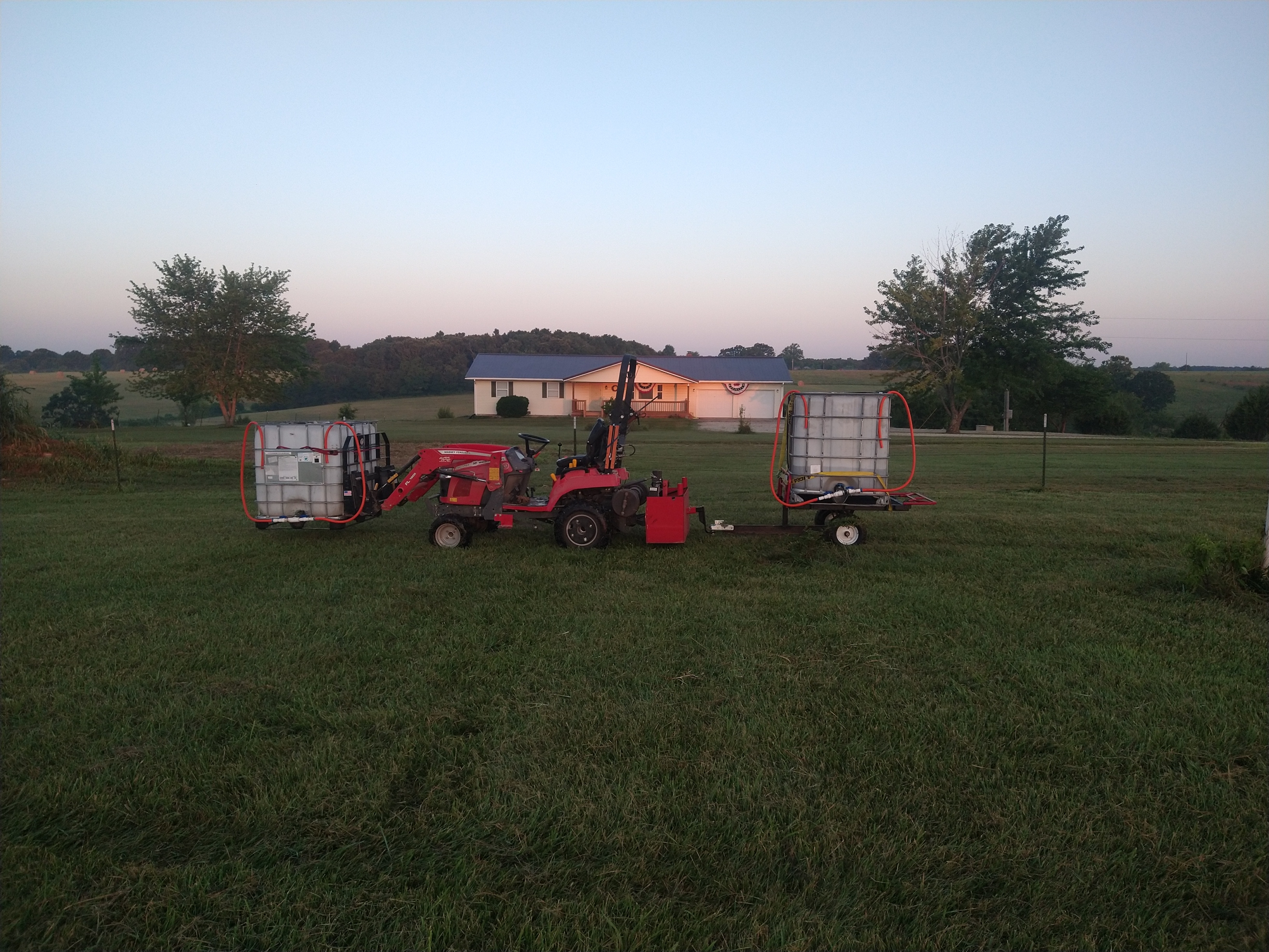

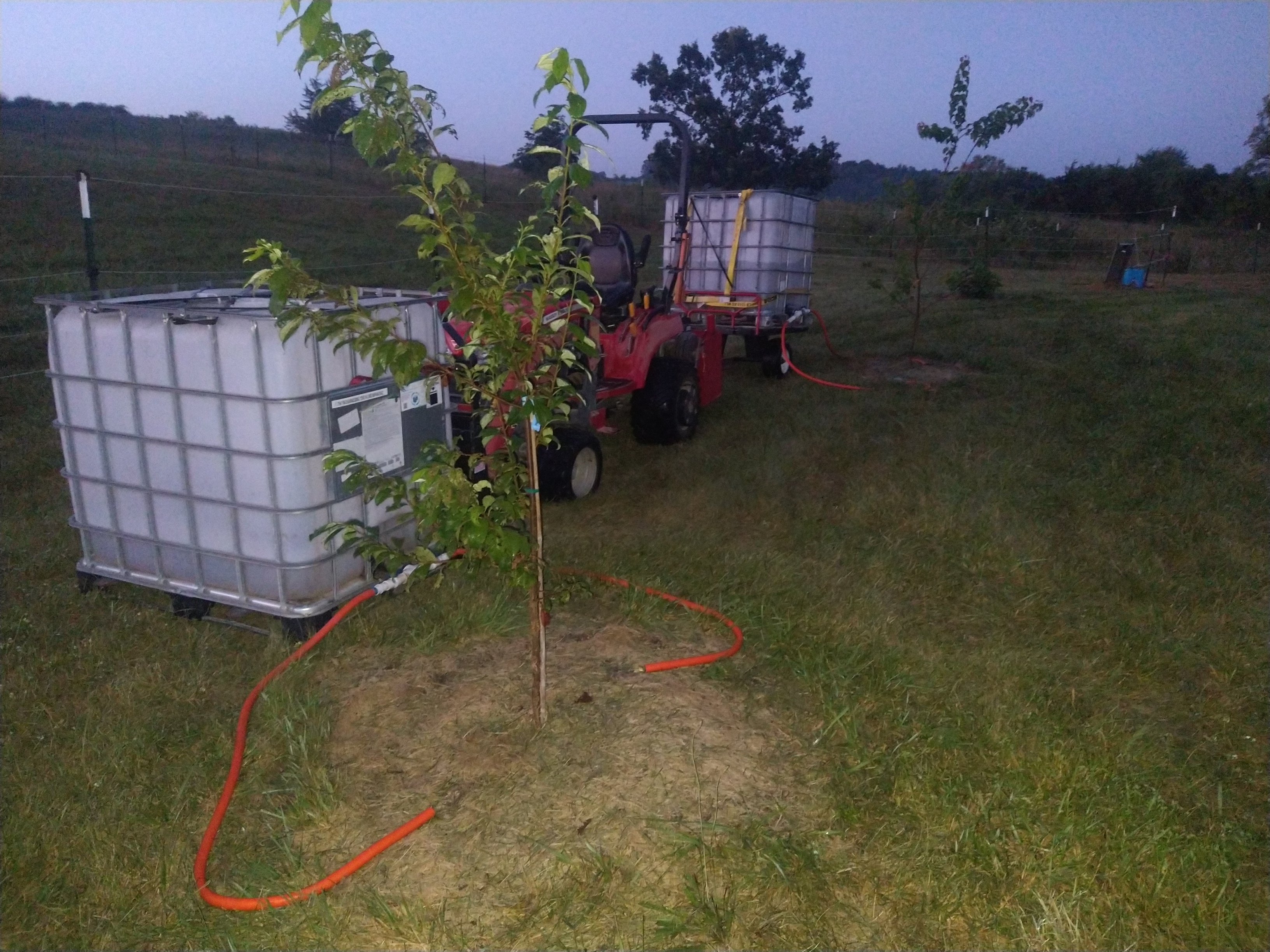

I saved the piece, but it's not high on my priority list ... Watering again today is!
Filled up in the dark, then started watering ...
Sun was just peaking up when I was over half done with the first of three loads.
We got .65" of rain back on 7/17, nothing since, and it's been HOT out ... Heat index was 107° when I parked Little Baby Fergie in the barn and went inside for a cold shower, the 80° 49% humidity house felt real nice, of course the three cats were inside!
