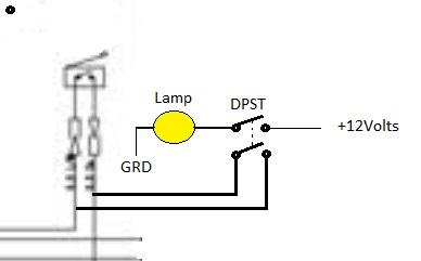

It would be quite simple to have a switch in protected location ..Using a double pole single throw (DPST) toggle switch you can use one set of contacts to act as seat occupied switch (seat safety switch) and second set of terminals turn on a warning light that seat switch is disabled...
I got a bunch of unused dash lights on my GC2400, could easily task one for this. utilize the connectors I just did and if switch fails in seconds I could mechanically be back to switch in play.
may look at that, is an area beside seat hard to accidentally touch that is approx 8" from the switch.

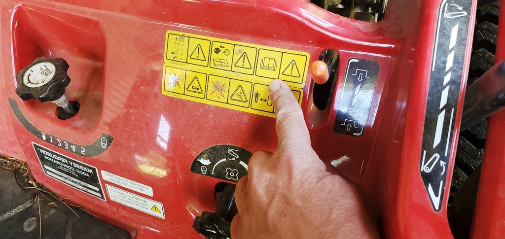

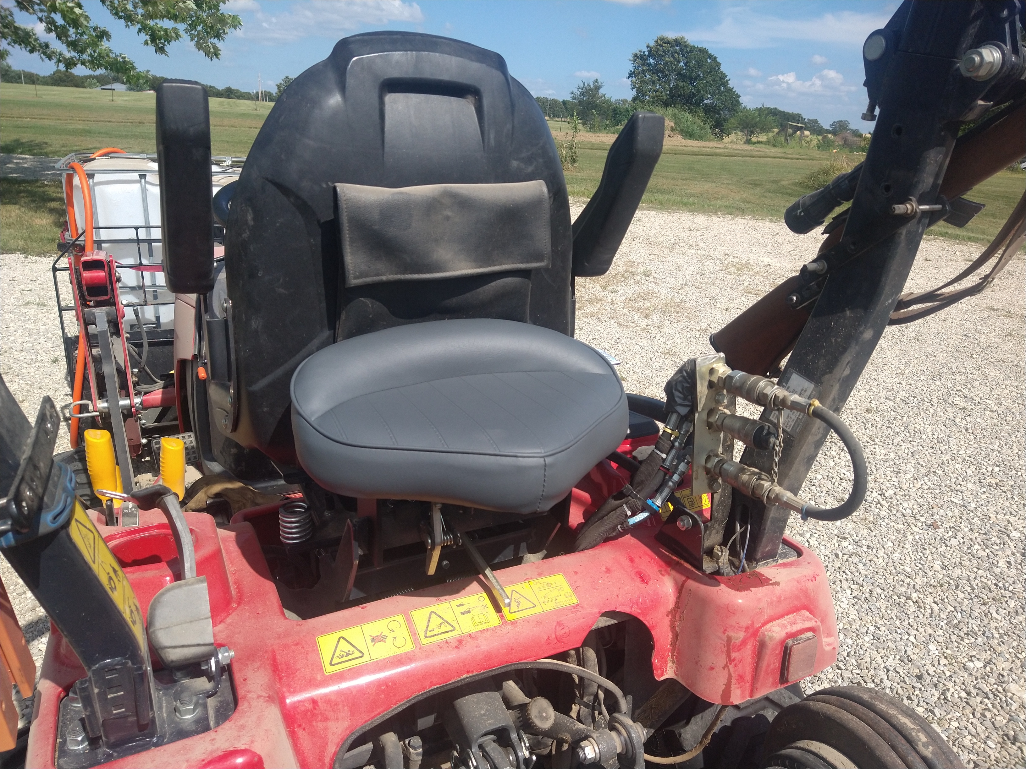

Looked at neighbors GC1725M TLB and think there are 2 spots that would work, they have room under the body for switch base.
this area is below seat and on the edge of the decal there is room under for switch base. I would suspect this would be best spot, not easy to hit it as its out of way but can be accessed easily.
this second pic is right rear behind seat, but I'm not sure how seat swivel for backhoe would work.
