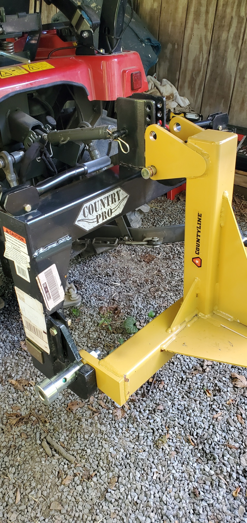

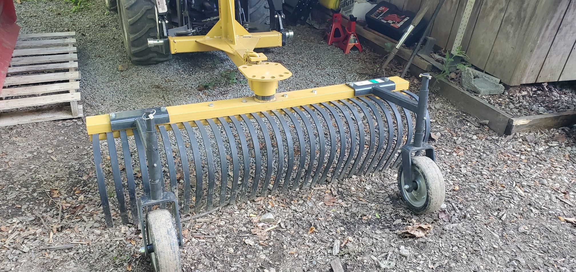

I've been trying out my Tractor Supply quick hitch and Countyline 60" landscape rake, also from Tractor Supply. The landscape rake is actually made by Tartar USA. The wheel kit for the rake is a must have because it's nearly impossible to keep the three point hitch at the height you want on these GC subcompact tractors. So far it's working great. I did have to buy bushings to go from cat 1 to cat 3 on the implement pins so they fit the quick hitch correctly.View attachment 749450View attachment 749451View attachment 749452View attachment 749453
I have a countyline 7ft grader blade, ended up moving back from titan QH to pats QH as the extra 2.5" lift really mattered with the blade. normal QH keep same lift height while the Pats act like longer arms and lift higher.
when fully lifted what is your clearance under the wheels?

The clearance under the wheels wasn't enough at first to remove the wheels to change the wheel hieght with the bushings they give you. So I adjusted my top link and that solved the problem. To be honest there is barely an inch clearance under the wheels when the three point if fully raised. It's just barely enough to remove the wheels.

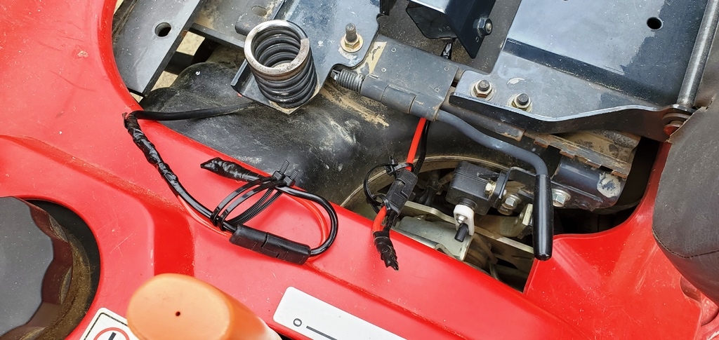

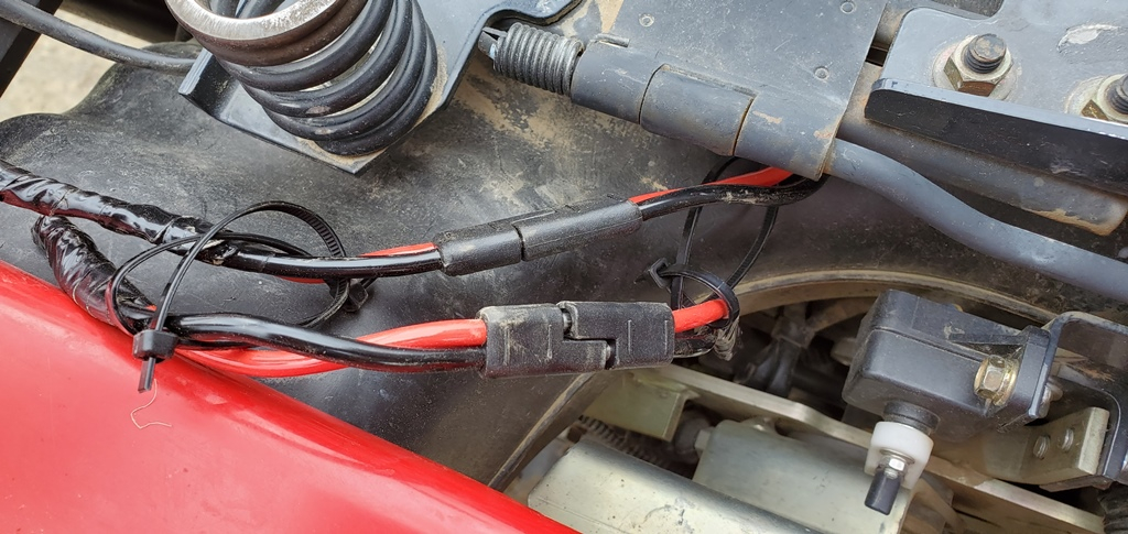

quite often when snowblowing with rear mounted blower, and occasionally when tilling, I have to lift weight off seat (not standing up just lifting a bit) to check something or adjust blower direction. seat switch kills me then.
flip side is when mowing I must have that switch in play.
so I made up jumpers for it.
pic 1 is switch bypassed, jumper on tractor side wired together to bypass switch. jumper on switch side, while it does nothing electrically, in place to prevent corrosion when bypassed. if something happens to actual bypass jumper I can just plug this one in and bypass will work.
pic 2 is switch in play and the 2 jumpers connected to prevent corrosion, wiring will fit under seat frame with no interference with seat adjust or range control safety switch.
can bypass or put back into play the seat switch on 45 seconds.
all connections soldered and heat shrink in place, electrical tape is for extra protection plus wire strength when connecting, disconnecting. truth be told I should have made my switch cut about 6 inches from switch instead of 2 inches I did but...it all works. FWIW wire into switch does NOT disconnect at switch. it is an approx 16" harness or so. and connector end hidden in rear in a maze of wires which is why I made a cut instead of utilizing existing harness connector.

I did consider using a dpdt switch but corrosion and vibration was a factor, something happens in well below 0 temps to this I can make it work in seconds.
