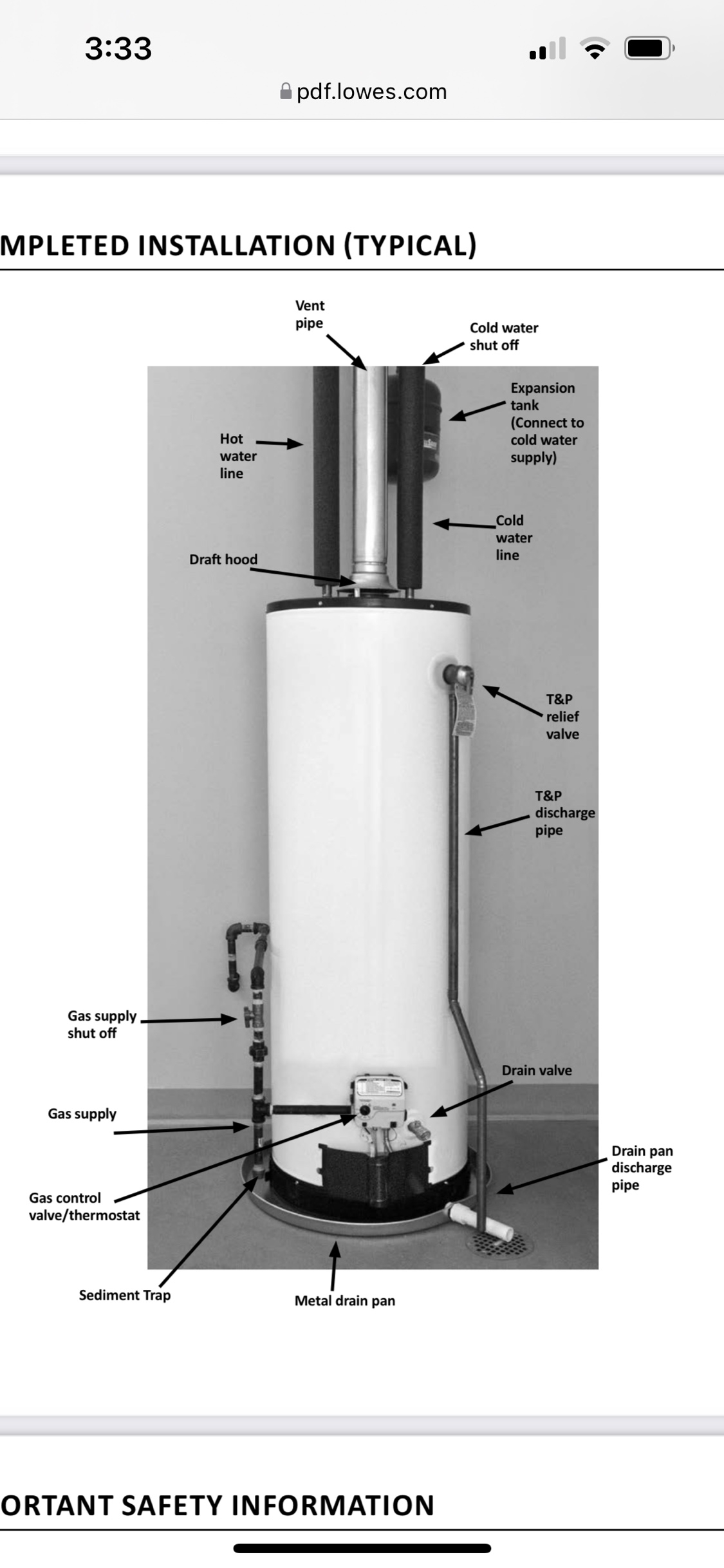

When we did our installation recently, our plumber told us that the new units were all electric start. Maybe there are still a few pilot models, but they aren’t common.
FWIW, I just checked through the installation instructions for 8 different randomly selected gas water heaters at Home Depot. Only one required an electrical connection.
