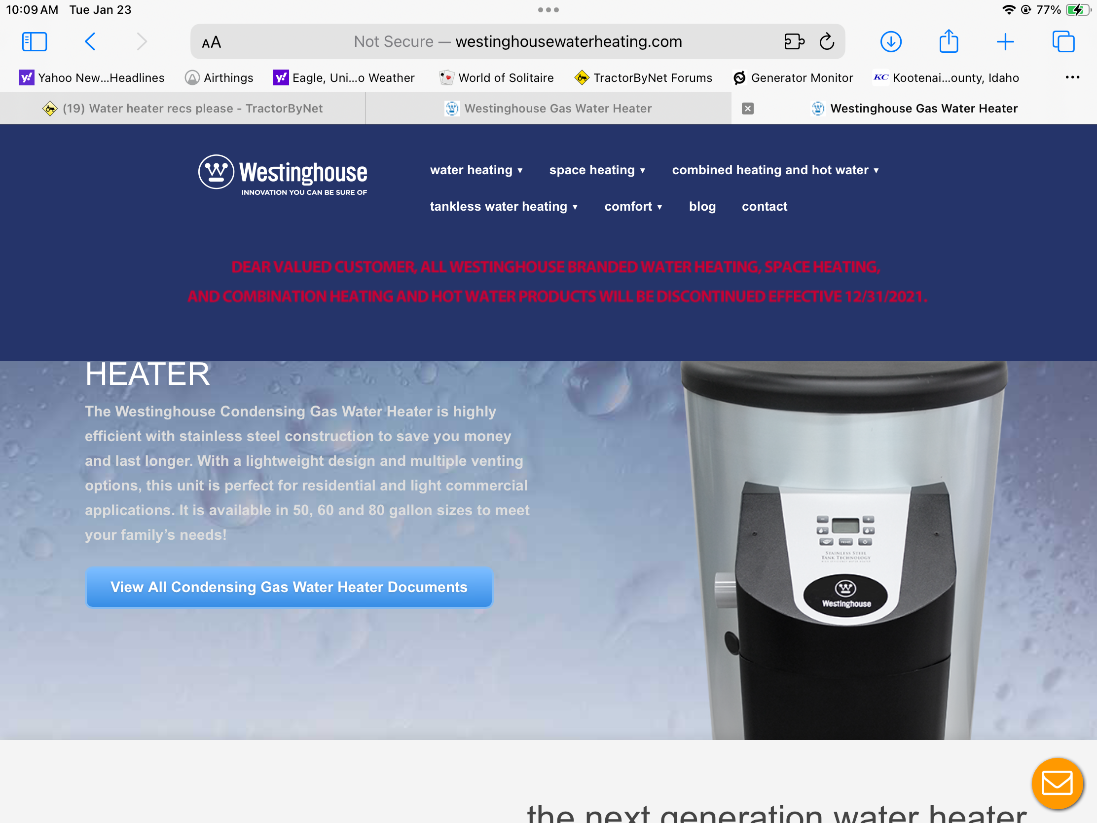

I recommend you check out condensing water heaters. I have a 50 gallon propane model from Westinghouse that I installed 5 years ago. I’ve never run out of hot water, even with the dishwasher and washing machine going at the same time as taking a shower. Not inexpensive, but amazing. 97% efficient too, so it is vented with 2” pvc. There are other manufacturers, but here’s a link to what I have.
Westinghouse Gas Water Heater
The entire brand has been discontinued
