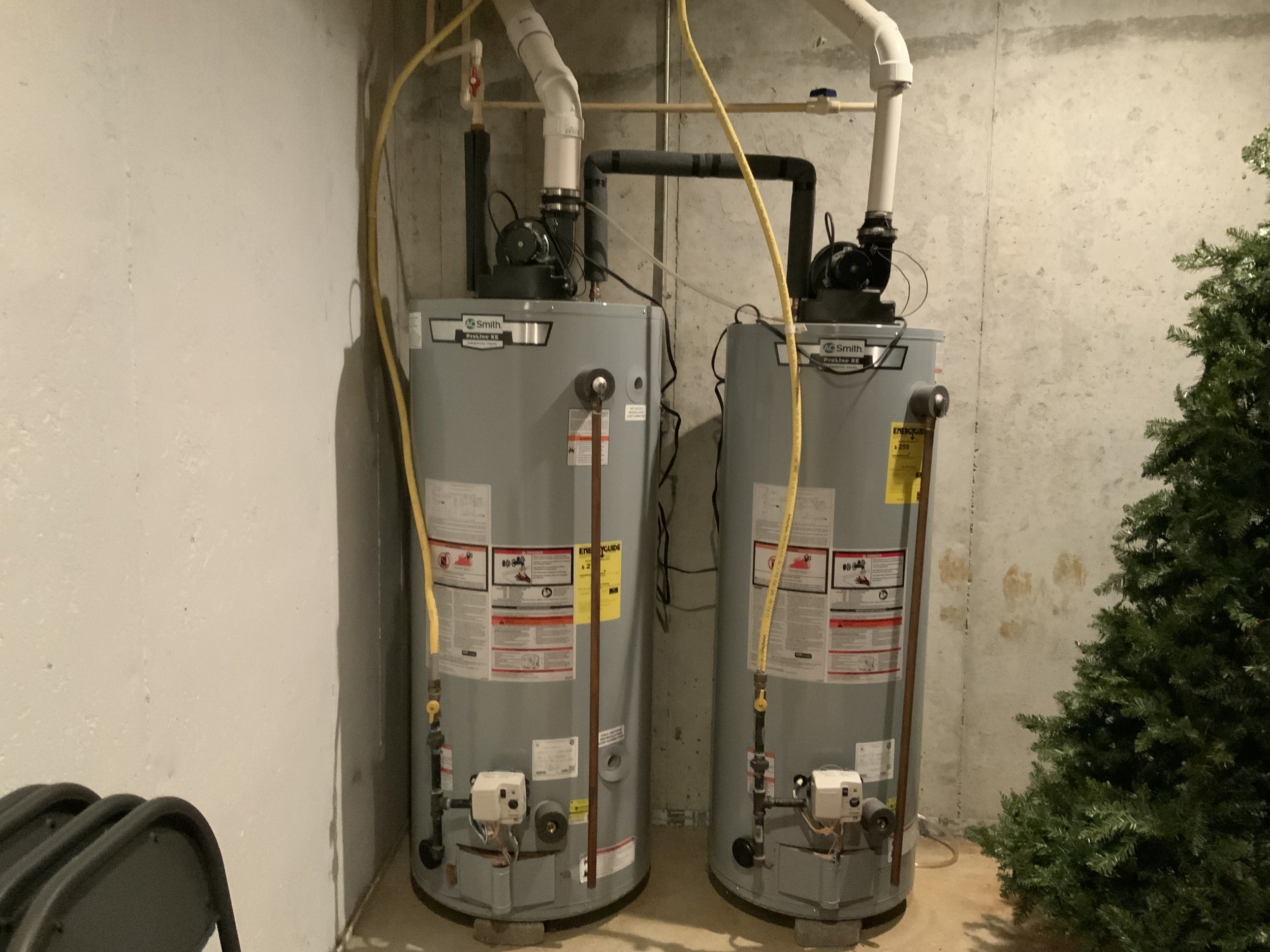

Well, one of my 18 yo water heaters bit the dust a few weeks ago. I decided to replace both plus recirculating pump. NO ONE IN TOWN, including wholesale houses, carry any direct vent waterheaters that work on propane. They all had nat gas units. Most were wanting over $2000 per u it with 2 week delivery times. Home depot was able to get me 2 units in 7 days for about $1300 each. But still, what happens to people that only have 1 water heater? Who’s going to wait 2 weeks for hot water. And rural folk dont have access to nat gas.
Any rate, i also had to replace expansion tank as the bladder had ruptured on mine. The recirculating pump was also 18 years so i replaced that at same time.
I removed and resused the coro protect electronic anodes i purchased in january of this year, and i pulled the junk drain valves on the new units and installed the full flow drains i purchased.
All is well again.
