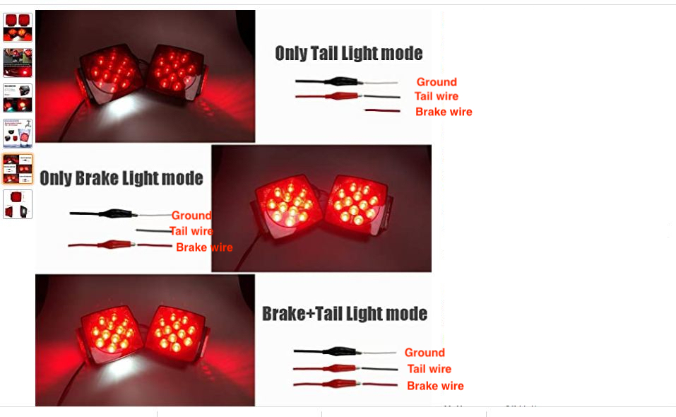

There is only one wire besides the ground wire. So the signal for all the functions has to go thru that wire. Right?
Also on LED trailer lights I think it is the number of LED's that are lit to distinguish between the various functions. (dim and bright, blinking etc)
I understand the seperate filaments in incandescent lights but, again, how the signal for seperate filaments is sent thru the one wire. (different voltage?)

Yes, four wires at the connector. White is common or ground, brown is running (tail) lights, yellow is left side flashing and green is right flashing. My trailer harness has just the two wires going to each light.
I see 3 on those units in the amazon picture. White is gnd, low brightness is the brown on your connector (running), high brightness is the green or yellow on your connector (turn/flash/brake)
/ Trailer Lights Gurus--Got a Question. #88
Another concern is there are two other colored wires in addition to the white wire on each light. The diagram below shows the two colored wires attached to seperate leads. My trailer just has the white wire on each side plus a colored wire so I spliced the two colored wires of the light together with the colored trailer wire at each light location. Maybe this is incorrect but not sure how else one would do it.
Hook the Brown wire to the Black wire on the LEDs. This is your 'running lights'.
Hook the Yellow wire to the Left LED's Red wire. This is your Left Stop/Turn.
Hook the Green wire to the Right Led's Red wire, this is your Right Stop/Turn.
White wires from all lights then go to ground, either chassis (can be via mounting bolt. On your LEDs its a White wire.) or directly to the white wire on the plug (preferred).

/ Trailer Lights Gurus--Got a Question. #93
Here is one of your pictures labeled. You must have one wire for tail and one wire for stop-turn. Ground may be a wire to the trailer connector (Best) or a wire to the mounting bolt if the bolt isn't grounded (Not as reliable).
Bruce
#94
Bruce
Thanks. I will give that a try. I guess the confusing part is the white wire on the trailer harness at each light location. This, to me, is ground or neutral but your comment earlier leads me to believe that the wire wire is actually is a substitute for brown for the tail lights. (running light) Then the second wire (black in my case) of the trailer harness would go to the yellow wire on the left side and green on the right side.
#96
Thanks, will try that.
That fixed it! Everything works as it should. (even without the pickup lights turned on:))
The old lights only having two wires, a white and a black, and the wiring harness having a white and a black also made perfect sense that one of them was a ground. Right? No, wrong. The light mounting studs were the ground to the trailer chassis, I guess.
Not sure why the new LED's have a grounding wire instead of thru the mounting bolts. Maybe just because they are LED technology. (I did connect the white wires to the trailer chassis)
I should have figured this out a lot sooner but just needed some help from you guys.
Thanks again!
