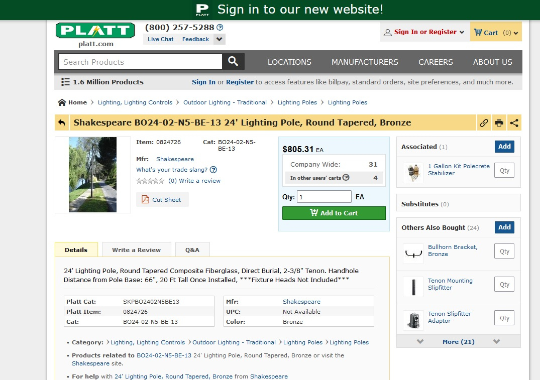

I purchased some solar LED 300W street lights to place along my driveway. What I did not think of was how to get a post to mount them to. I saw some Youtube videos where people tried 4x4 posts and they said that a 16' 4x4 stuck 3' into the ground with concrete swayed like the dickens in wind with these lights mounted.
I have tried Amazon and Google to find say 12'-18' steel posts, but my fail has been consistent and enduring.
Do any of you folks have an idea for an affordable and functional street light posts?

Since when have you cared about $$$? What about flag poles of some sort?

I looked up a few flagpoles yesterday, but the fifteen or twenty foot aluminum ones that looked stable enough for a ten pound lamp head were hundreds of dollars each.
/ How to make a 12' to 15' light post? #24
If you go the fence co. route, try and get CQ-20 or DQ-40 2 3/8" tubing. It has a higher tensile strength; it will spring around in the wind but will always retain its shape. When it does fail, it does it rather spectacularly rather than just bending, but for a light pole I'd bet the light would fail first.
Plus, it's easily weldable so you can scab rems to the bottom to make up depth, or even do a 2.375-1.875 split to save on material costs, depending on how many posts and the height.
