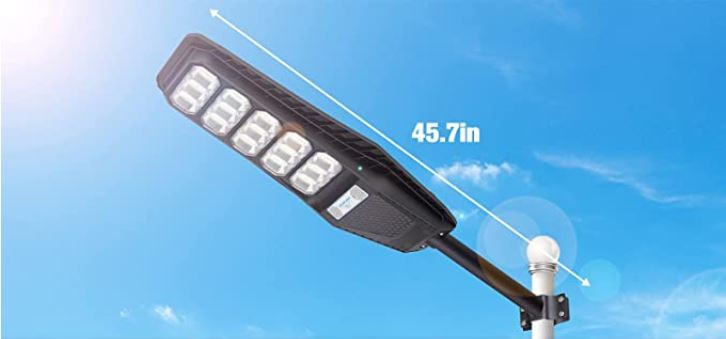

I purchased some solar LED 300W street lights to place along my driveway. What I did not think of was how to get a post to mount them to. I saw some Youtube videos where people tried 4x4 posts and they said that a 16' 4x4 stuck 3' into the ground with concrete swayed like the dickens in wind with these lights mounted.
I have tried Amazon and Google to find say 12'-18' steel posts, but my fail has been consistent and enduring.
Do any of you folks have an idea for an affordable and functional street light posts?
The lights I ordered:
300W Solar Street Light, 2 Light Set Motion Sensor Dusk to Dawn 15000LM Solar Lights Outdoor with Remote Control
