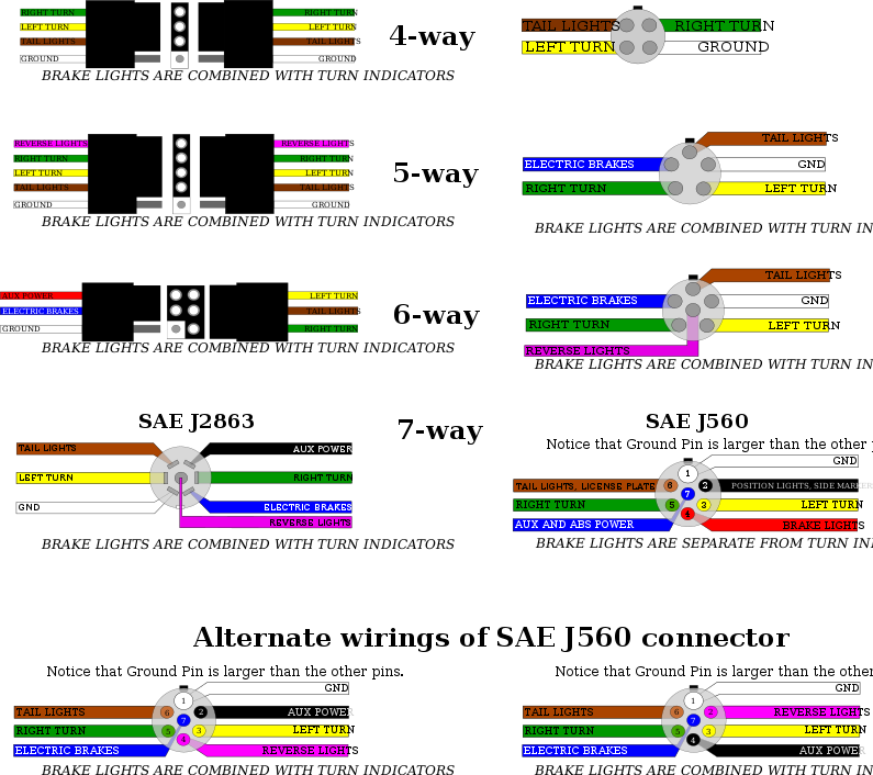

You know, guys, the trailer brake actuator is not on the truck. The trailer brake controller is on the truck. The thing that actuates the brakes is on the trailer. If it wasn't, the trailer would have no brakes if it broke away.
The magnet in the brake assembly controls the actuator arm in the brake that applies pressure to the shoes that grab the drum. It gets the voltage from the brake controller in the cab. Brake controller, not actuator. Controller.
And to add a little bit more to that...
