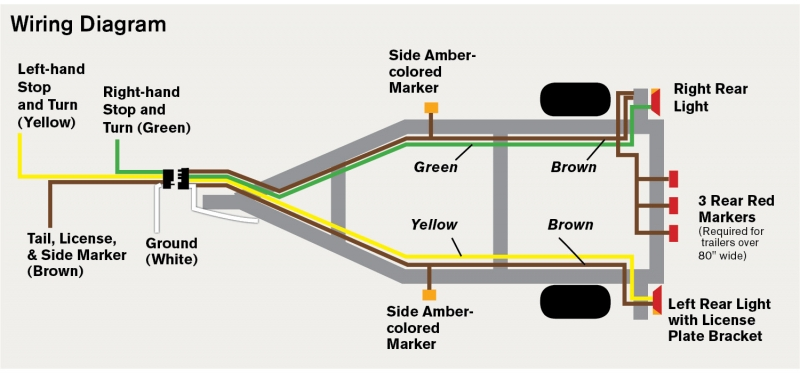

Another concern is there are two other colored wires in addition to the white wire on each light. The diagram below shows the two colored wires attached to seperate leads. My trailer just has the white wire on each side plus a colored wire so I spliced the two colored wires of the light together with the colored trailer wire at each light location. Maybe this is incorrect but not sure how else one would do it.

Not same wire. Brown is running lights on 1 filament in the bulb. Green or yellow is the blink signal through 2nd filament in the bulb.

you should have 3 wires, a ground, a stop lamp and a signal lamp( constant on for brakes, and on/off flashing for turn signal. connecting the brake and signal lamp wires would probably make things act strangely with the led drivers in the tail lights.
same as you have a left signal, right signal, and running light wire and ground at the plug.
There is only one wire besides the ground wire. So the signal for all the functions has to go thru that wire. Right?
Also on LED trailer lights I think it is the number of LED's that are lit to distinguish between the various functions. (dim and bright, blinking etc)
I understand the seperate filaments in incandescent lights but, again, how the signal for seperate filaments is sent thru the one wire. (different voltage?)

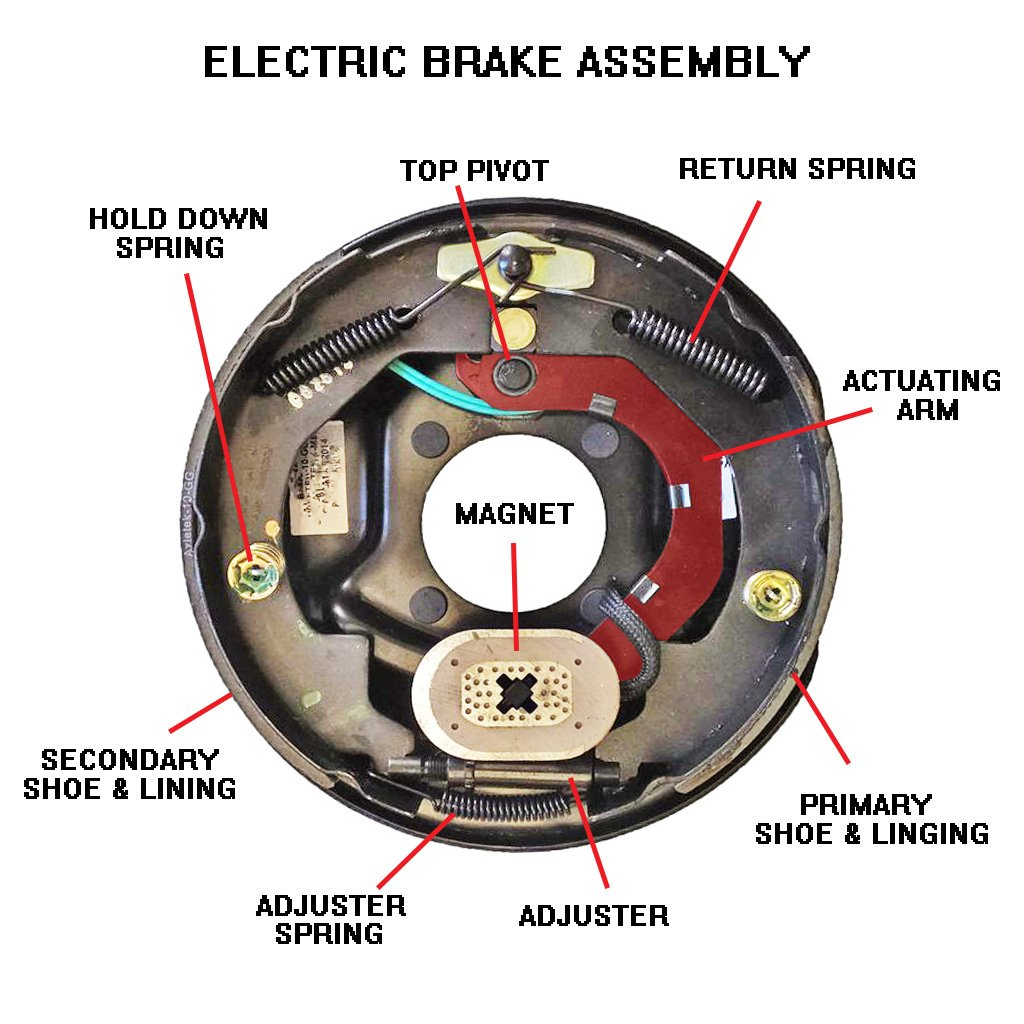

You know, guys, the trailer brake actuator is not on the truck. The trailer brake controller is on the truck. The thing that actuates the brakes is on the trailer. If it wasn't, the trailer would have no brakes if it broke away.
The magnet in the brake assembly controls the actuator arm in the brake that applies pressure to the shoes that grab the drum. It gets the voltage from the brake controller in the cab. Brake controller, not actuator. Controller.

But the trailer harness has always had just two wires to each light. (white ground and one colored) This worked fine with the old incandescent type.
