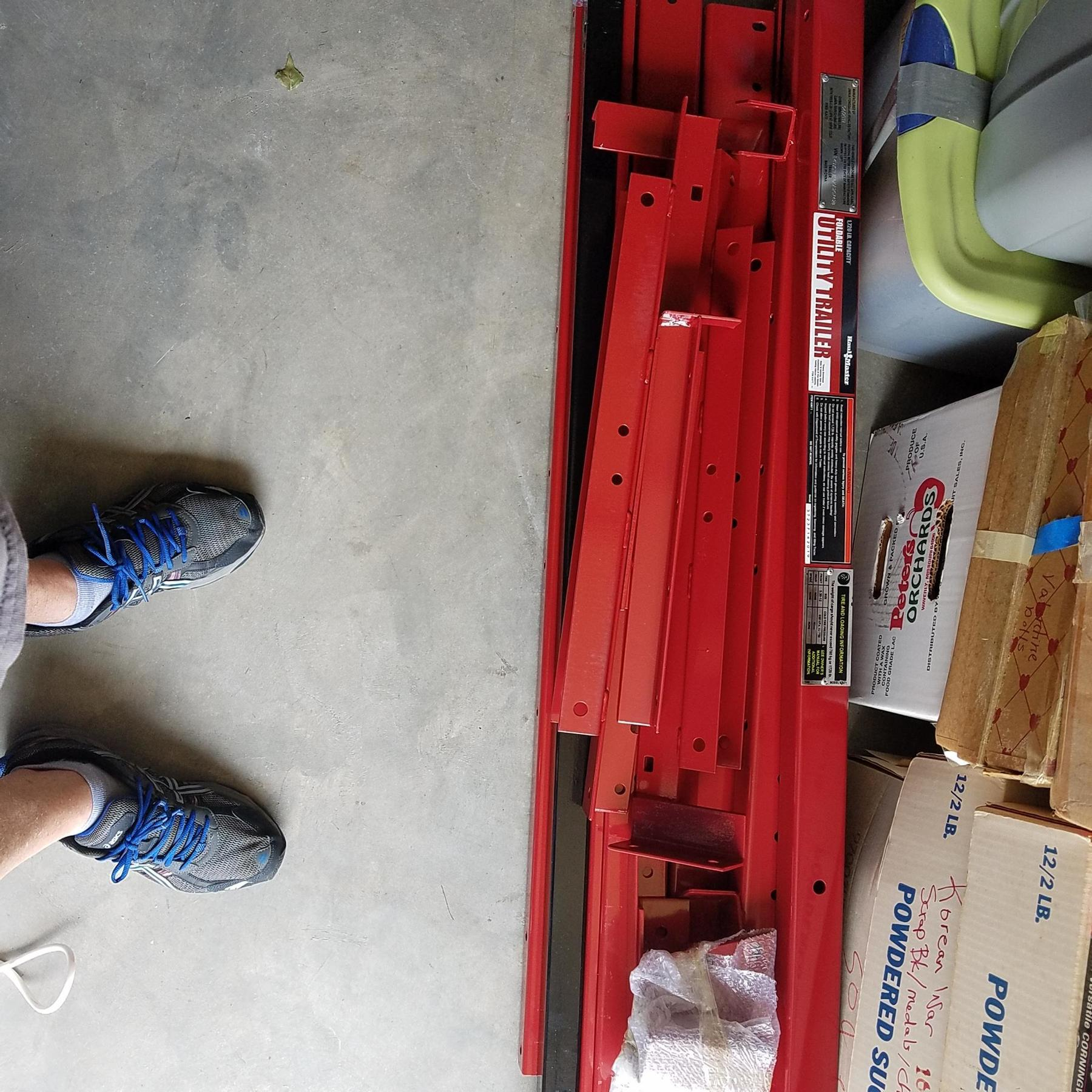

I agree with that, but it doesn't solve the problem with all the frame parts being painted. You'd also need to replace all the flat washers that come with the kit with star washers and even then I would not be 100% sure of all the connections. It may work fine on a trailer that has been welded together before painting. This is a picture of the frame parts in this kit, not mine, it is one I stole off of harbor freight. With all of this paint the wiring kit should really have a ground wire to run to all of the lights, but then again, it's not so expensive that I'm worried about replacing their wire with my own.
/ Trailer Lights Gurus--Got a Question. #114
Agree, connecting all the grounds together is better in the long run. I connect to the frame and connect them all together. Mainly because the lights are usually attached to the frame when I get the trailer anyways, so just easier to add wire and terminal and connect them all. Many paths to ground is a good thing.
