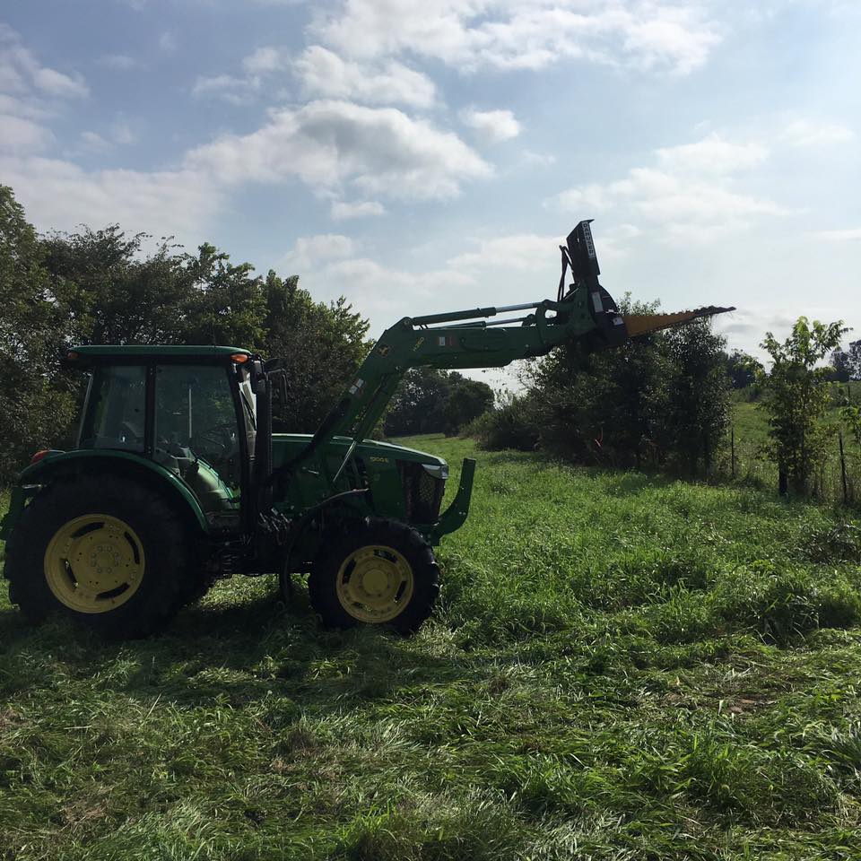

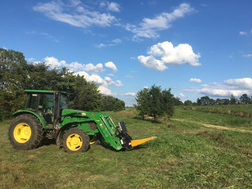

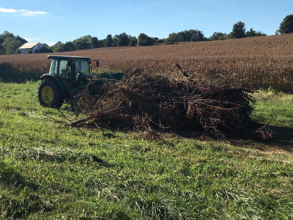

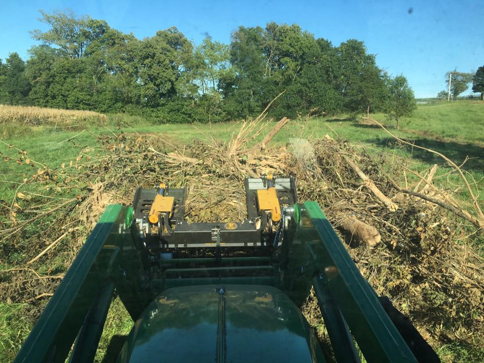

I have become beset with grapple envy.
I've tried to follow the "how big" and read some like it small, others like it big.
This is why the 72" is such a good fit for larger tractors. It wouldve been difficult carrying the stump mainly but it was nice having the width for the long logs also. The stump was enough to get my 9500lb+ tractor light in the rear. The BB is only about 1k and I have loaded rears.
Brett
<snip the pic>
(How did he get a 9500lb tractor? tractordata.com lists it at 5500 lbs, do loaded tires, cab and FEL add 4k lbs?)
