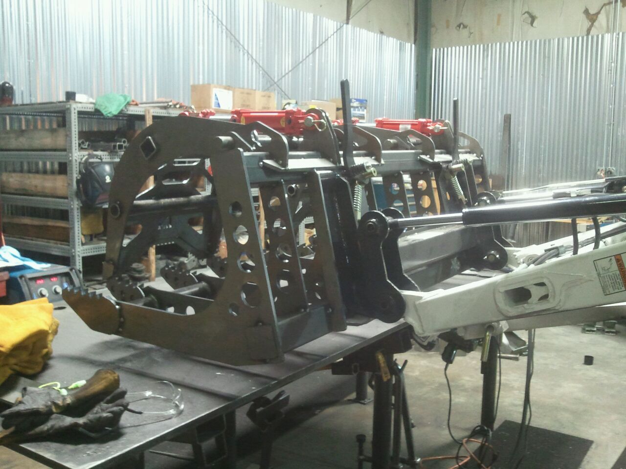

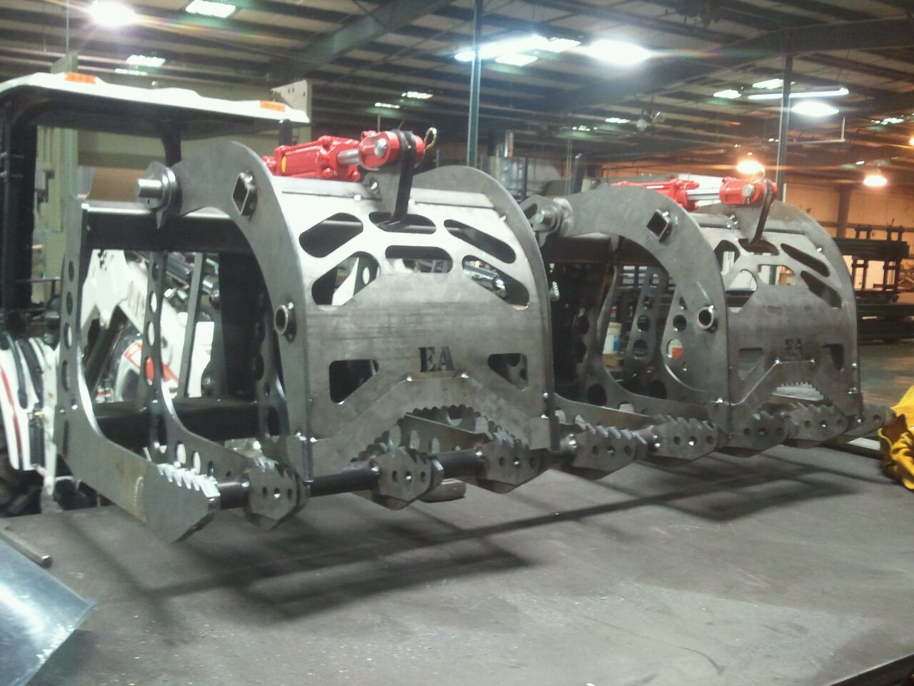

The owner Ted here at Everything Attachments used to race with his dad's money before he had to make his own. In racing, he learned how to make things strong and light and used that knowledge when he designed and built our new WICKED compact root grapple. Ted has used all the equipment that we sell and make at some time in his life and the thing he hated about compact root grapples and some other compact front loader attachments is the weight. Attachments on the back of the tractor, lots of times, depend on weight since there's no down force however anything on the front of the tractor that is not absolutely necessary is just dead weight. We're using a special steel not used in this industry very often. Average steel has a yield strength of 36,000 pounds. The steel we're using in this grapple to make it light and strong is a minimum of 80,000 pound yield strength. The cost is double but the results are great!! The grapple you see in the picture was taken with a cell phone(pardon the quality). Over Christmas vacation, it was used over 30 hours by Ted clearing a new lot.
The following is straight from Ted:
I did everything I could do to stress test this new design. I think anything can be torn up if you don't know how to use something properly but I tried almost everything and wasn't able to hurt it. It was also a pleasure not having that extra 100 pounds from the grapple I was using the day before. One of my friends rode by that knew me from the old days and the first thing out of his mouth after he knew I designed and built the grapple were...... "You've Race Car'ed it!!!" and I replied with a huge smile because he was right on the money!! The only other way to make a grapple lighter is to use 2 piece tines which are much cheaper and not near as strong. This was a 66" grapple, hoses, couplers and cylinders...complete....408 pounds. I went from 3/8" tines to 5/16" using 80,000 yield strength steel then laminated(with a small gusset at the end) the tips with 3/16" making it go thru the ground with just little grooves. The large gussets you see on other grapples make it much harder to push thru the ground when trying to get the roots and results in a lot more unwanted damage to the turf. Using our new laser, cutting the circular holes out of the tines alone reduced the weight by 38 pounds without reducing its strength and function whatsoever. The holes have to be cut with a laser instead of a plasma because the heat created from the plasma with the holes this close together will warp the tine. Also, we are able to put razor sharp teeth on the end which makes everything stay in the grapple much better and adds to it's wickedness. The outer tines are 3/8" and we did many other things that we will highlight in the video as soon as we get one painted for sell. Actually, I've already sold a couple over the phone with the attached pictures for delivery after New Years.
The BEST THING......they will cost you less than the root grapples that we're selling now from my brother's company @ Construction Attachments.
We can't wait to show you the video soon and point out the other design changes on what is sure to be the most revolutionary root grapple to date!! It is a superior design with a huge emphasis on strength and weight.

Ted is excited about this thing to say the least. He wanted me to add that he is looking forward to designing many more loader attachments using the same principles as this grapple. Superior design with strength and weight in mind!!

I see why you call them wicked, the name fits. Industrial looking cylinders if they make it into final production that way. I have seen the serrated tips before, I assume for gripping and pulling. I always worried that they would also cling to the load when you are trying to release, but maybe not. Depends on what you would be grappling I guess. All those holes would sure save weight if the added machining coats were not too much.

I would also be concerned with serrated tips for the same reason as above, maybe consider optional tips without ? Otherwise, I'm sold, unit looks awesome ! Please keep the forum updated on availability and pricing as you are able to...

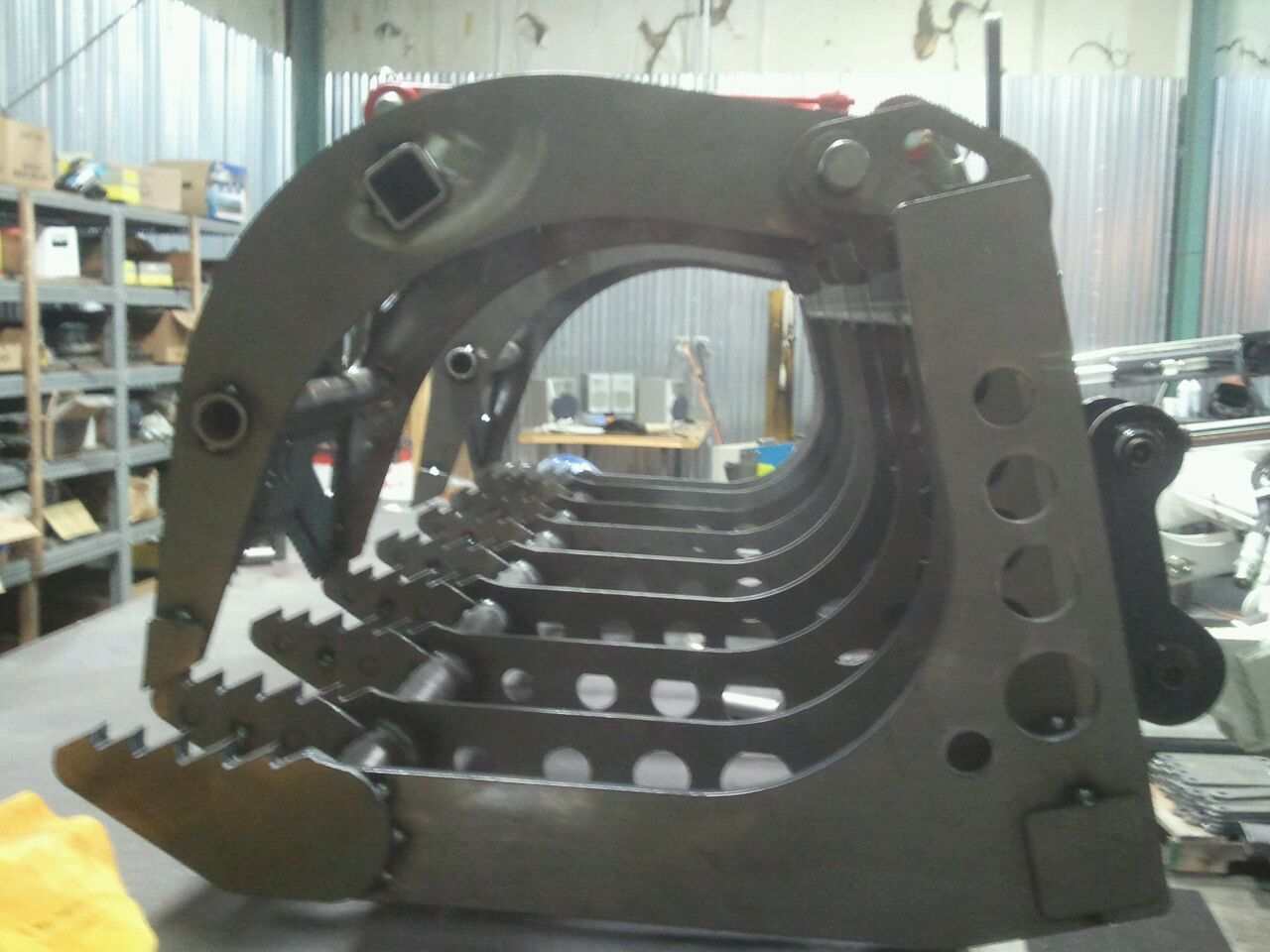

Since A36 steel has a minimum yield strength of 36,000 psi and
A514 /T1 steel has a yield strength of 100,000 psi.
Are you using A656 Grade 80 or some other steel to get your 80,000psi yield?
I have read where many of the manufacturers are using at least A514. A couple even higher yield strength. From the picture your tines seem very short before the cross support. Is that true or is it the picture that makes it look that way?

I see why you call them wicked, the name fits. I have seen the serrated tips before, I assume for gripping and pulling. I always worried that they would also cling to the load when you are trying to release, but maybe not. Depends on what you would be grappling I guess.
Ted said the sharp tines are awesome for gripping. He didn't have any problems unloading the grapple and says there's no way he'd trade it for the smooth tip grapple he was previously using. For picking material up, the leading edge of the tips are rounded so they allow the larger logs/material to roll right over them.
I can tell you've done your homework. We are using Grade 80 for a couple different reasons.
A main reason for choosing Grade 80 is that it is plenty strong for this application and anything more, we believe, would unnecessarily inflate the cost.
None of our suppliers have T1 steel available under 1/2".
T1 steel is a lot more temperamental to machine and weld than what we are using.
The low quality cell phone photos may be making the tines look short but they're really not. We'll have some high quality pics on the website in the near future.(and a video)
