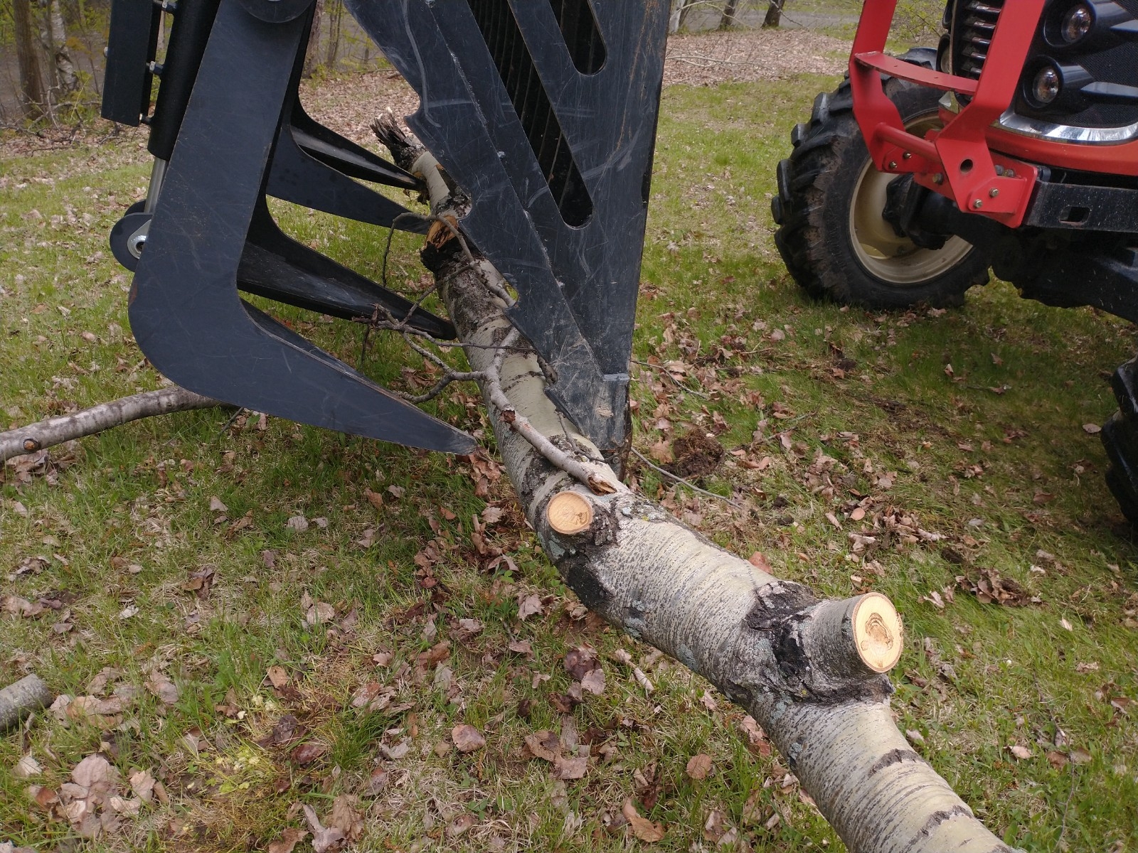

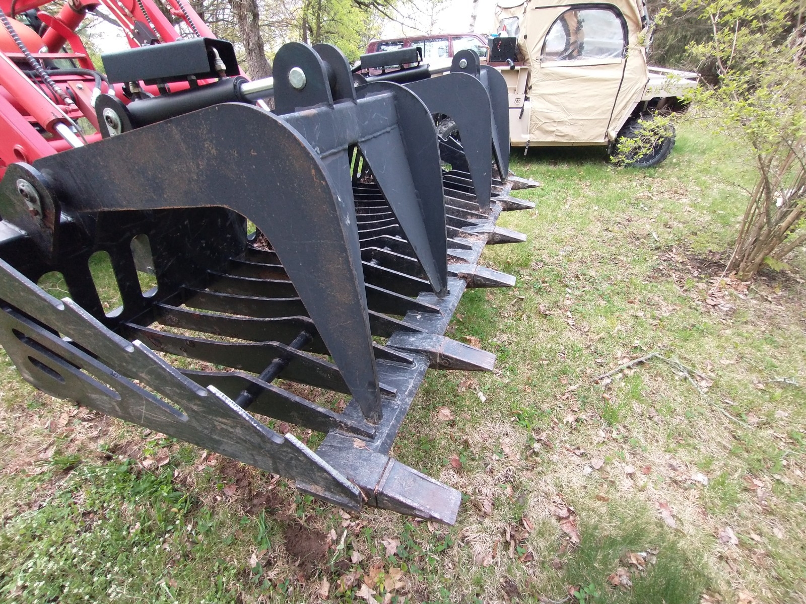

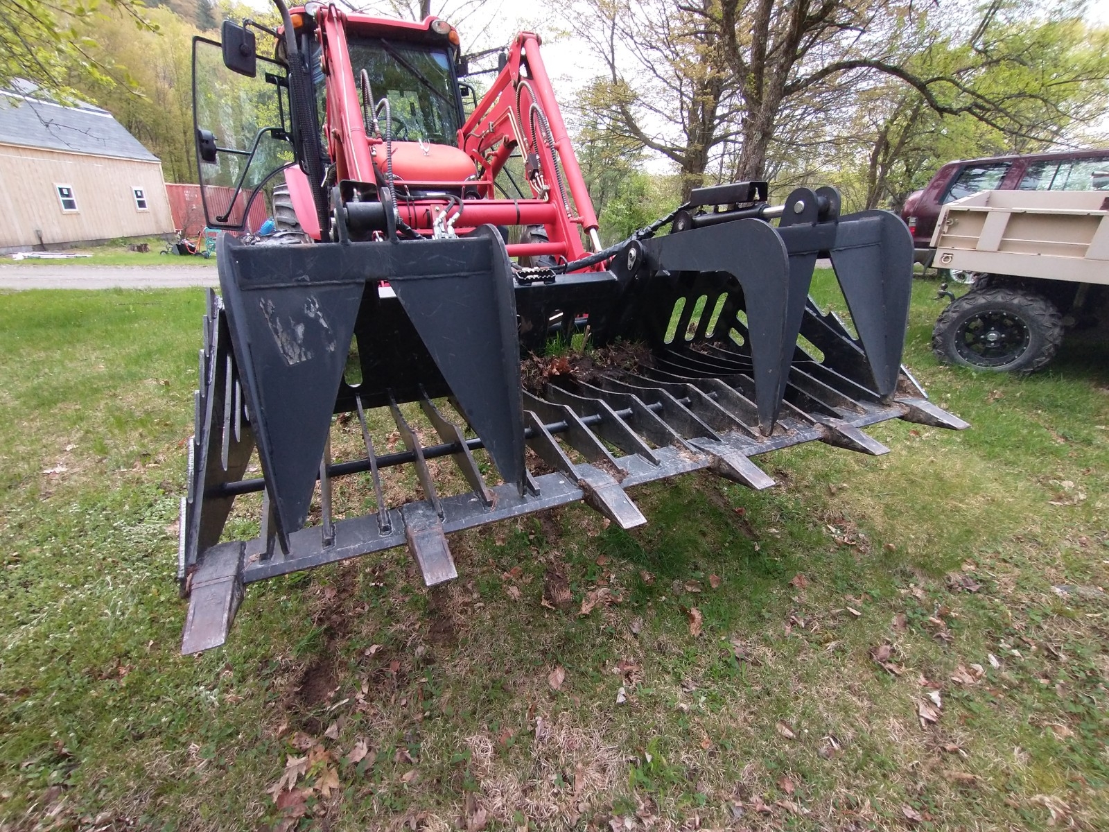

Here are a few pictures of my grapple;
You can see in these pics how far ahead of the grapple clamps the teeth are;
To grasp a log or pile of brush the grapple has to be rotated all the way down and back towards the tractor for the grapple clamps to be able to grasp any item. If you are pushing up against something trees or what ever to push material back into the bucket you can get a decent load otherwise it is a pain.
/ Brush Grapple vs Root Rake Grapple #17
You've got a rock grapple, if you want to pickup limb you need a root grapple or debrie grapple. Rock grapples are much heavier due to more support for heavy rocks and debrie. If you're digging these are heavier but beware you need to watch your cylinders. That first picture you have you cylinder fully extended and it you hit something you'll break or bust the stops. It take some experience to properly use each type grapple. A clam grapple with easily grab but it takes more hydraulic pressure for the lid to hold. A debrie grapple you slide the bottom of the unit on a flat plane into the debrie and most of the work is in the lift. The claws keep the material from pulling back out of the bucket. Personally I don't like your unit unless you are clearing a field of stones and such and it would be great.

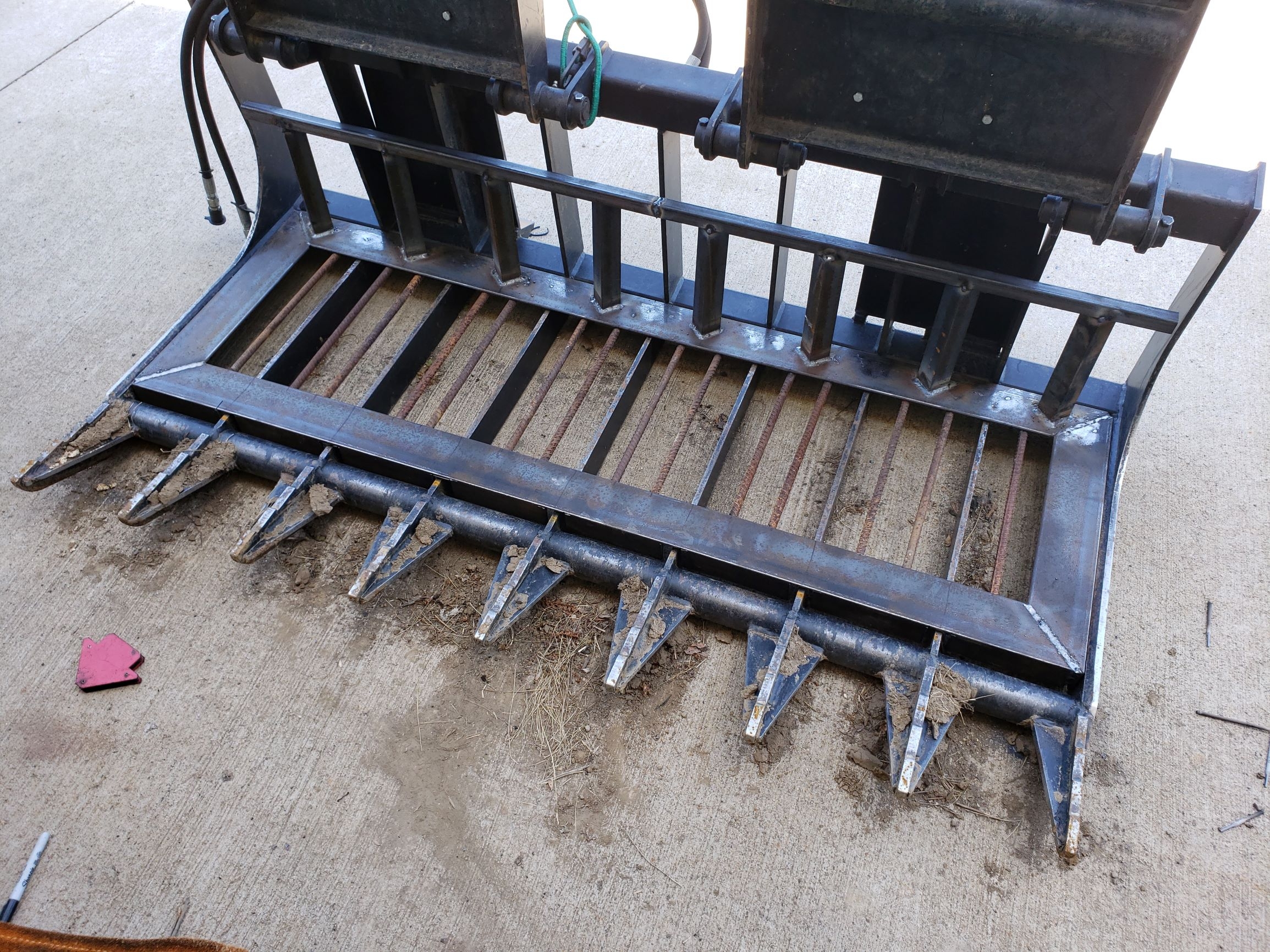

That design looks more like a skeleton bucket with a lid to me.
This is how mine is shaped. It's got big holes so not great for rocks at all. The sides are open though so it dosnt squeeze logs out.

I went with a Land Pride rock and root grapple. I bought it nine years ago and had the dealer install it and a WR Long 3rd function valve kit. I move large chunks of pine tree trunk & large rocks. I also use it to gather and move brush and pine tree trimmings. It's a Land Pride - SGC1560. It's a very HD grapple - 820# of AR400 steel.
In my operations, I have no need for long bottom tines and I wanted a single top lid. It has become one of my most used implements and has never failed to work.
