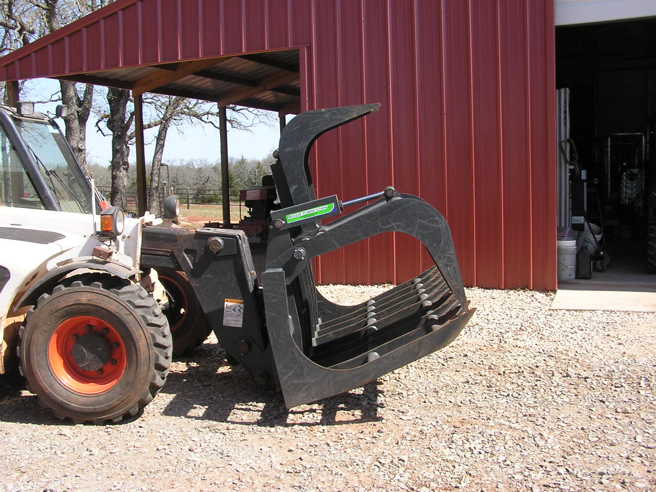

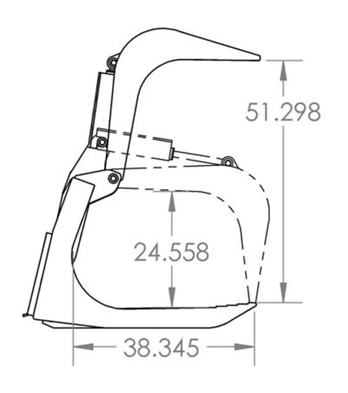

There are several of our Wicked Grapples out there on skid steers with no damage reported, but we really do not recommend it.
We'll be working on our new, heavier Wicked Grapple for utility tractors in the next few weeks. It will be more suitable for a skid steer.
Ted plans to keep it at or below 600 pounds, which is MUCH more manageable than many of the 700-800 pound+ steel anchors currently on the market!
Travis
Increasing the opening more than 37" too?
   / The WICKED Root & Debris GRAPPLE!!!!!!!
#604
Yes, since the compact geometry will not be crucial like it is with the compact models, the tines will be extended forward more. This will definitely create a larger opening.
It's not going to be normal, you know.....we promise it'll be WICKED!!
I plan to share the step by step build process like I did with the Wicked original. :thumbsup:
Travis
Travis

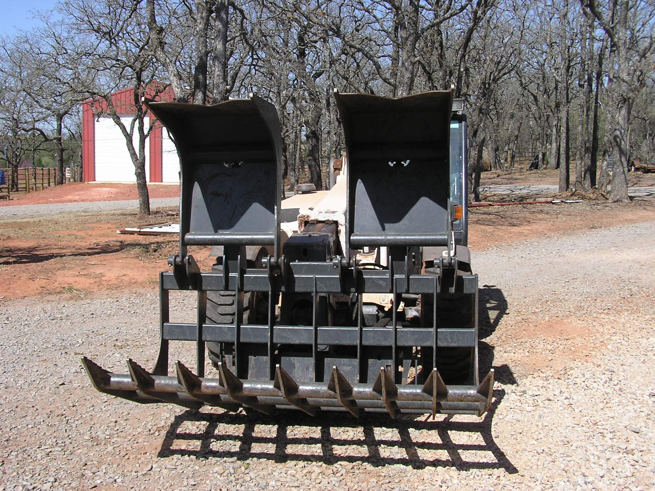

Will it open wider than mine?
#610
I said Wicked, not outlandish freak of nature!! :laughing: I kid.
It probably won't be very far from it though.
Travis
