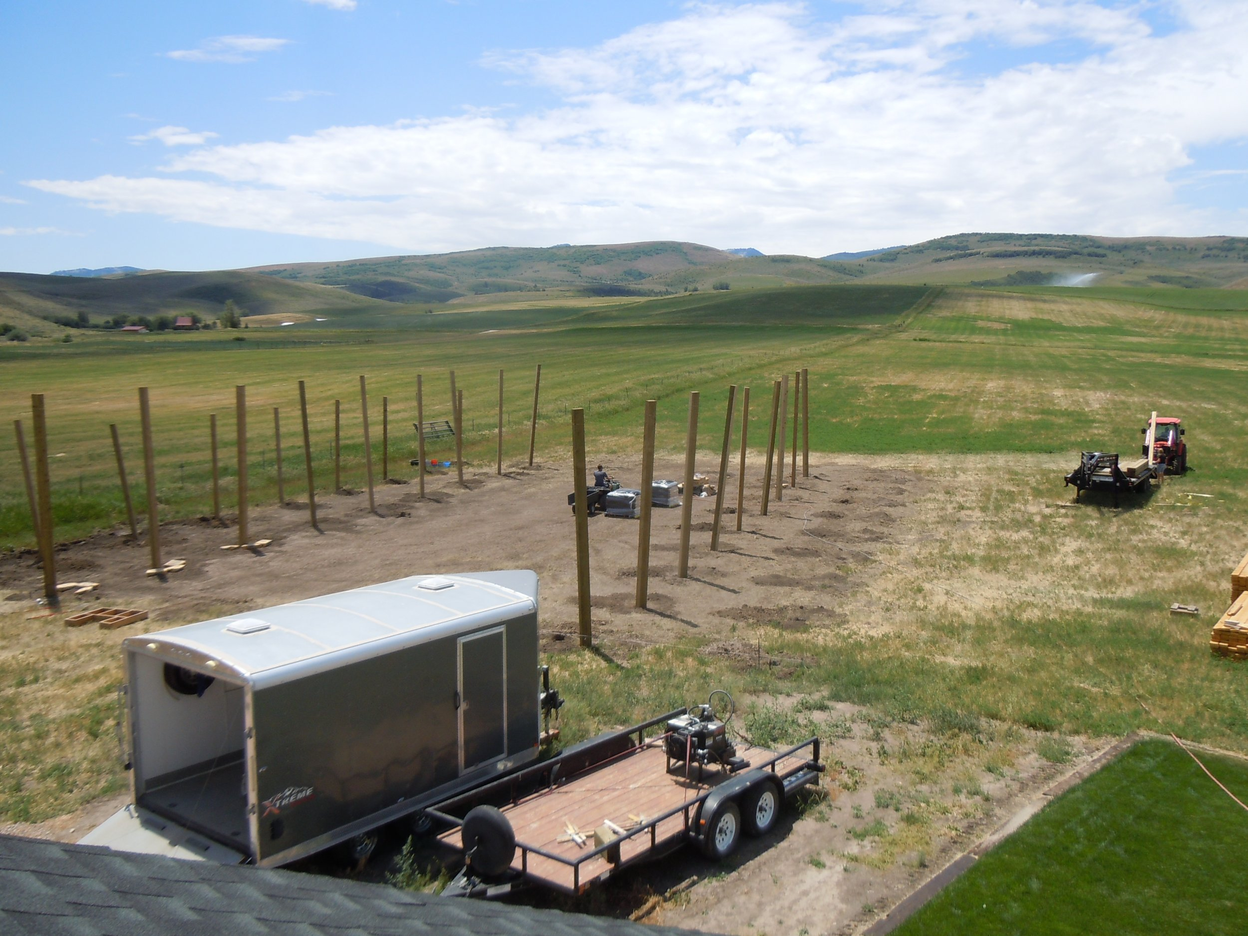

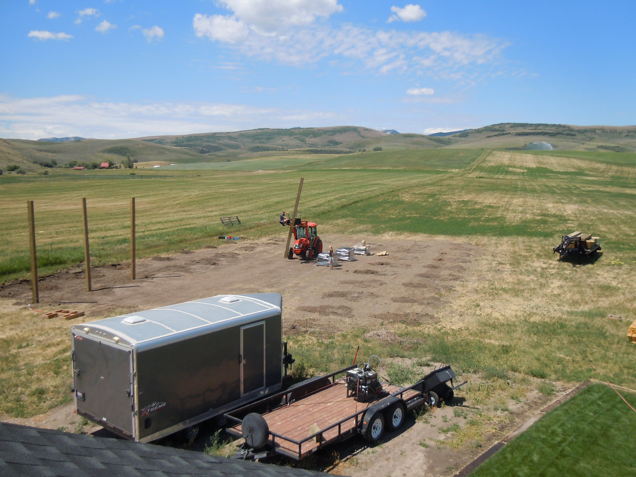

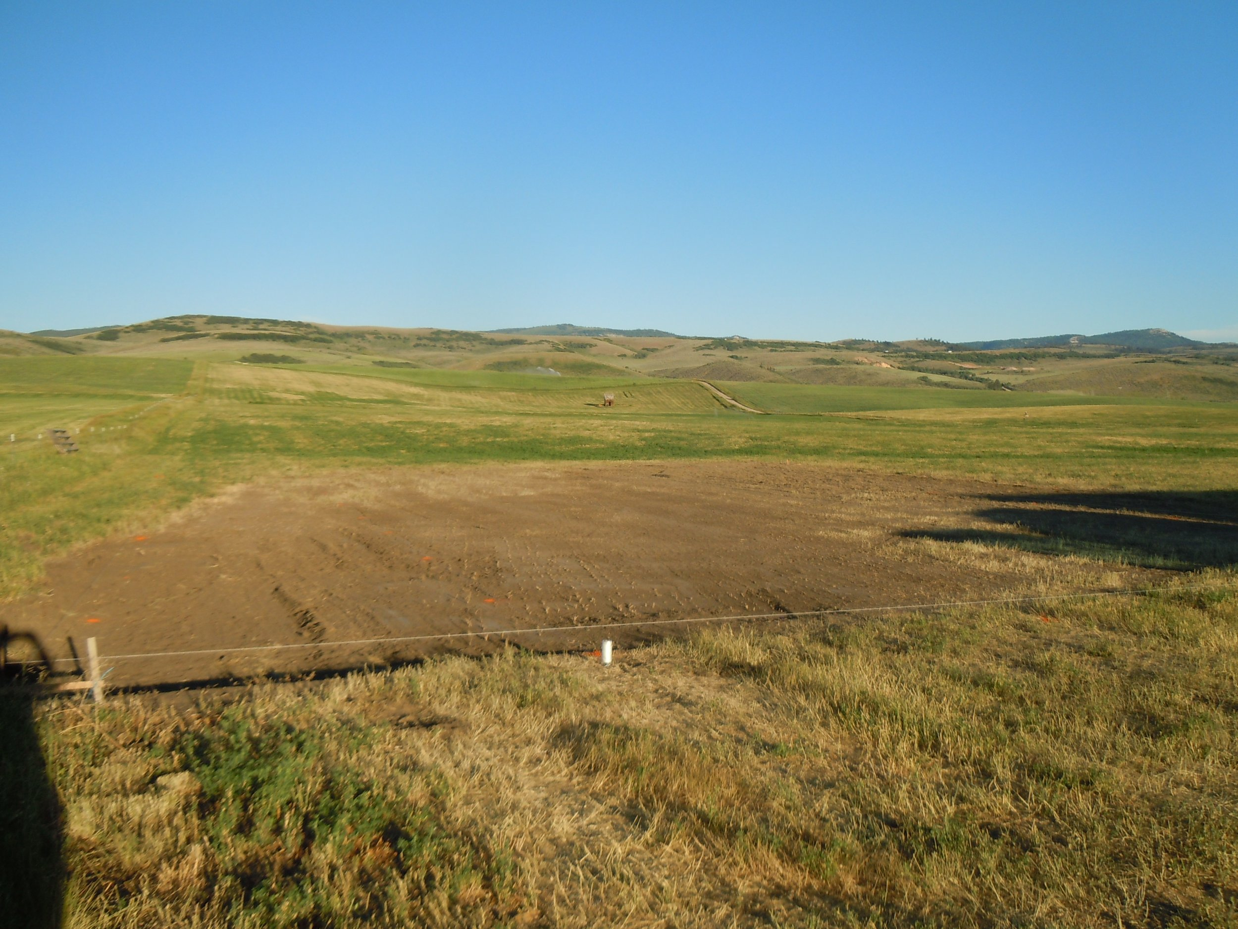

Pictures will be slow coming I'm still trying to resize everything. Here's a start though. I held off building in 2020 because of covid, that was a mistake! It cost much more in 2021 than it should have but I was tired of having all my stuff out in the weather.
The Barn is 70'X96'X13'.

Looks like you are using the OSHA approved method of placing poles. 😃
I am impressed. That is a rather large building under the build-it-yourself category. I follow the price of OSB just as a general indicator of lumber prices and the price is about triple what it should be and was back in September October.

No doubt pole placement is OSHA approved.;)
Putting these up are not all that hard but takes the right equipment for sure. My wife and I did most of the work; My sons helped set the post and I had help raising the trusses and putting metal on the roof. I also hired out the concrete work.
After starting the work my body hurt for days but I finally got used to work. LOL
It took us 2 months to get all the framing and metal on the building. Not bad for a guy and his bride. I'm 59 wife is a little younger. We had to wait for some of the metal and big doors but it was closed in and usable in 4-5 months.
I am retired so we worked every day but Sunday from sunup to sundown. (also lost about 20 pounds)

I'll be 71 in a few months. Between arthritis in the shoulders and some in the hips plus a fear of heights I will have to limit my work to ground level. I still have to re-fence and cross fence the property this summer, that will be work enough. When I did it on the previous property the pounds melted off, but they seem to have a way of finding me again during the winter. Hope to get started when the frost is out of the ground.

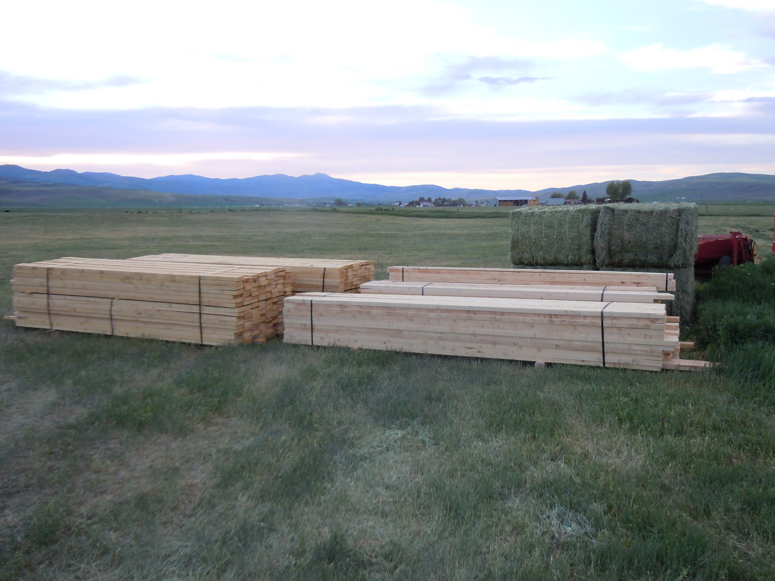

View attachment 734526View attachment 734527View attachment 734528View attachment 734529
I was looking at your lumber and wondering if it was custom milled or from a lumber yard. I was curious because it didn't look like it's all cut to a set a length and doesn't appear to be S4S or have a bullnosed edge.
It is rough cut lumber right from the saw mill. Supposed to be true 2X6 not all were that big.:mad:
Post also, the saw mill pressure treats the post.
