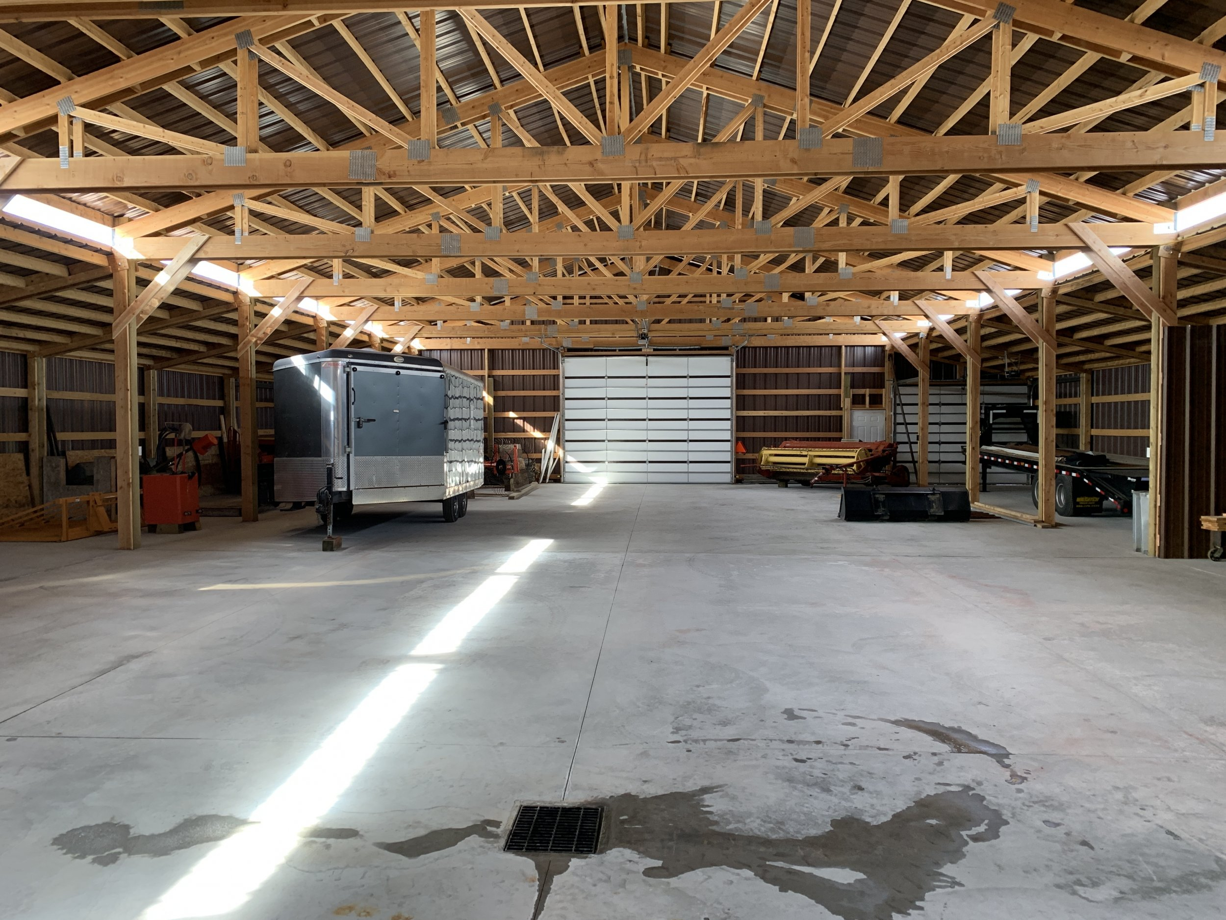

In my opinion, the term vapor barrier is misleading. People seem to think that water in the ground is turning into vapor somewhere under their building, and then that vapor works it's way up through the ground, and then through 4 inches or more of concrete. Then it turns into water and puddles up on top of the concrete.
Vapor barrier, or plastic, is important under a slab when pouring the concrete is the soil draws out the moisture in the mix while pouring the concrete. If your soil does not do this, there is no need for the plastic.

For the low price of some basic plastic sheeting, I don't know why you wouldn't put it under your slabs, though.
Concrete is not perfectly impermeable. It can and does wick moisture. Why do people apply waterproofing on the outside of a poured basement wall? It's exactly the same with your slab. That being said, if you have perfect drainage away from your building/pad, your soil under the building shouldn't be a swamp that is trying to send moisture inside. So it might work out fine for you, sure, but for a couple hundred bucks of plastic.... peace of mind.

If I have enough water under my slab to saturate it and come thru my concrete a plastic film is the least of my problems.
Of all the steps involved in pouring a slab, a plastic film is at the bottom of my list.

Anything below grade is going to have pressure that is forcing water into the building. This is not the same as a concrete slab that is above grade.
Wicking happens when the bottom of the concrete is in standing water. Not vapor coming up through the dirt. Common thickness of a concrete slab is 3 1/2 inches. If you put a piece of concrete that is 3 1/2 inches thick, in a one inch puddle of water, the top of the concrete will never get wet. You might see some moisture up the sides above the water line a little bit, but nowhere near the top.
I agree that plastic is cheap. It doesn't hurt anything if somebody wants to use it. I just don't think it accomplishes anything, and I have plenty of other things to spend money on.

We have worked on buildings that had insufficient vapor barriers on the concrete floor slab. With exposed concrete or vinyl tile, it was not much of an issue, but epoxy lifted right off due to the moisture below. The buildings were all above grade, but the water table locally was high.
To @EddieWalker's point about mislabeled materials, polyethylene is not impervious to water vapor, it just slows it down. As an example, water moves through a LDPE film at the rate of 1-2gm/100 sq.in./24 hours/mil of thickness.
Water Vapor Transmission Rate
YMMV...
