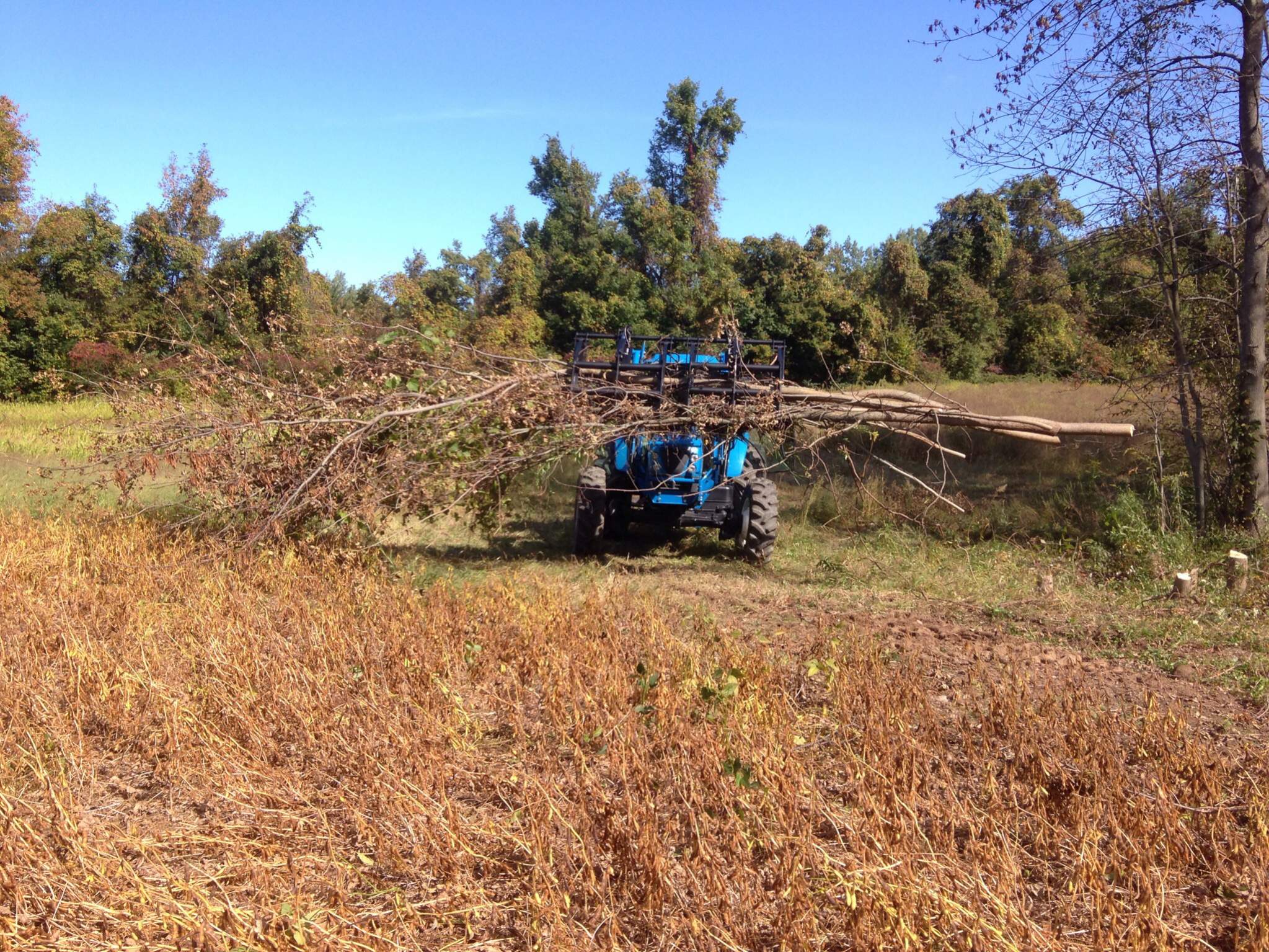

Somehow we missed the story of your customized Canopy shape?:laughing:
It looks like what a lot of us Yankees have done to ours..
Low limb, not a fallen one. That's why I did not get a cab. It also keeps the sun out of my eyes more on that side.

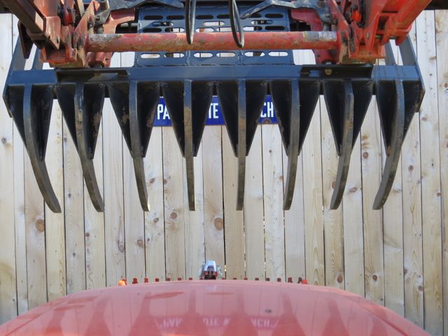

A look from the bottom and a "Wheel of Fortune" game for Ron. Category: Ranch name.

Parachute Ranch
Close enough.
You really need to get on that show! Even with the reflection I figured it at least would take you 2 hours.
Note: That is not the name of this place now. That was the sign on the front gate when we bought the place.

I have a grapple and your grapple is giving me Grapple envy, like Charlie.
Those 1 inch thick bottom tines makes it a heavy weight grapple in my mind. I only have 1/2 inch bottom tines and it is no lite weight. Your one inch tine design is exactly what I saw on that articulated forestry loader hauling longs. Let me know if you need some help trying to bend one of those tines.......or keeping the rust off!
