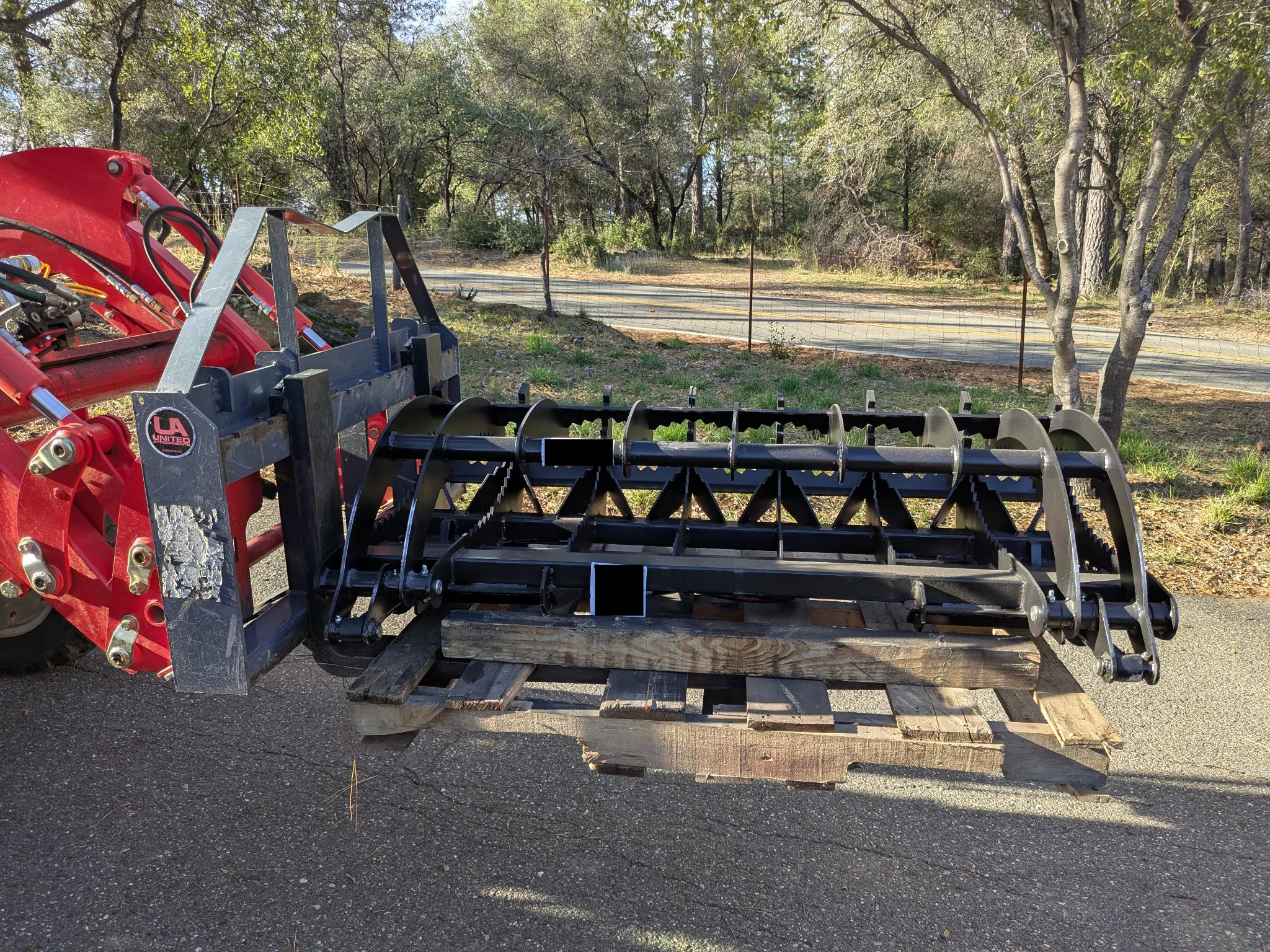

It came on a pallet - no straps

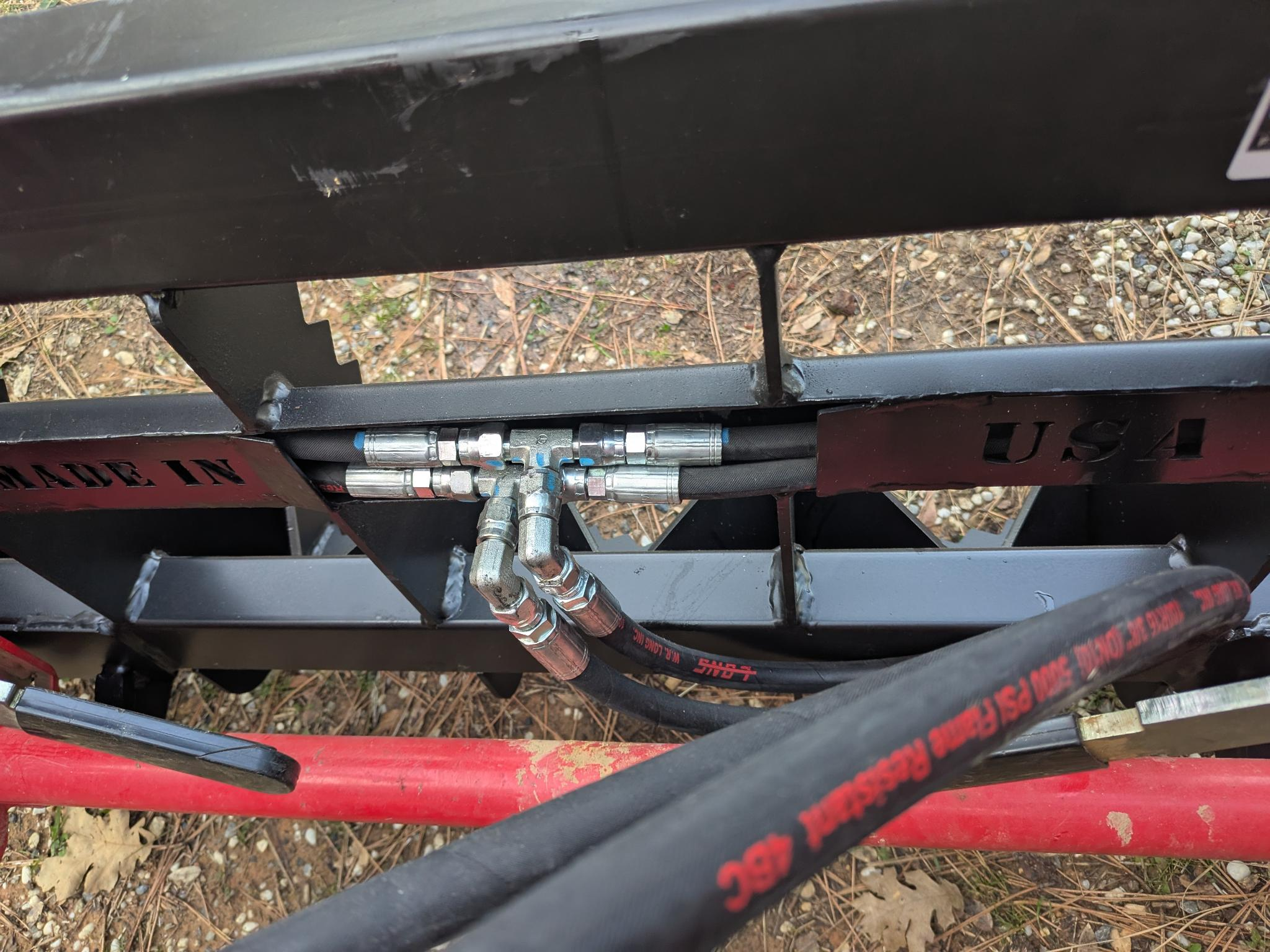

The hydraulic cylinders are tucked nicely behind the bottom on the outside; the hoses are routed through a middle rectangular tube and come out at the middle (hoses had zip ties for transit)

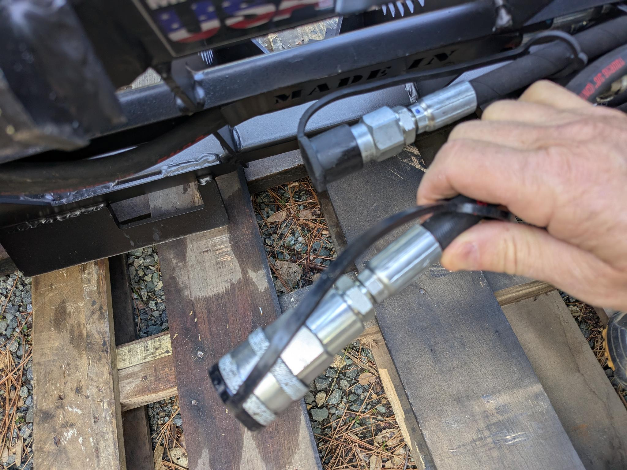

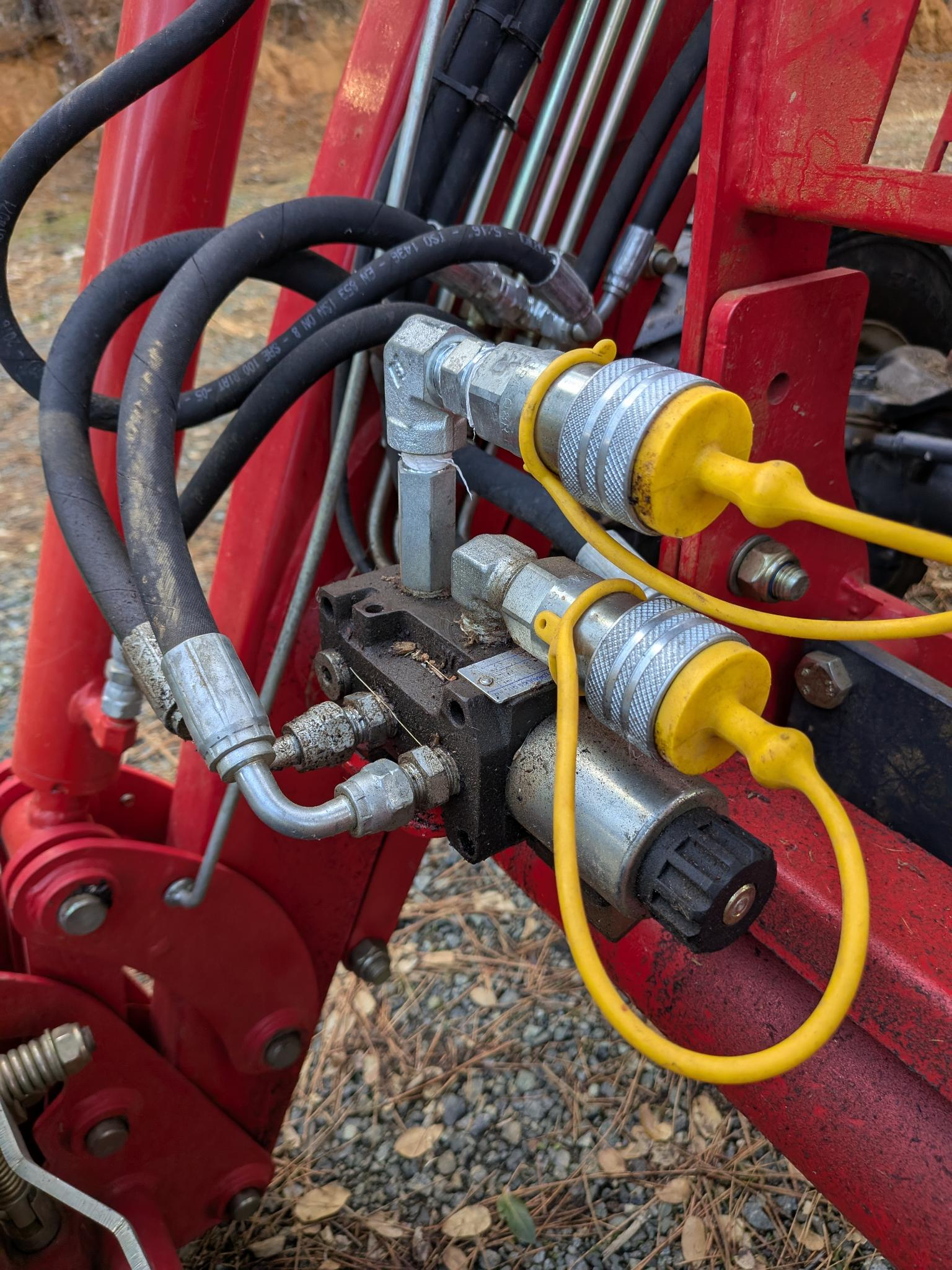

It came with one male and one female connector
I'd specified connectors when I ordered, but I suspect that the guy at the feed store who played intermediary probably didn't pass that along to WRL as my diverter has two F's:

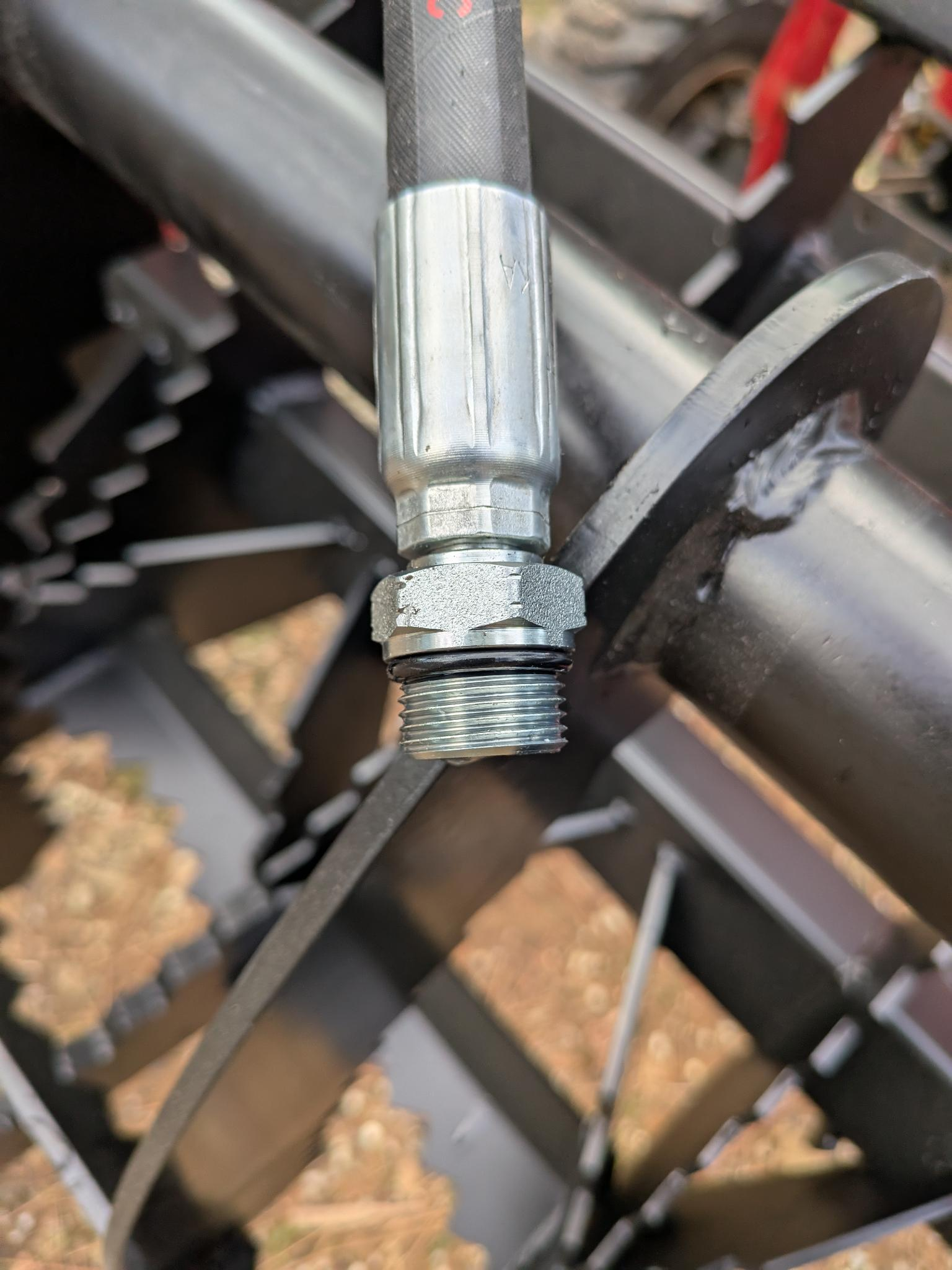

I scavenged a M NPT connector from my pressure gauge rig and swapped it for one of the F's on my diverter, as the grapple came with not-NPT threads and I just had to connect it immediately
and besides, keeping things M/F ensures that I hook it up consistently, unlike my TNT in the rear, which I still have yet to label so I relearn it every time I use it.

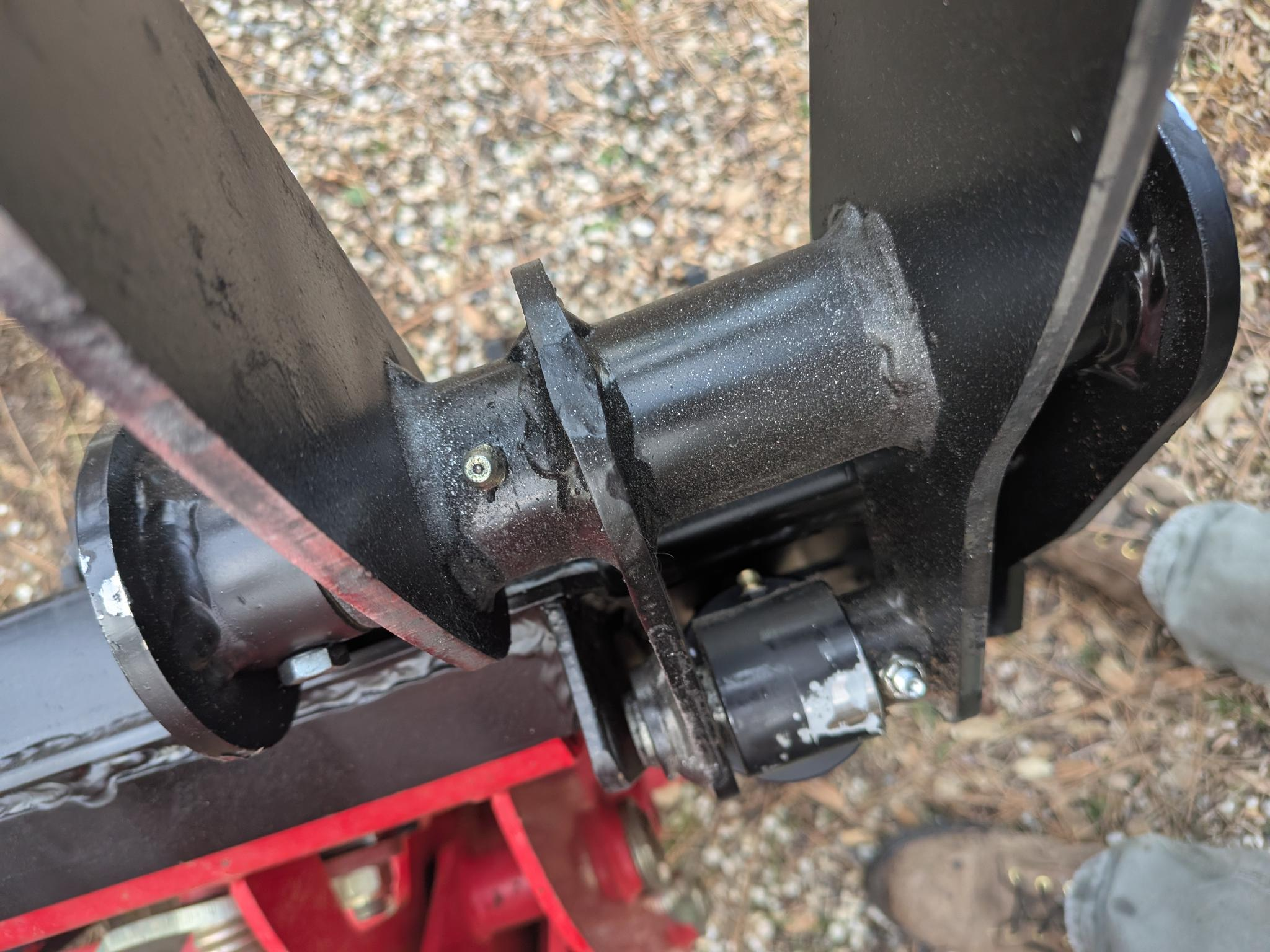

Lost a little paint in transit here and there
but I suspect it'll lose even more paint soon enough.

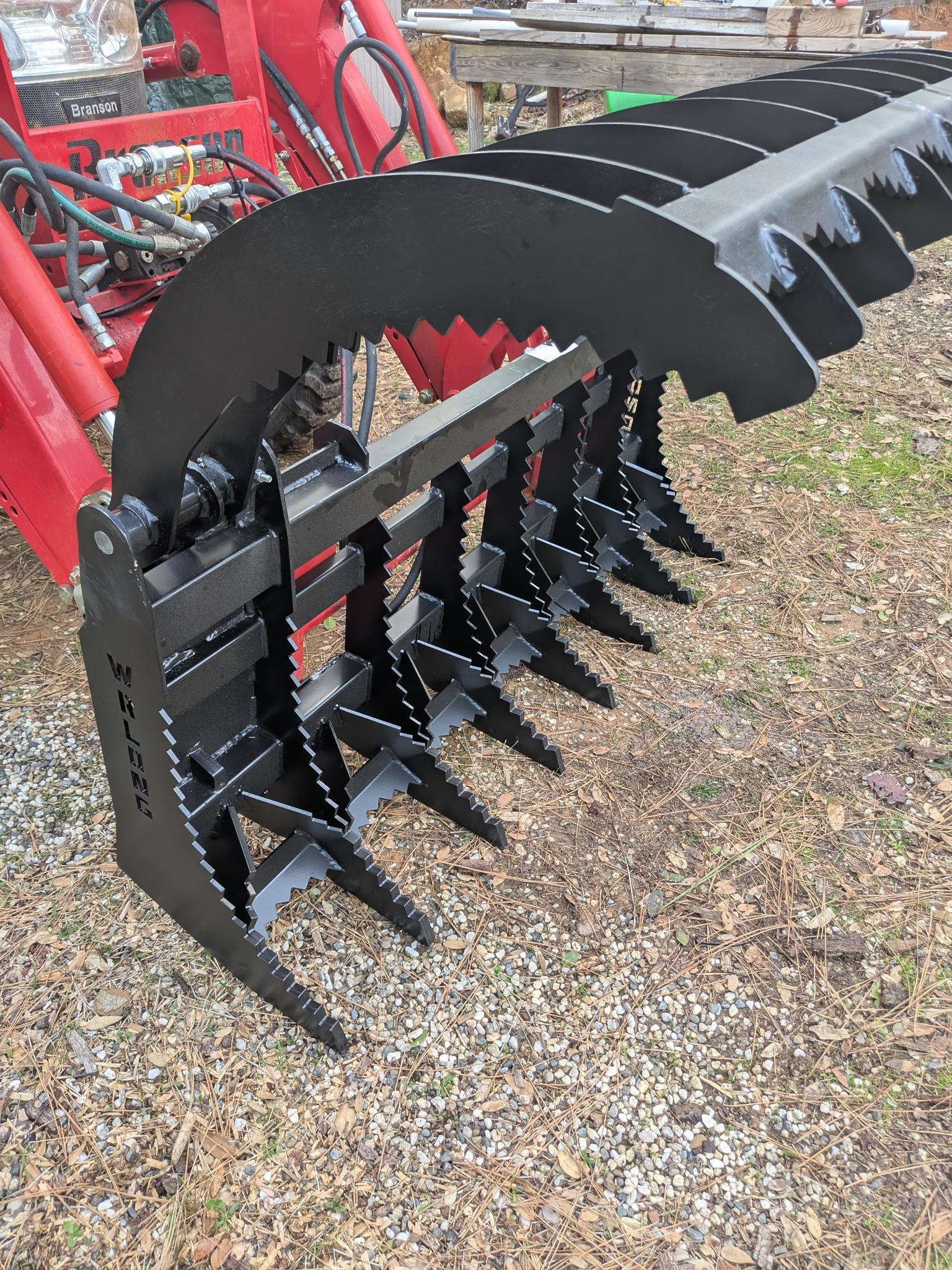

The bottom spikes are laminated, two layers on the outer spikes and three for the six inner ones.
Looks great IMO, nice welds, grease points, the SSQA slots are very nicely reinforced.
Like many grapples of this type, it's self-standing when off.
It's very lightweight and I was able to easily roll it from the shipping position to standing up to connect by hand.

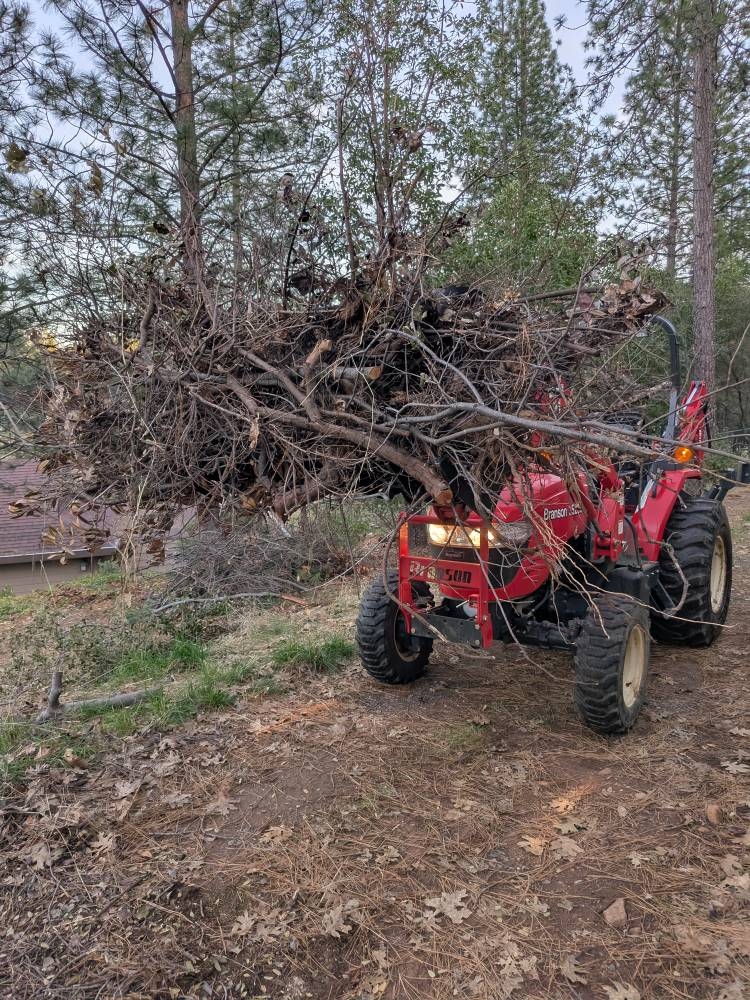

Most of my work till now has been me cutting trees, setting aside oak trunk wood and branches 2-3"+ (small stuff gets chunked for grilling) and making piles of greens and small branches. I change my minimum "keep for later" size when I have a lot of smalls cached.
I've typically made hand piles about 6-8' long, 5' tall and deep, reasonably easy to fork and a good amount to drop on a burn pile (which is officially supposed to be 4x4' but you really can't make a good hot burning pile so small).
With the grapple I'm able to grab one of my piles and compress the !$#@ out of it by closing the grapple, then drop it on another pile and grab it too, and one time already I've done this to take three piles at once to my burn spot, though I did lose a couple small branches from the mouth.
Still it's an efficiency win just from fewer trips, plus losing much less - and I haven't started making grapple-specific piles yet. Having to fork piles requires that they be more approachable and not be somewhere that the tractor will have any side slope as you can lose much of a load off of forks that way; of course much of the land I've been clearing is on a hill and unfortunately I do have to access it somewhat on a side slope.
Till now I've dragged slash to a nearby area with a fork-tolerable slope to make piles, but the grapple will be able to grab them on the slope and not dump them.

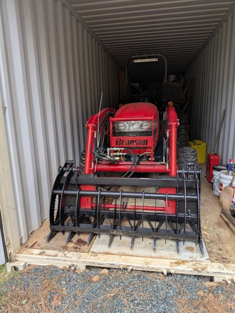

Obligatory grapple shot:
The tractor with the grapple has been nicknamed "Gurgi" after the character in The Black Cauldron who was fond of "crunchings and munchings" because you take a big bite with the grapple then crunch it down ;)
Tractor fits fine in the container with the grapple not adding much length; there are storage racks in the second half and an unfortunate number of bikes in the middle that need to be hung up somehow - also the backhoe is on the tractor in this pic - doesn't fit with the bucket on and definitely not with forks sticking forward.

When I got my grapple a TBN member suggested that I put zip ties on one side, so that I always hook them up the same way. That was good advice which has worked out well for me.

Smart move changing the one Quick connect fitting so they are 1M/1F. Makes it super easy to always get it right. I was going to suggest it but then read farther and saw you already did it.

It'll get it right - after I swap them. I don't like how I set it up, but that was a random choice. I'll swap them before I use it next time, right? ... right...(maybe?)

Cylinders are definitely in back; 8 teeth on the bottom, 9 on top.
Very strong construction of the lower teeth with the 3-part lamination and angled reinforcement.

Love "Gurgi".... I am reading that series to my daughter at the moment. I have grapple envy...

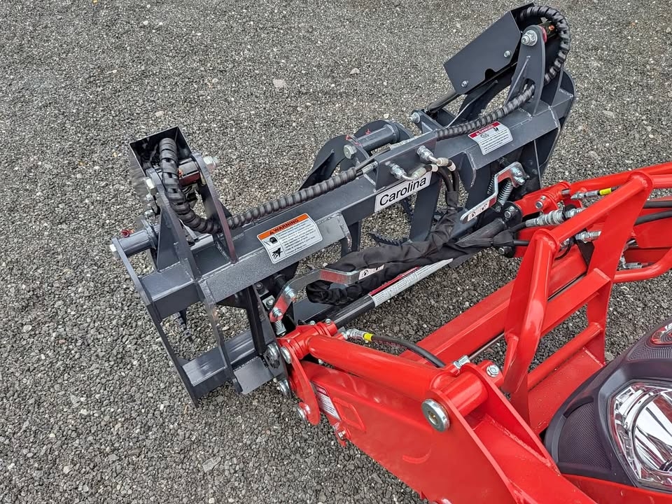

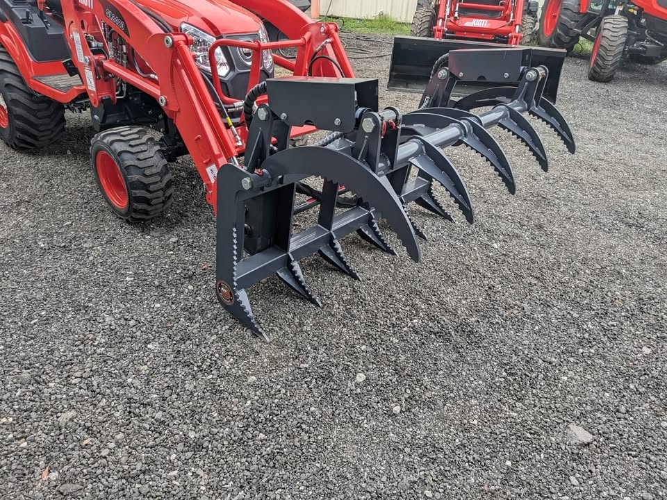

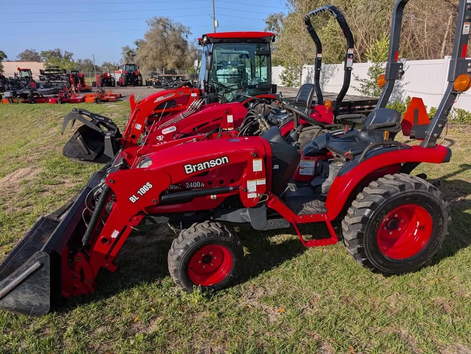

Weight is my concern with BL100S looks like 1300lb capacity.
Catawba 54" does not have any lower teeth, but weighs 212lbs, $2200
Catawba 55" nice teeth 2-6" cylinders grease fittings but weighs 300lbs, $2600
RBG3-54 nice teeth weights 238lbs but cylinders are on top. $2500
Dealer told me to go with Carolina 54" 1-lid with 2- cylinders on top weighs 250lbs,$1500
Just home owner work with veins, scrubs few trees and small logs.
Are cylinders on top that bad?

Not that bad.
It's just a matter of potential exposure to damage.
At least with them on top, you can see what could possibly get at them.
If you're just doing brush/light wood grappling, I don't see an issue. If you were doing building demolition, it could be a concern, but then a small tractor would be a bigger concern. Personally I'm not too hip on how exposed the hoses look, but $1k+ can buy a lot of hoses. The RBG3 also has fairly exposed hoses; looks like the Catawba's are tucked behind pretty nicely.
$1500 would be a tough price to pass up IMO, also the carolina's lower "teeth" seem well braced.

Before I started, I swapped the hydraulic connectors as when I first got it, my tractor had two F connectors and the grapple a F and a M; I randomly chose one connector on the tractor to change to M (this is my first and currently only front loader hydraulic attachment) and I wasn't very comfortable with the choice, it felt awkward in use.
After the swap, using the grapple via the "third function" diverter setup felt immediately natural, completely intuitive. It's like night and day compared to the previous direction. I've found that I can curl the grapple back and close it mostly at the same time as if feathering the two functions by rapid-fire hitting and releasing the button.
