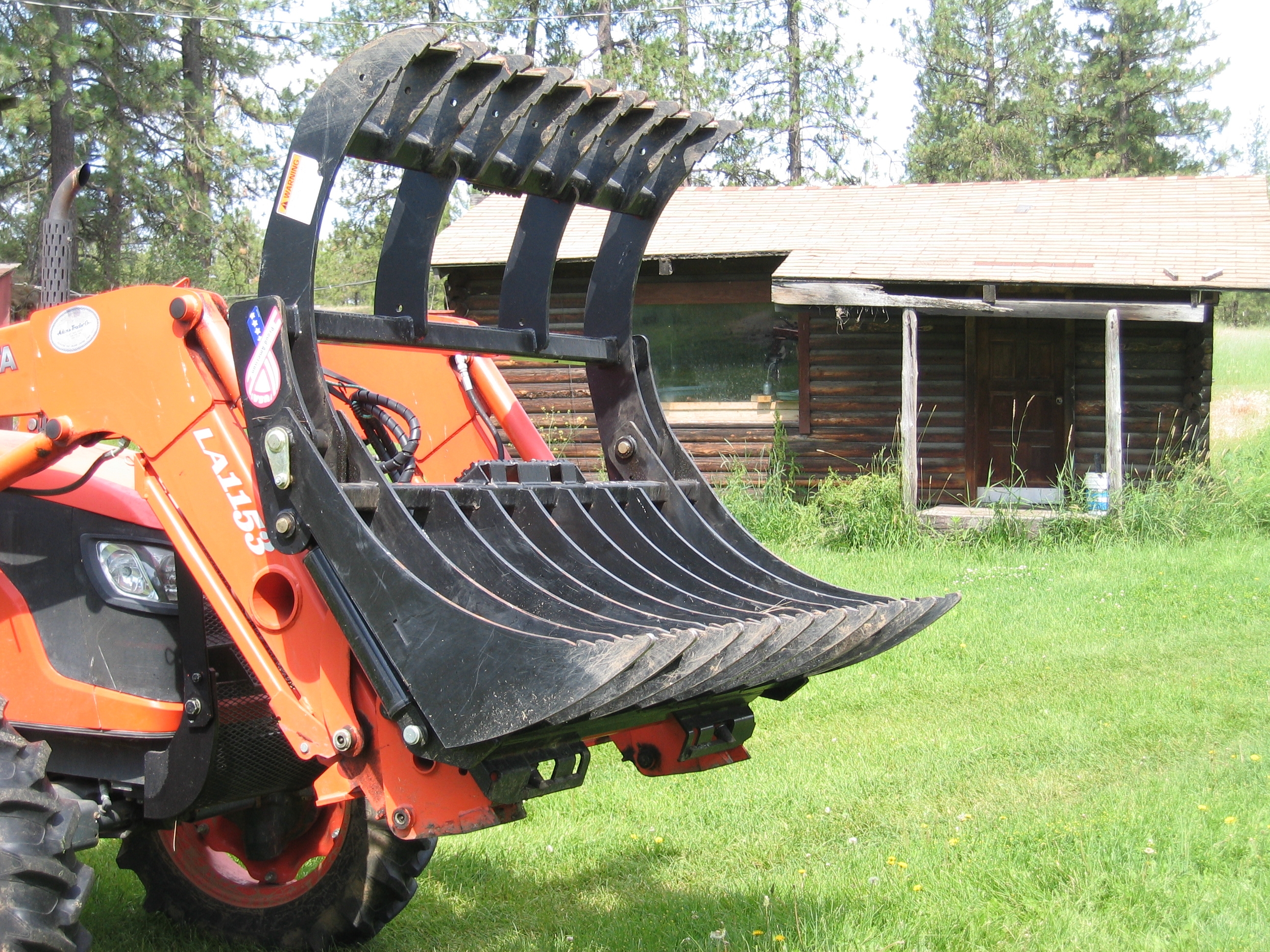

My Kubota M6040 with grapple and grill guard. Also - grapple wide open.

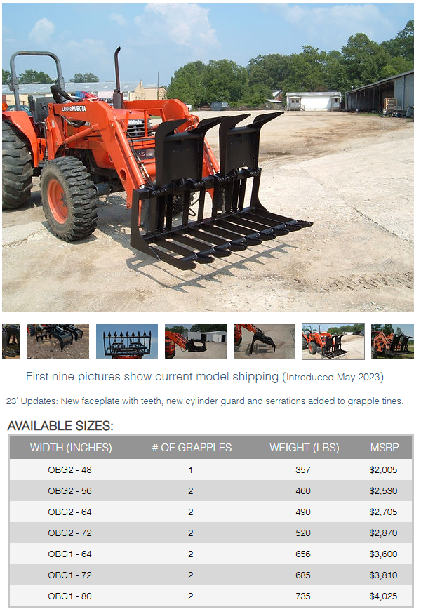

I have a W.R. Long OBG-1 72" grapple on my WM75. It does everything I ask of it. It does take a little bit of finesse to get it under large logs without digging into the dirt. I have to clamp down on it and then curl the grapple under it. It does a good job if I need to dig out vines or brush. The smaller OBG-2 would work on your tractor in whatever width suites you.

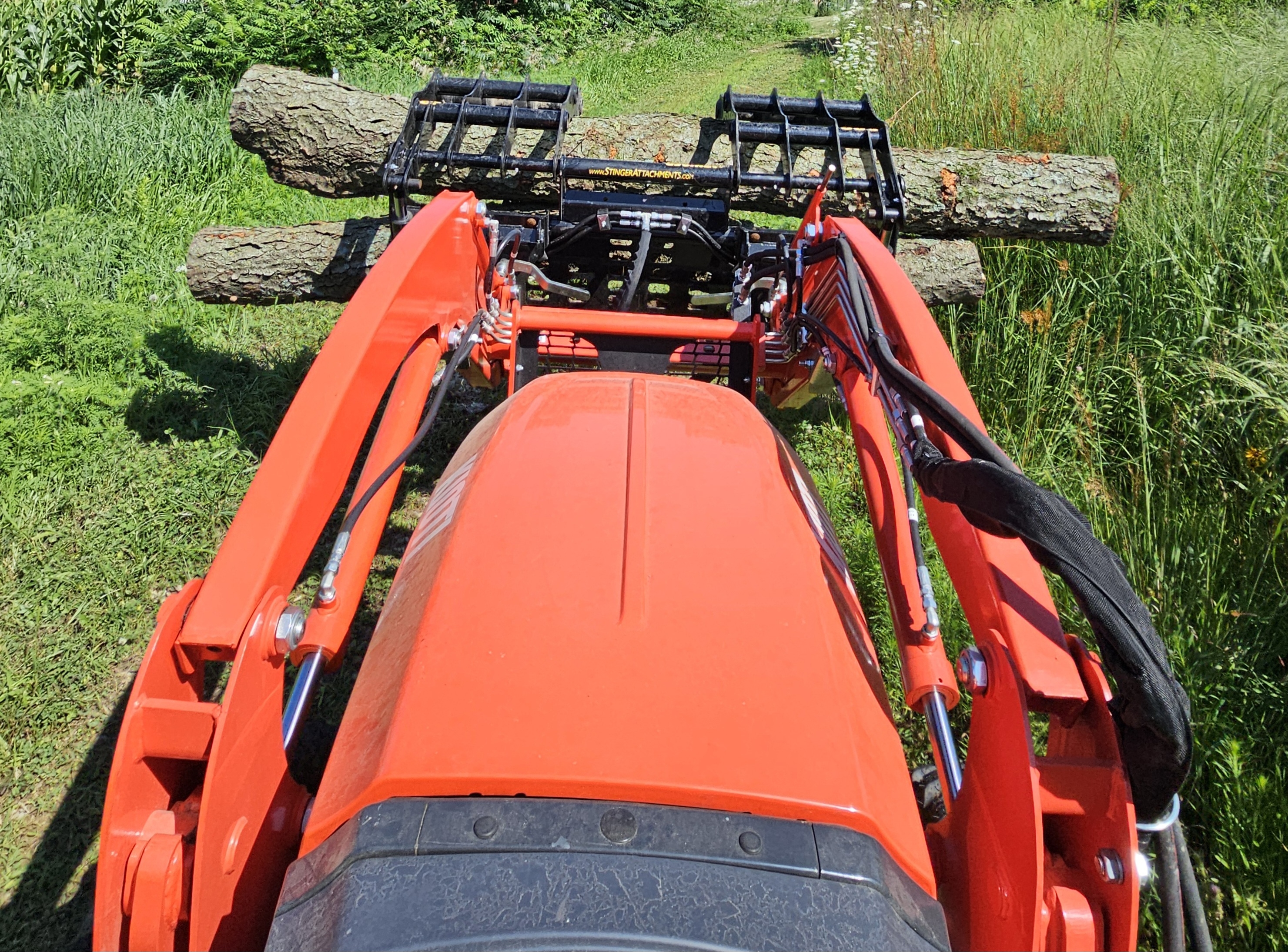

I love my Stinger Attachments CG56" dual lid, AR 200 steel, lots of rear protection, cylinders at the back out of the way and only 360lbs. These are built crazy strong if you want to check out the video.

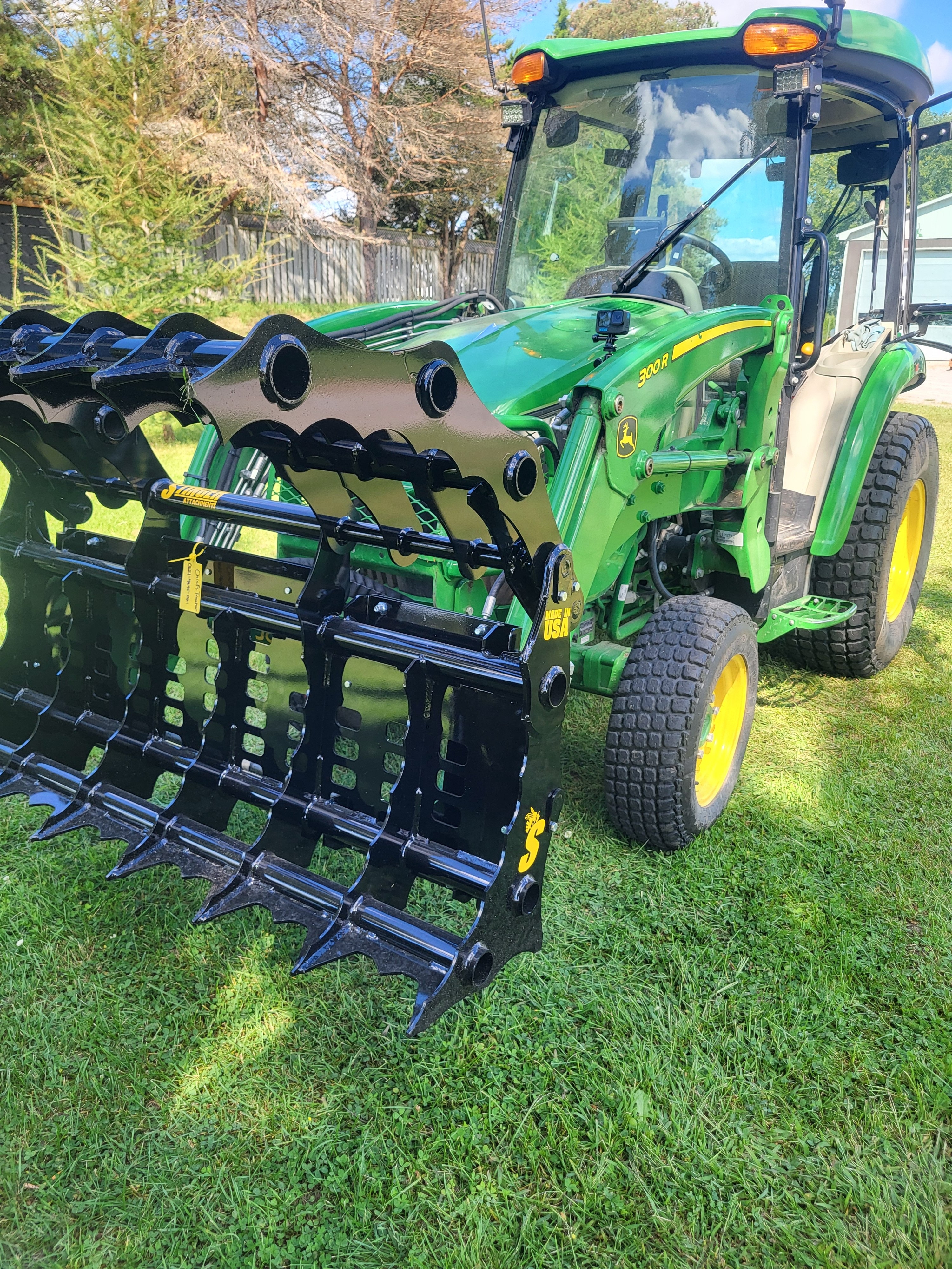

I also have the CG56. I'm not sure you could break it if you tried
