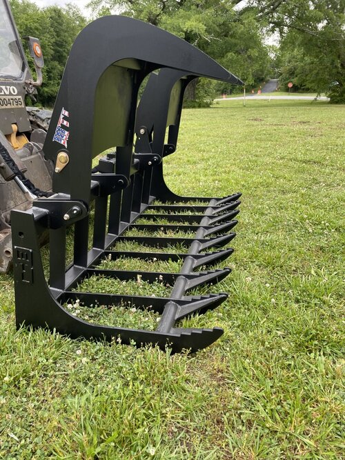

The big question I have though is about those piles I make; the grapples I've seen seem nice from the relatively light grabbing tool standpoint, but my concern is that most of these have a maximum jaw opening of about 36-39"
and if I'm limited to grabbing smaller piles, that's a lot more driving across the property and reduces the effectiveness.
It seems likely though that one could approach such a pile from above with the jaws open, and crush the pile in the jaws - definitely when I put my forks down from above things get smaller (the piles are probably 80% air) so it seems possible that a grapple may be able grab it all in one go, but I'm reticent to drop $3k on something that might not fit the bill. Currently I do move those piles with the forks, but it's tough to get a pile on a steeper hillside - and tougher to keep it on the forks. When I'm working on flats, I only lose an occasional branch which is tolerable, but when the whole pile falls off it's a pain, and so while I'll occasionally chain or strap it to keep together, that's extra steps I'd like to get the grapple to avoid.

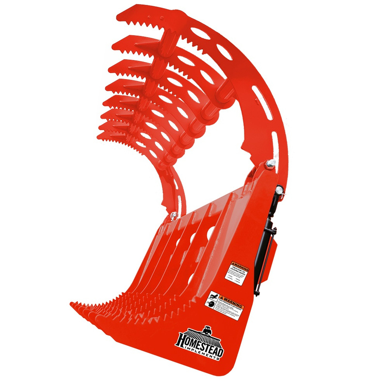

I was also considering a log grapple
but it likely has the same pile-grabbing questions as the above (though the max opening of 42" is more than most other grapples it seems, but as it's not as wide it would depend that much more on a well-constructed pile; I do make an effort now to put longer stuff on the bottom because I'm just picking up with forks, but being able to make a heap with less concern about branch length would be a plus).

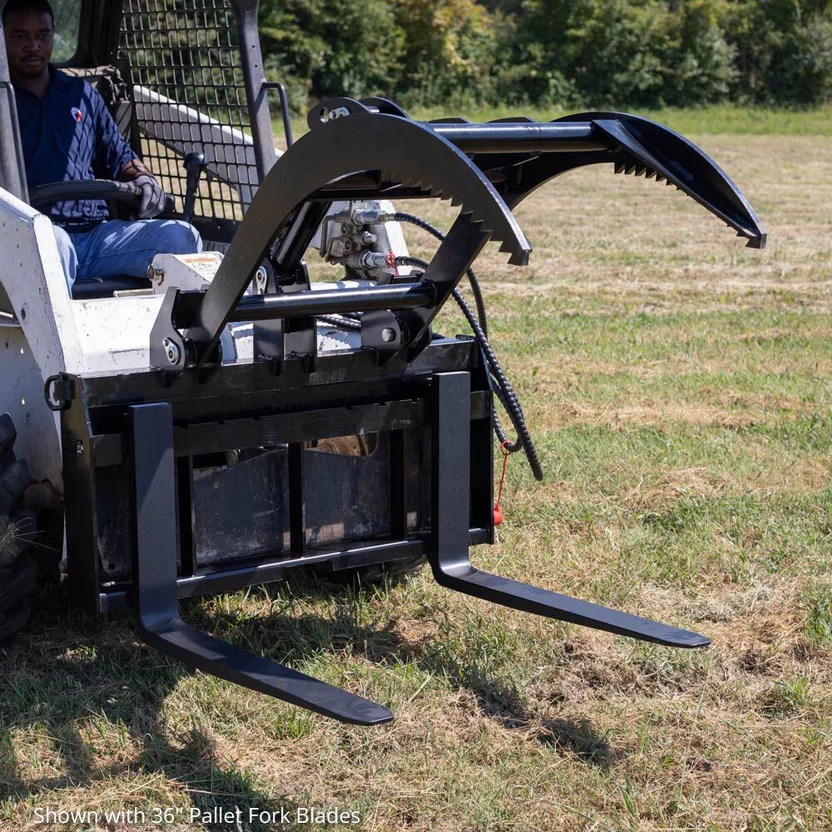

There's also the pallet fork grapple, or thumb
I suspect the fork thumb has the tallest "opening"; that grapple lid probably doesn't open any further than in the pic. Both of these are cheaper, but it seems to me that neither is likely to be very useful in pulling apart a matted pile of trees and shrubs.

Mine open to 54'', and with technique you can grab quite a bit I would tilt so the top lid contact the pile first press it down and tilt back for the tines to slide under.. but if you don't have a bigger tractor then your Branson 3520h this one below is too big for you.

Your use for a grapple is very similar to mine. Like you I crush the pile with the grapple before biting into it. A few things to note.
The lid of the grapple will suck some of the pile down into it when closing allowing you to grab more than the opening of the grapple.
I have a brush grapple that is L shaped. These grapples I believe can carry more as they have a higher volume and hold the load straight out.
Below is the grapple I have.
An example from another user showing the amount of brush that you can hold forward of the grapple edge with a L shaped grapple. Notice how the tractor is carrying almost as much brush in front of the grapple lip as it is in the grapple.
You do not need a grapple as wide as the tractor unless doing lots of grubbing. A narrower grapple is more maneuverable in the woods.
Another point is that when you drive into a pile you compact the pile against the back of the grapple increasing density of the brush that is being moved.
On a good bite I can hold about a 6' pickup truck beds worth of brush in the grapple.
The fork type and Log type grapples are best at handling logs. They hold the log to the forks and allow you to grab multiple logs and transport them securely. They are not that great at brush as it is challenging to pick up brush in short pieces or brush that is flexible. The frostbite can move brush and does it well, however it moves very little brush compared to a wider grapple.
