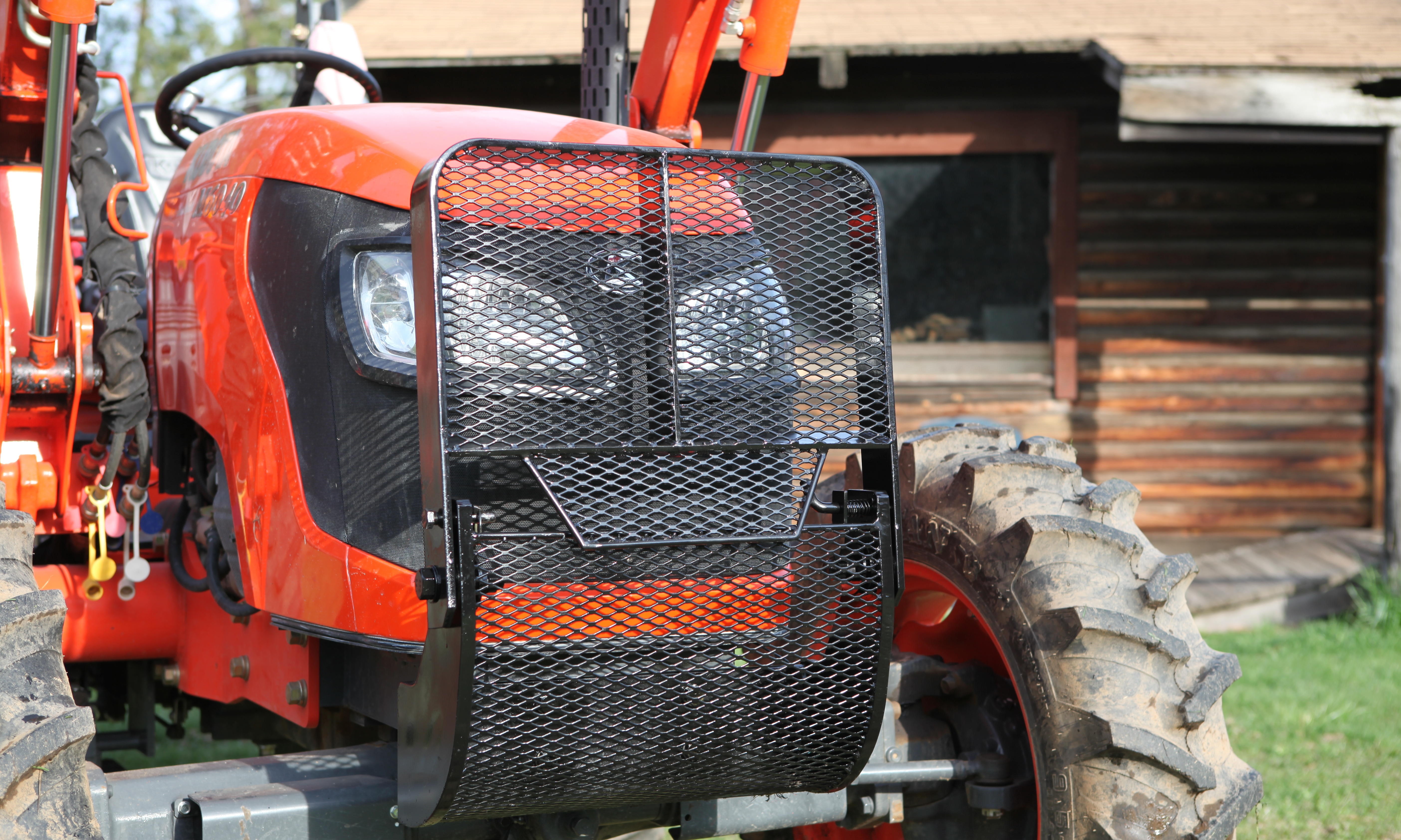

I have a grill guard on the tractor and never had a problem myself or others who use but I could see the need for a metal screen type of guard on the tractor if moving a lot of brush to protect plastic rad. grill for those times where operator just doesn't take enough care and a stick or root pokes through the grapple towards the tractor.

MapleLeafFarmer & bdhsfz6 both mention the grill guard. This is a VERY necessary item. Some will say they are very careful about limbs, sticks and stobs. That is fine until the day they run one thru their radiator, grill or battery.
This is my M6040 with the grapple and guard. Grapple is up because I was getting under way.
View attachment 5245051View attachment 5245052
Very true. I messed up my grill to the tune of like $400, but fortunately not involving the radiator. Shortly after I installed a grill guard.
And sometimes you don't even know where they came from.

Adding an expanded metal cover over the front grill brush guard is an absolute must no matter how careful you try to be and mine has all kind of paint scratches to prove it. the short reinforced teeth work great driving forward ripping out roots and small stumps and the lid can back drag in float mode without any damage as long as you make sure it is opened all the way so the load is carried on the bottomed out hydraulic cylinders. just don't push anything with the lid open or it will snap the cylinder at the yoke (you can guess how I know).
