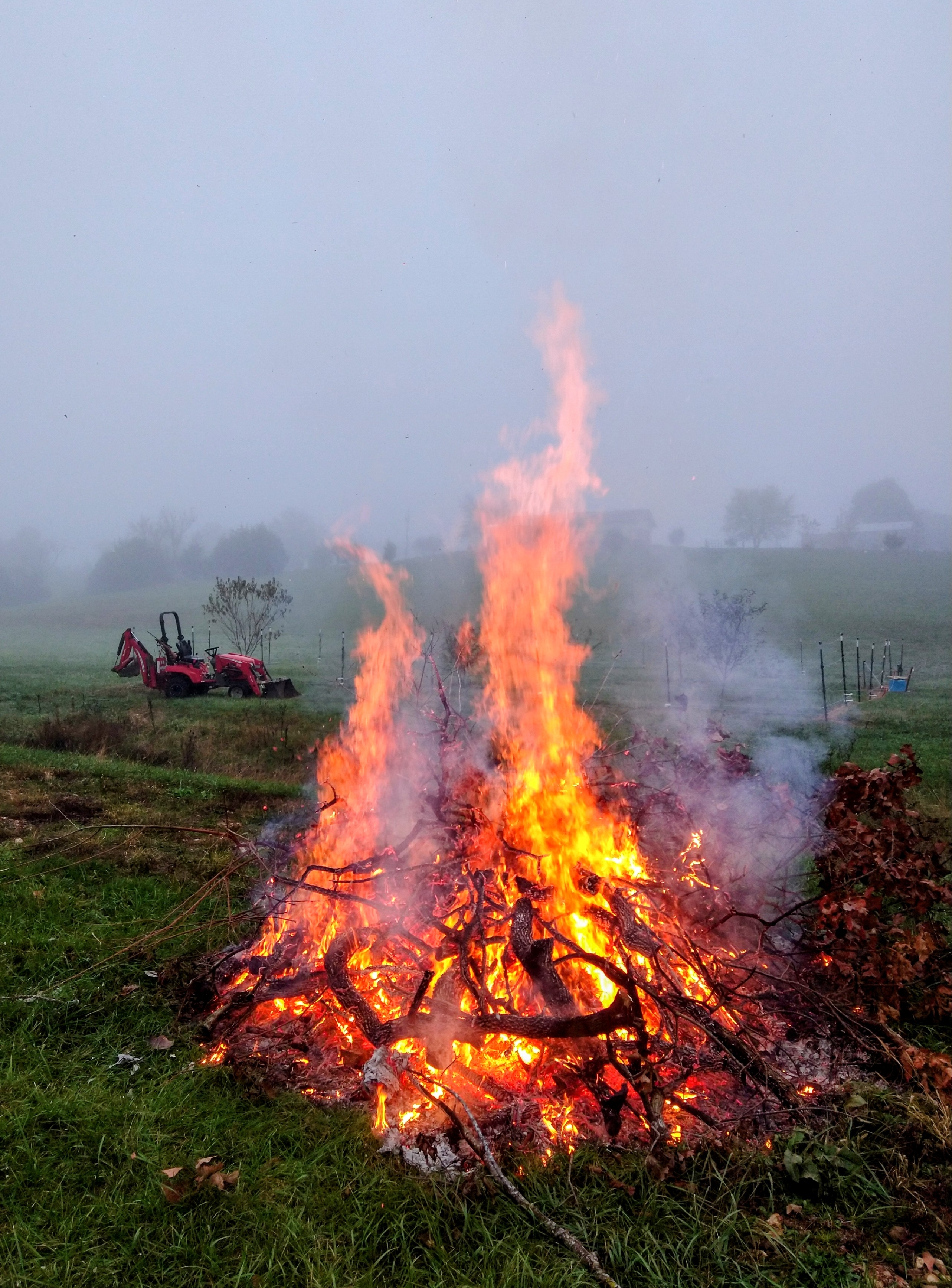

Unless there’s a reason you can’t burn in your area it’s really the best . That pile would be down to ashes in no time.

wow... If I had to wait for a rainy day I would never get my burn piles looked after (haha)
Honestly I gave up grinding long ago for burning as grinding takes a very long time vs. my burning unless I had a lot of money to buy a lot of hp. to make the work. Grinding is comparatively a lot more time intensive. Realizing not all live in places where burning is safe and allowed though I be blessed with 5+ months of snow on the ground.

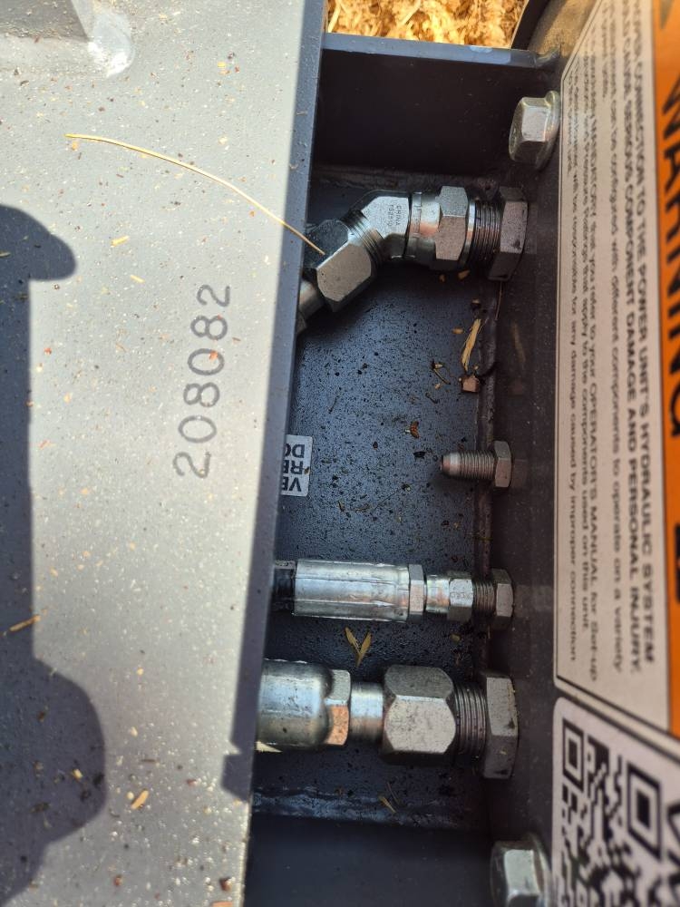

From looking at your picture in your opening post of the stick and mulcher they do have it plumbed to your auxiliary 1 which is your high flow and is correct. You’re thumb is connected to the auxiliary 2 , low flow, also correct.
You’ve got three hoses going to mulcher, one of the two smaller lines will be your in flow to the mulcher motor, the other small hose will be the case drain from mulcher motor and returning to tank. The one large hose (looks to be 3/4” ) is return oil from motor. As far as I can tell it’s plumbed correct, no way would they try to run that big mulcher on the low flow aux 2 . One other thing is when you’re running the mulcher or any attachment with a motor you’ve got to be in one way flow, this I’m quite certain with the newer dash 5 series is done with a pilot operated selector valve . Older dash 4 models you had to manually turn the selector valve to choose between one and two way flow..
I would ask your dealer to send a tech out and give you a demonstration .

I'd put the thumb on and restack that pile in either a log cabin stile pile, or a tee-pee style ... Save your cardboard boxes, and on a damp still morning light it up!
I use the propane torch to light the cardboard ...
Blazer says, that's some serious heat!
Oak is gonna be a long slow grind, especially that 3'+ stuff ...
