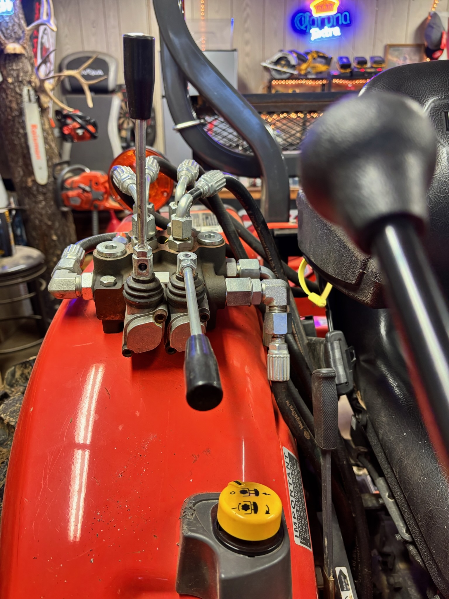

I made my own true 3rd function using a Summit valve so I can feather my grapple as well. Wouldn't have it any other way. This is the perfect setup.

Using a diverter allows the same control with the FEL controller, when you hold down the little button at the same time.

Is there a reason you chose a diverter in lieu of an SOV on the PB circuit?
I have a 55hp tractor with pretty good hydraulic flow for its HP range. My 3rd function is power beyond. Unless I am running a fairly high rpm (2500+), I still don't have enough flow to do 3 functions at once. Whatever function is most downstream on the hydraulic valve block will be slow or completely unresponsive until the upstream function is completed and the flow can travel to the downstream function.
If you must stop curling the bucket to actuate the grapple anyway, why not save some cash and just use a diverter?
Yes, I can lift, curl and grapple at the same time with full throttle. I don't do it that often. But when I have a lot of brush to move, I run nearly wide open and get after it.
