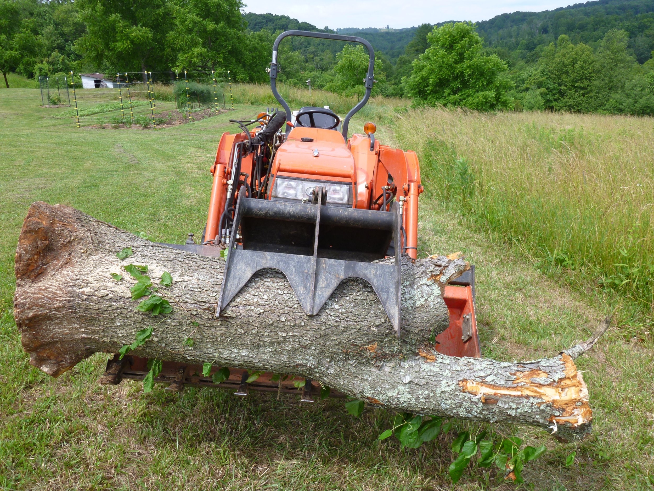

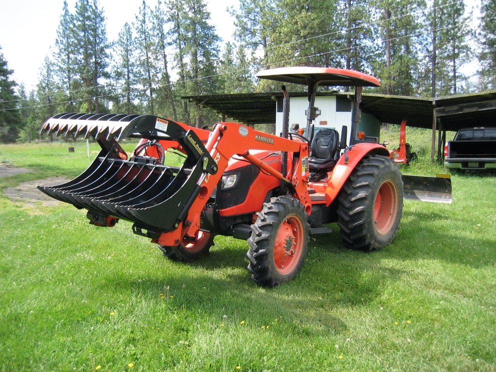

How much more brush do you have to move? I have the single bolt on grapple at 140 pounds paired with a tooth bar offers a nice combination. Both are made in Tarboro, NC

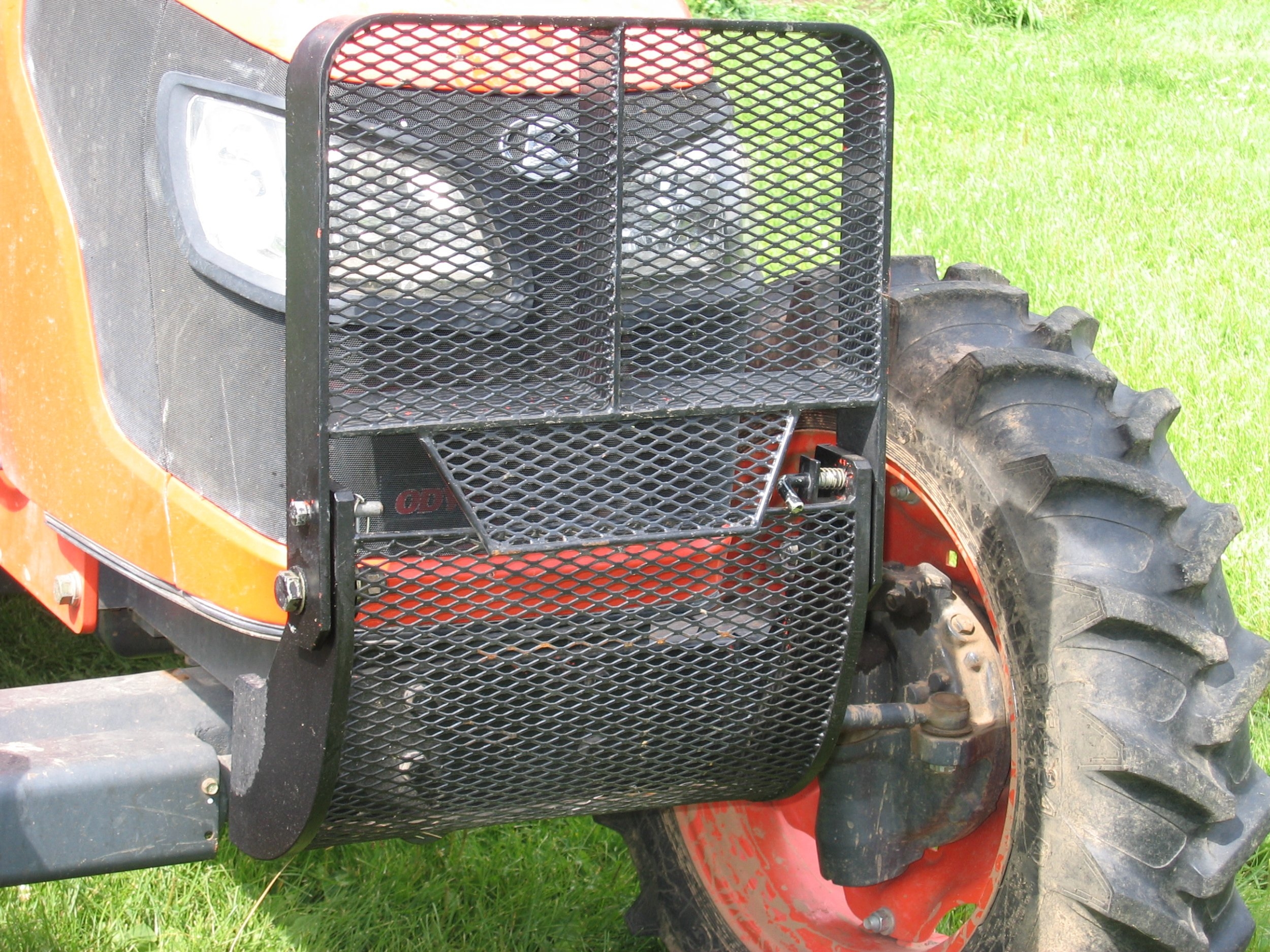

Don't forget to modify your grill guard. Limbs, sticks and stobs have a nasty way of finding your grill, radiator or battery. This is how I had mine modified.

Thanks for the input from everyone. The WR Long is a good looking grapple but out of my price range. I can get the 48" from Midstate for $ 1300 and the 60" for $ 100 more. Planning on going to their yard this weekend to check them out. I bought a set of forks from them in 2010 and they have been bullet proof. They make everything on site except for the forks themselves. I've moved a ton of logs, brush and so on over the years. To answer old and tired, I live on 52 acres with a 1/4 mile driveway. There is never any shortage of something to clean up. Also good point about the grill guard. Been lucky so far but time to do something before I do some real damage.
