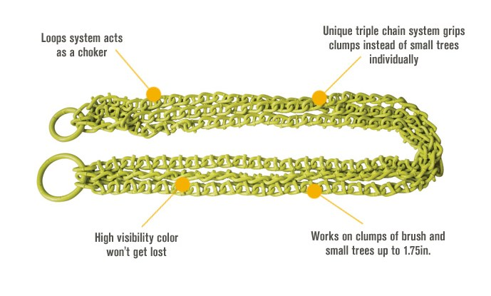

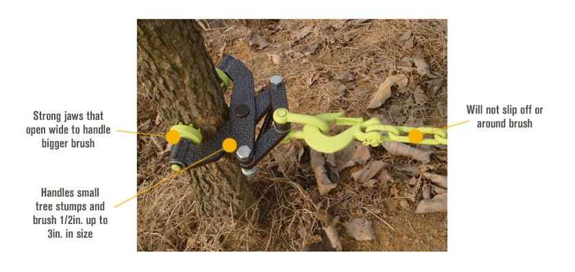

I have ongoing needs to pull garbage trees around the property to keep things neat and have been slacking off on this to the point where I really need to start attacking this. We're talking about small trees up to maybe 2-3" max and clumps of small stuff mainly, buckthorn, poplars, basswood, and other misc junk/weeds. I haven't used one of these before and it looks like 2 main styles: 1. the Pincher style, and the Chain loop style, like the pics below
This is homeowner use, not commercial. I will be doing most or all of this solo as wife is not terribly useful for stuff like this. Equipment is my Kubota L5240 with loader (and a rear blade on pretty much always). I have chain hooks on my bucket, forks and a grapple available as FEL attachments to help out. Plus several lengths of heavy logging chain. And before you all say it, I have tried using the grapple for stuff like this and it tends to make a huge mess and not work great for this task, IME. It is great for hauling/moving/picking up brush and logs, but not so much at pulling smaller brush by itself. I also need to do this where junk trees are growing right next to good trees, so need to be a bit surgical at times.
It seems that the chain loop style might be easier to deal with solo, but not sure if it is sturdy enough for trees in the 2-3" range or not. What say you, oh Glorious Collective? Which one would be best for this circumstance, or do I need both styles? Or is there another option I am missing?

If you need to pull clumps, get the chain.

What type of trees and brush in what type of soil? If deep tap roots in hard soil will the pincher type grip good enough to pull a 3” tree? I have one for my 2400H which is smaller tractor and some times just peels the bark off and other times pulls them right out. For brush clumps the puncher type is worthless.

I have the chain and the other device, the chain is not strong enough for tree's and i would step up the other unit, I use a much larger version of it
this is what I use, be aware they are very heavy and the job sometimes is a lot easier with 2 people. only pull from the draw bar, your going to be shocked how fast a tiny bush stops you dead in your tracks.

Is the chain useful at all or is it just too little to do any real work? I have this feeling I am going to end up with both as the pincher won't grab small stuff and the chain won't be heavy enough to do anything significant.

chain works generally ok on bushes, pincher is useless on anything that doesn't have a trunk
/ Brush grabber type - which one? #11
I have one of the chain pullers that I attach to the drawbar with a short G70 chain. It works great solo. I have also used it for pulling old chain link fence posts and t-posts with the FEL.
The pincher does grab the small stuff. Here is the BG-20 pulling some tree roots:

Lots of good information in this thread. I have the grabber you listed and it works well for what it will get ahold of. I use it for stuff that I can't get to with other attachments (tooth bar / tree-puller / stump bucket ). The pipe/chain combo looks like a great idea and you already have the chain. You can always just try wrapping it and see what happens based on your soil/conditions as well. Always a good idea to start with what you have and go from there to see if you have the right tool or can deal with close enough to not spend any more money.
