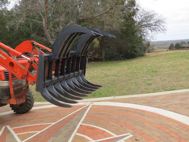

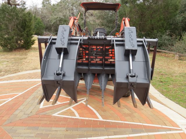

Got Grapple!
It's from TheRakeShop.com
Light class grapple (plus)
60"
bottom teeth 1" thick with 6.5" spacing
Open 41.5"
Shipping weight 700#

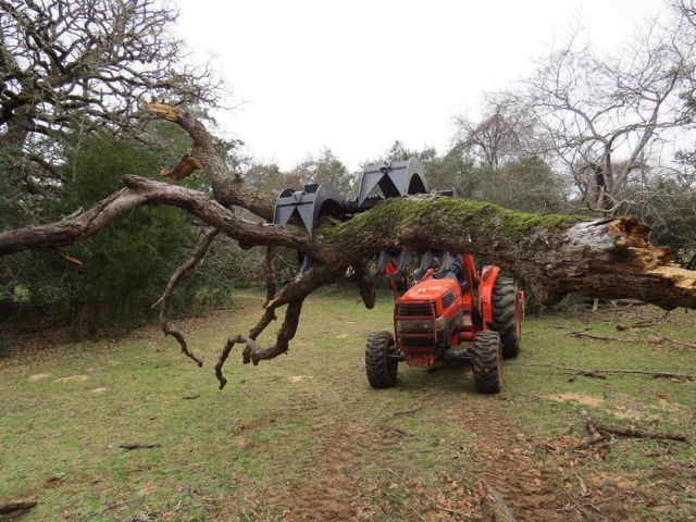

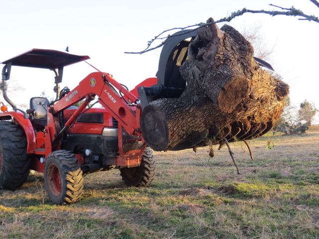

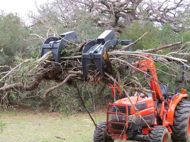

Action Pictures.
The grapple does everything I bought it for.
The Grapple comes with 9" spacing but I had them put in an extra tooth in to get the 6.5" spacing.
The lack of a cross bar and the curved bottom teeth are an advantage for me to get deep and lever out small trees and Youpon bushes
One thing I did not buy it for is mesquite, but as you can see in the third picture it pulls them up by the roots.

One benefit I found was the way the back of the teeth supports form a "V" to really help grab those stubborn trees and bushes. I was initially concerned that limbs and trees would get stuck there but so far everything has fallen out of the "V"s easily when I dump it.

Looks great! And if this is what they call "light" duty, I'd like to see their heavy duty ones.

txdon - What a GREAT looking grapple!! I think that's what I want to go with. In Ohio, we have an invasive shrub called honeysuckle. My woods are full of it and it will take over everything if you don't stay on it. If you cut it, it will just come back. So you have to pull it out by the roots. I was really encouraged to see the pics of you pulling the mesquite out by the roots. I think that mesquite is tougher than the honeysuckle which is a shallow rooted plant.

For dead limbs and trees any grapple will be good. I especially wanted this particular one to do that and be able to easily dig deep to pop up roots. The curved teeth without the crossbar sink into the ground just as I imagined they would. I drive forward and tilt the grapple back slowly to take advantage of the curl.
The live brush/small trees are taken out in one of three ways with this grapple: 1. The teeth pop the roots out. 2. The jaws clampdown and I pull the bush/small tree out. 3. The "V" at the back of the teeth traps the stems and I push them out.
