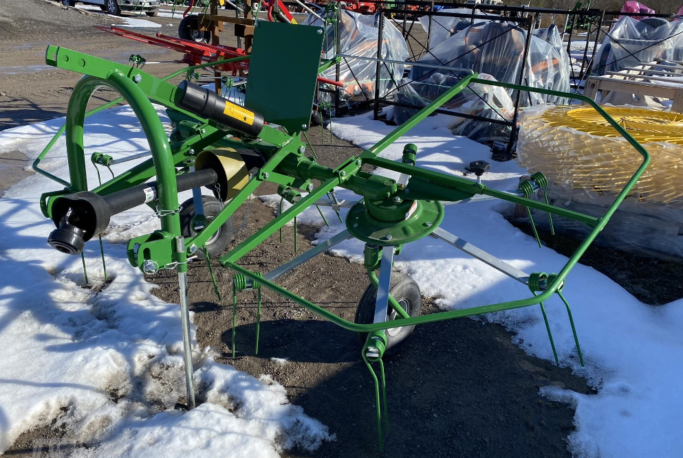

I think I have some “recency bias”. We have had a couple years now where the tedder is seldom used. Now that I have sold mine, I am relieved that the poor roadability issue and wrong size issue is gone, but now I have a new problem: finding the right size (20’ or 30’), better-roading tedder and keep the price sane.
/ Suggestions finding the right tedder #23
I don’t think those will road very well on the tiny lawn mower tires.
But enrossi makes big units, too or at least they did….
I’d rather be 21’-22’ than 19’. A little oversized makes constant steering adjustments go away.
Rossi sizes:
Not sure how far you have to road, my Kubota has 16x16.5-8, it pulled zero issue behind my pickup at 25 MPH from the dealer, was a long drive home so a good test. Seems to me they are actually trailer service tires. I am on blacktop almost every trip to the field with the tractor and it pulls fine.
I agree you want slightly bigger for ease, seems like next jump up is 24 -26 class like you had.

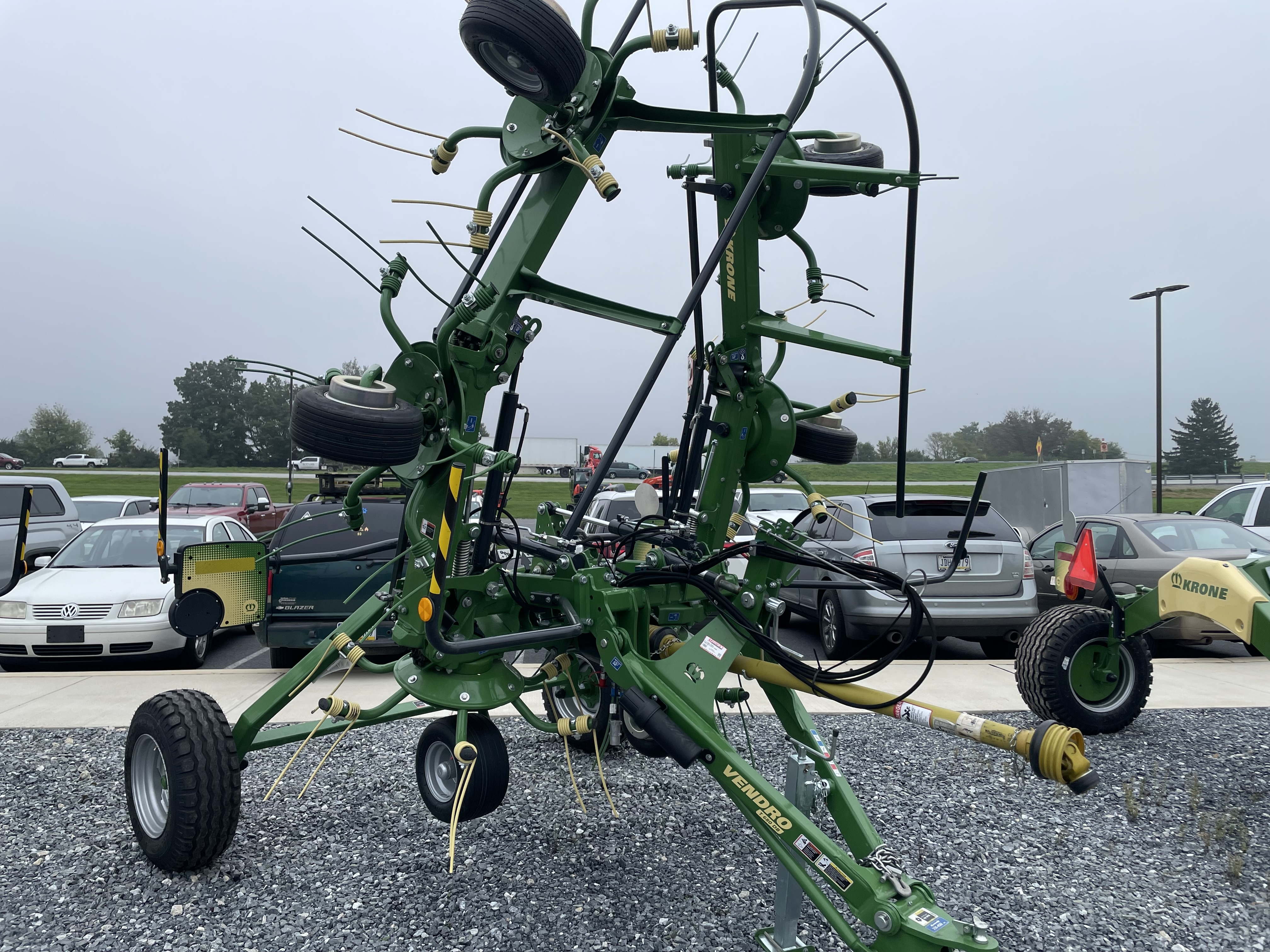

Just found a new model of Krone tedder "Vendro" It’s a 6 rotor 22’ foot with road cart and road lights.
$23,800, which ain’t 10K, but its not 30K, either.
60 months 0%
or $1250 cash back
Tempting. I like the German machines and at 22', it would cover my pottinger front and side mowers @ 11' each. There's a little overlap so it's really about a 20' cut.
60 months 0%
or $1250 cash back
Messicks.
I think you found a winner, checks all your boxes. Krone is good equipment.
I wasn’t planning on spending or financing that much, but yes it is a perfect fit.
I’ll figure something out.
