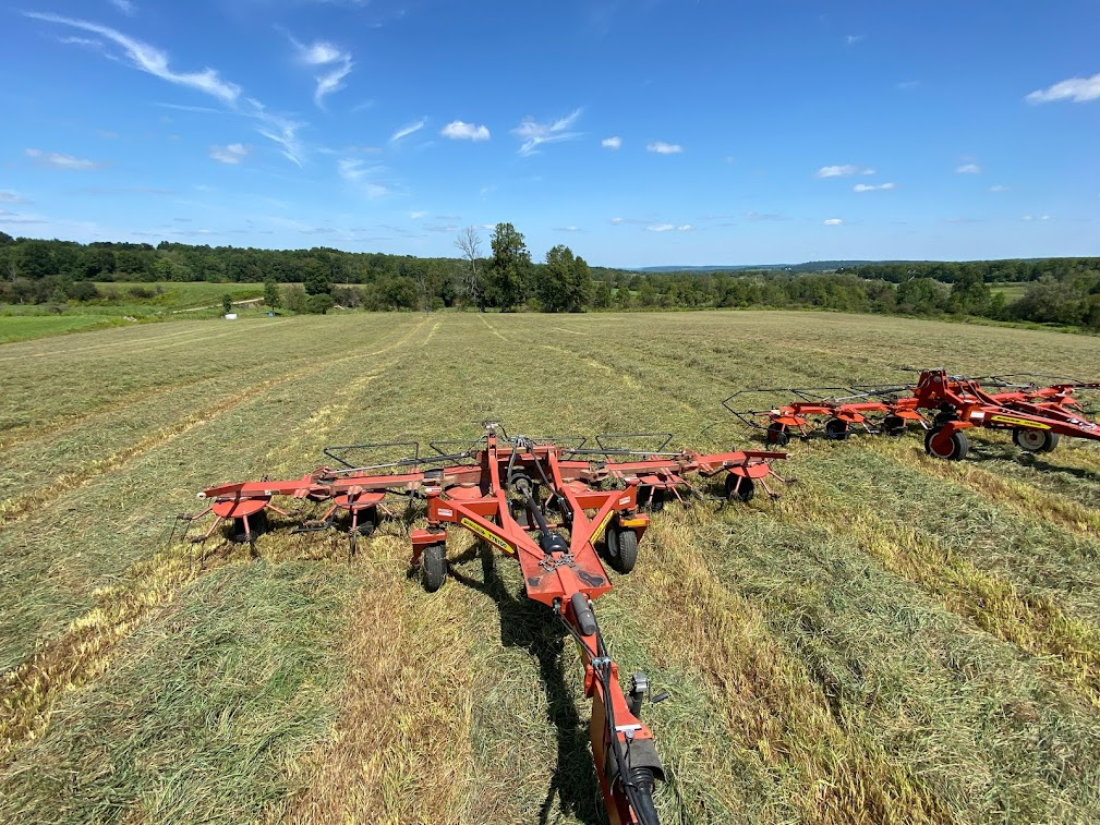

I am selling my Pequea TT-6100. It teds about 26’ wide.
My disc cutters cut about 11’ each, so I cut about 20’ wide per pass (there’s a littlew overlap between mowers)
I like to “lay out” my hay as wide as possible to get it to dry, so 26’ is a tough working width.
Also, I find the Pequea tedder I have to be terrible to pull down the road. It’s very squirrelly. It borders on being dangerous.
In fact, Pequea must have listened to me because they redesigned their new tedder to be much more stable.
Esch makes a 20’ tedder, which I could live with, but no road transportation wheels, just the tiny tires.
A new 30’+ tedder is $35,000 and I don’t want to spend that kind of coin on something that I don’t need to use very much.
Thoughts on a possible replacement?
I’m thinking about a used 30’+, but wondered if anyone made a 20’ tedder that is stable towed down the road?

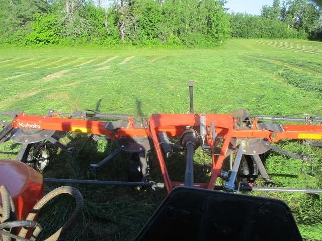

I would buy a Kubota one again.
I have a 4 rotor one (17' 1") now and I am very happy with it. It has smaller tires but roads fine. I actually pulled it home from the dealership with a pickup.
Kubota has a 24' 11" model. TE6576CD, that model has the larger transport wheels and all.

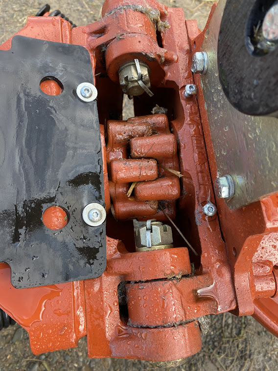

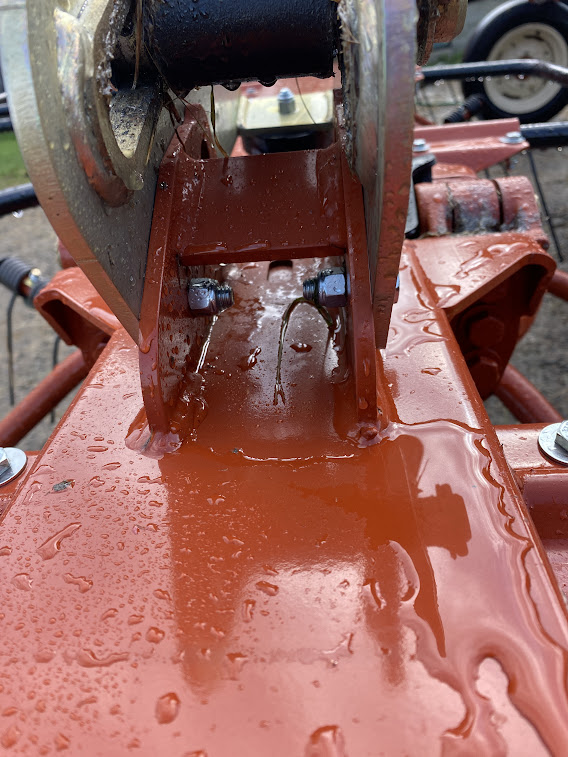

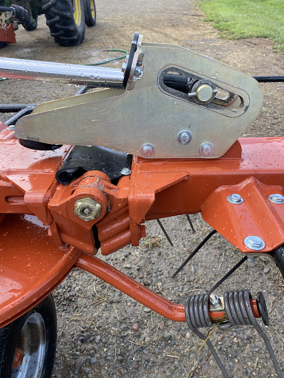

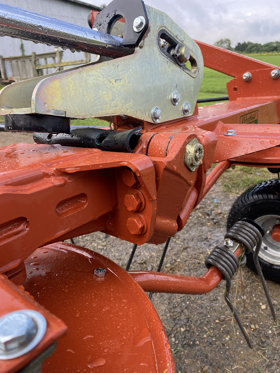

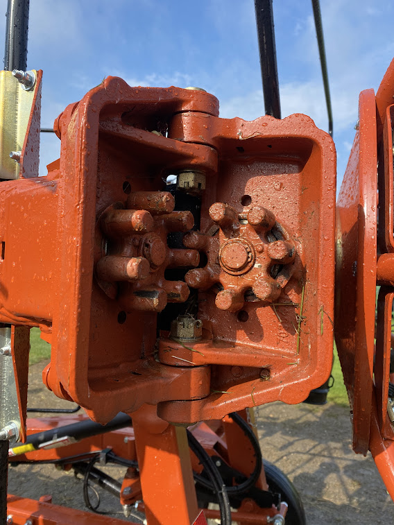

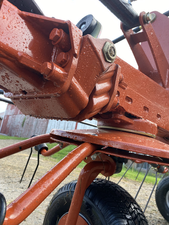

I will recommend Pequea all day long. Move up to the 8 rotor if wanting wider. I haven't had the same issues yet with my tedder on the road. The road locks are much better now. No cables, all linkage now. They have drastically beefed up the entire tedder as well as sped up the gearbox 23%. During my ordeal I would have taken the Pequea owner's offer and upgraded my tedder had I been in a better position financially and it wasn't such a poor hay year.
Pictures I took of the tedder before returning. Compare with your tedder. I could feel the weight difference. There was nothing I didn't like about the new models. I would challenge you to find a heavier built one.
