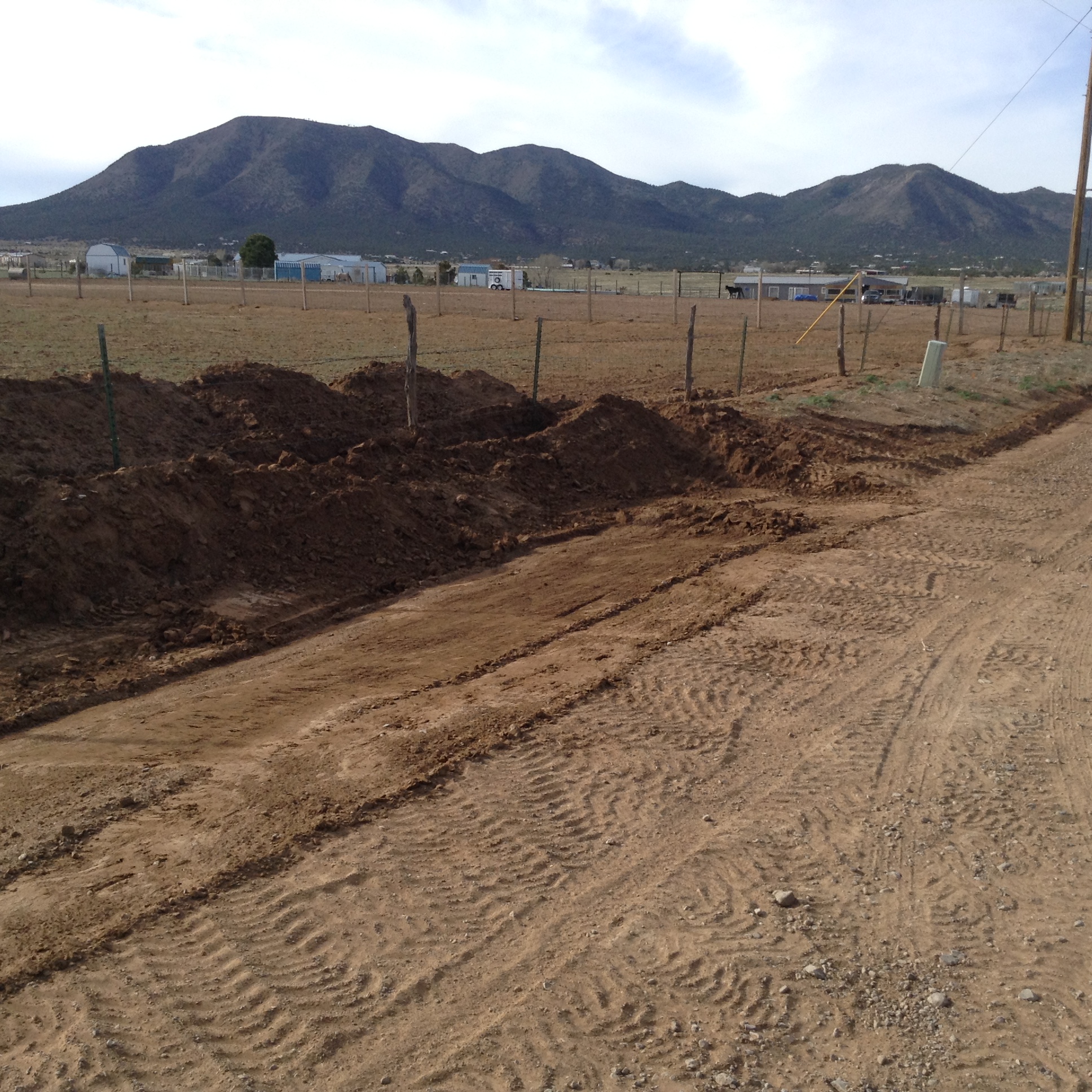

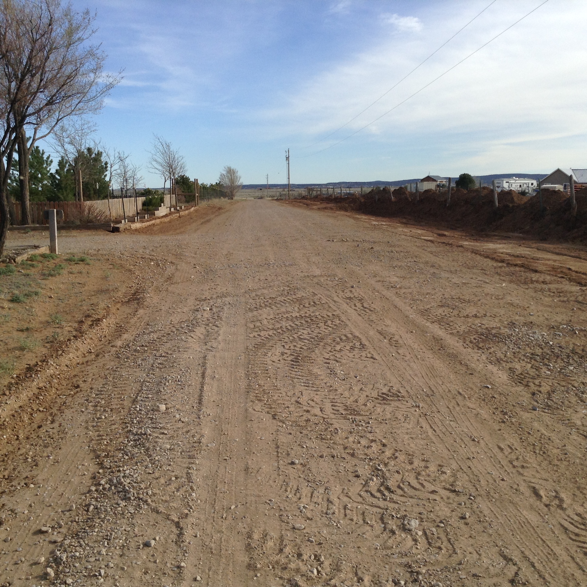

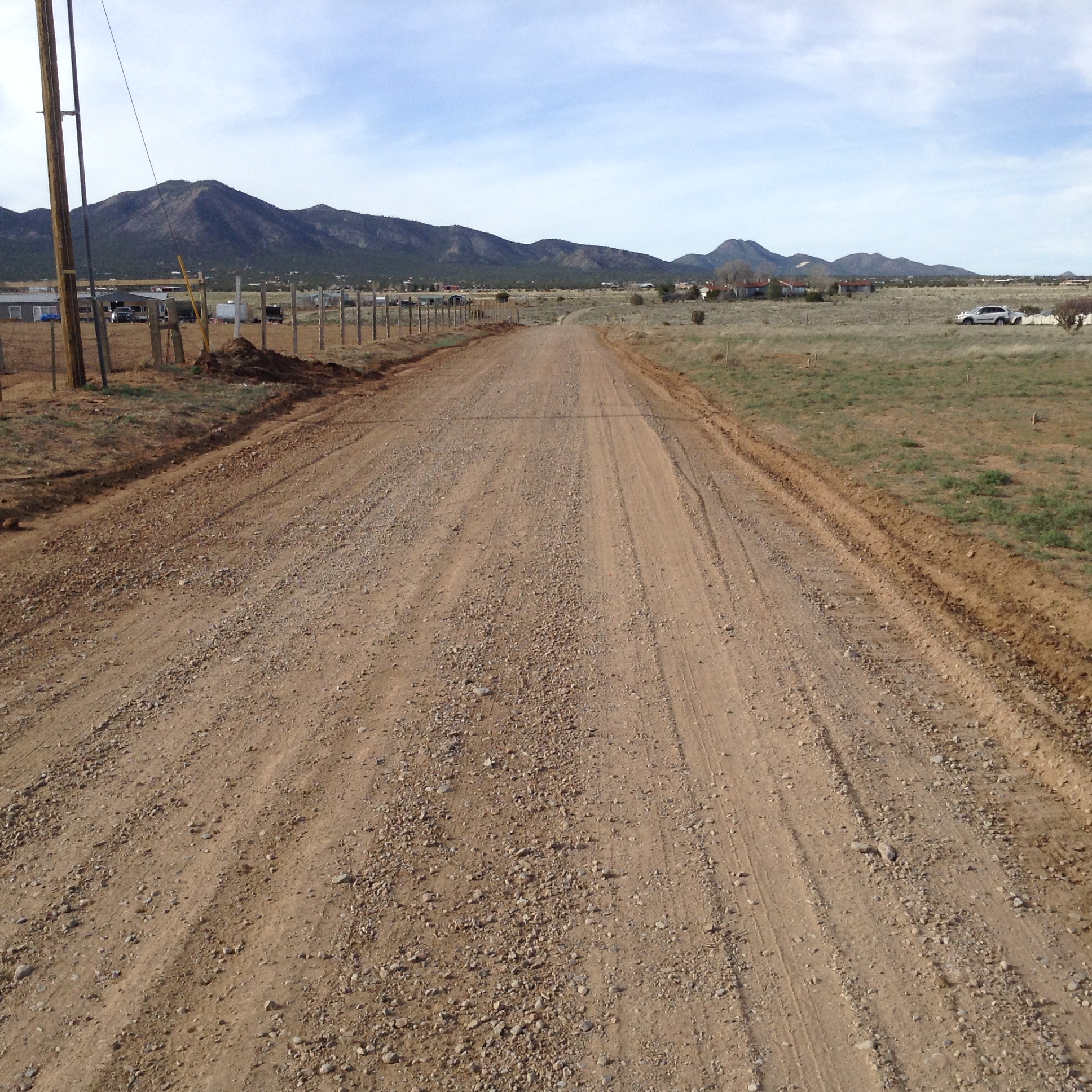

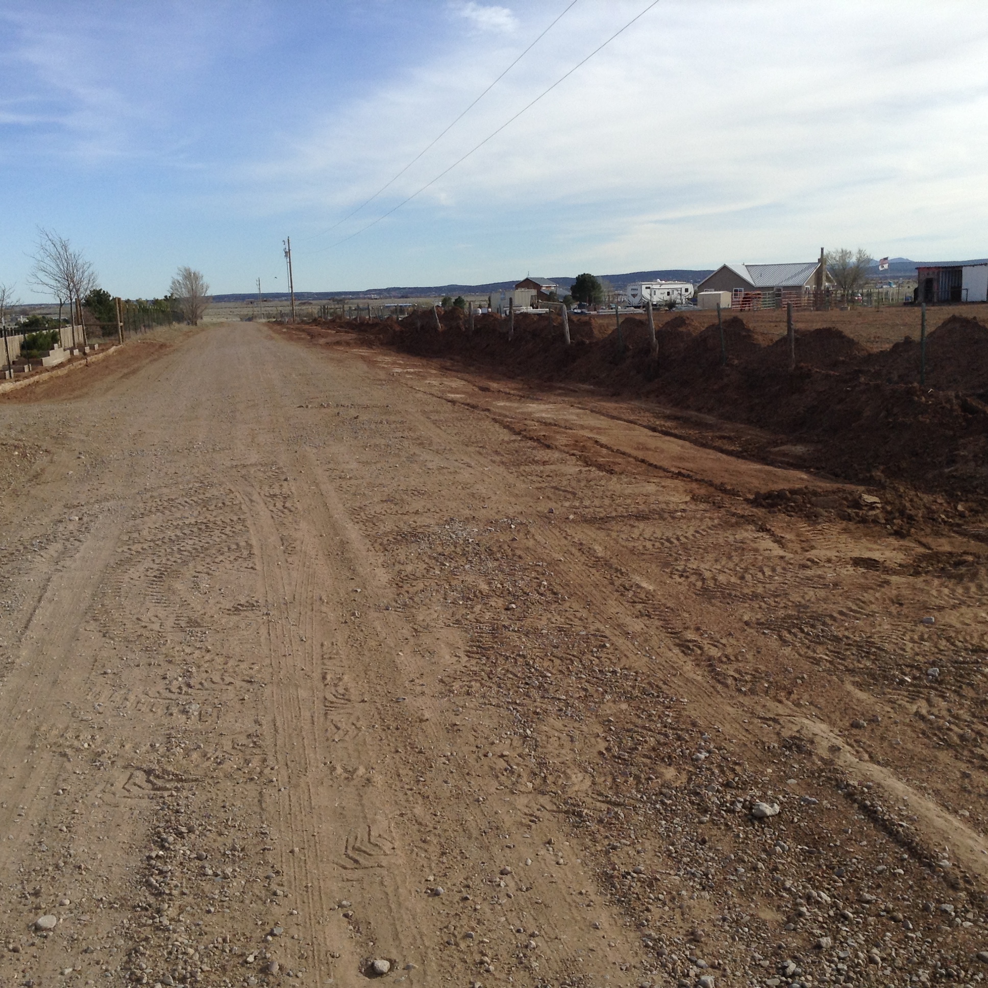

To give you an idea of work that a SCUT can do, here's a few pics of my current project. image.jpegimage.jpegimage.jpegimage.jpegThis is a section of road that was literally mud. The dirt blew so hard from a bare field across from us, it created a dirt berm 8' wide, anywhere from 2-3' deep, and about 5-600' long. I regraded the road using a boxblade, scarifiers down about 4". Then started digging out the berm to get back our drainage ditches. The dirt is getting piled up on the other side of the fence, to be removed / spead by the other new homeowner. Who says a SCUT doesn't kick some butt! Spent a total of 4 hours on the road, 3 hours on the dirt so far....

To give you an idea of work that a SCUT can do, here's a few pics of my current project. View attachment 599574View attachment 599575View attachment 599576View attachment 599577This is a section of road that was literally mud. The dirt blew so hard from a bare field across from us, it created a dirt berm 8' wide, anywhere from 2-3' deep, and about 5-600' long. I regraded the road using a boxblade, scarifiers down about 4". Then started digging out the berm to get back our drainage ditches. The dirt is getting piled up on the other side of the fence, to be removed / spead by the other new homeowner. Who says a SCUT doesn't kick some butt! Spent a total of 4 hours on the road, 3 hours on the dirt so far....
That just goes to show ya I guess..... nice...
I read your septic project too. ...See I also have a septic...it's 20 years old.... What about when that needs new piping d-box etc.... Why can't I do that myself? this is why having one of these tractors is such a bonus. I say this because others are recommending renting ditch diggers. I respect their opinion, I'm just not sure it fits in with my personality. But to be honest I'm still not sure?
