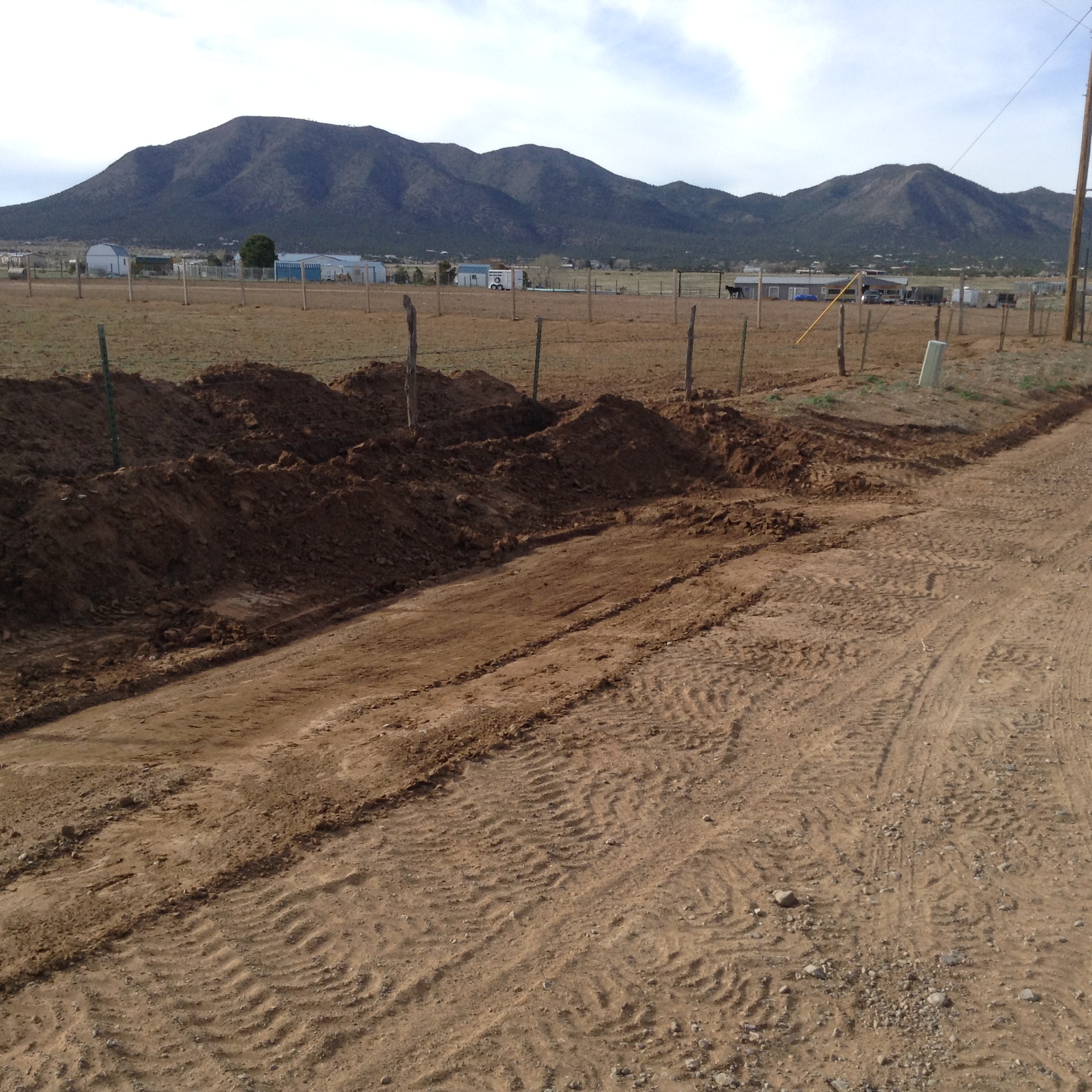

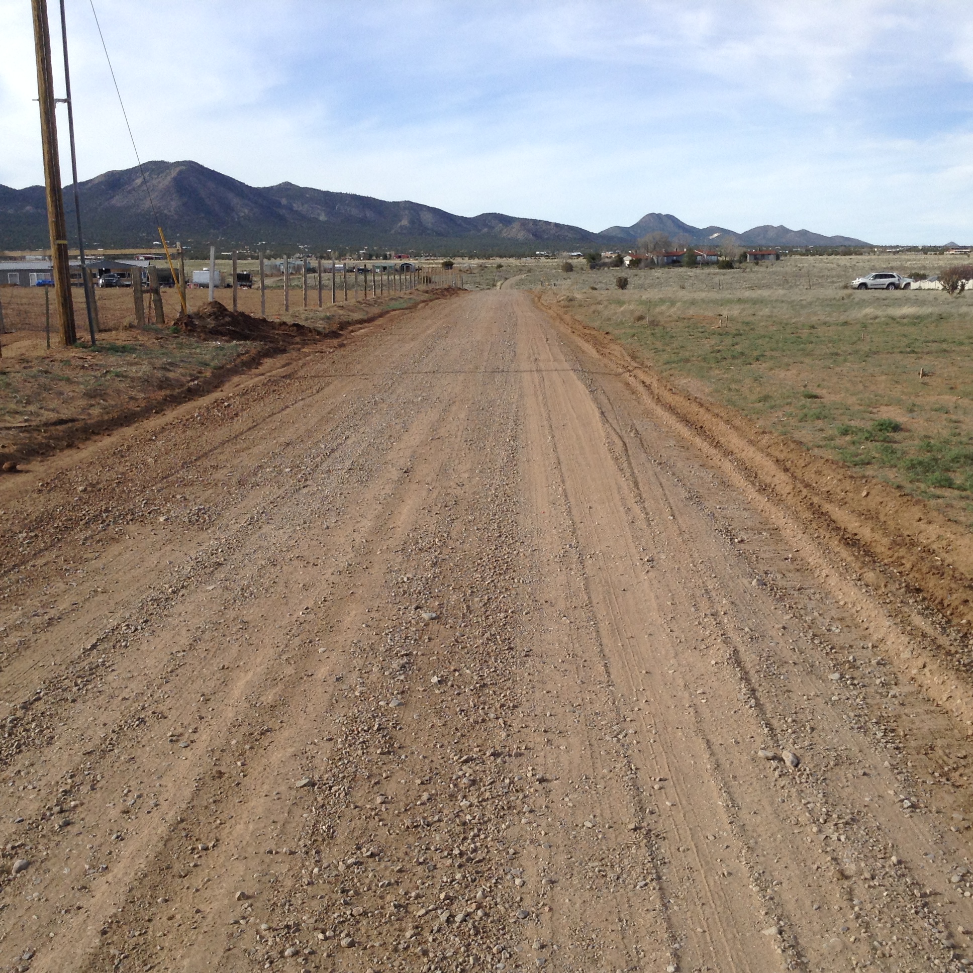

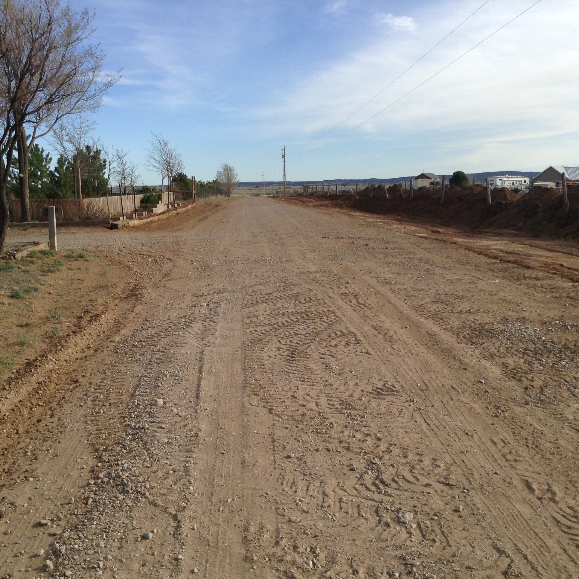

Our drive area (coming off the gravel common private road) is about 400' long, 20' wide for about 150', then up to 40' wide (turn around and parking). I put it in 25 years ago and have never regraded it or had to add stone. It was cut down 12" deep, 6-8 inches of 3-4" rock placed, then 2" of 1 1/2" crusher run. On top, 2" of crusher fines (1/4" to powder). It hardened like concrete. Kids rode bikes all the time and could actually roller-blade on it. It is now finally needing to have some more crusher fines on it after 25 years. I'll maybe do an inch or two at most. Being our drive, not a whole lot of traffic, but a couple of cars in and out a couple times a day.....
It's all in the prep eh! that's impressive.......... love top see a pic of that.....
With that said, as cheap as stone is, that recycled asphalt is about 40% of the cost. So not sure if that option was available to you when you did your driveway or not? Would you have considered that option now? if so .... do you think you would have wanted it as the base or top layer?
It's dark now, but I'll get a pic tomorrow if I remember..... The recycled asphalt has become available here in the last couple of years. I was thinking about using it to "top dress" the private road and drive, but went to look at another property that did it a couple of years ago. It's a mess right now....big chunks, big potholes... Don't know what is under it though. Looking at it made my decision. The supplier also sells crushed concrete for the same price...much easier to work with.
I still haven't decided to go even the crushed concrete though. It's much larger pieces, up to 1". Might go with it for the road, but definitely not on the drive. The crusher fines are only a little bit more (maybe $100) for the amount I would need for the drive.
If I was starting from scratch, I would definitely use the asphalt for the base, but still top with a layer of 1" crushed(with fines) and crusher fines for the finish.
